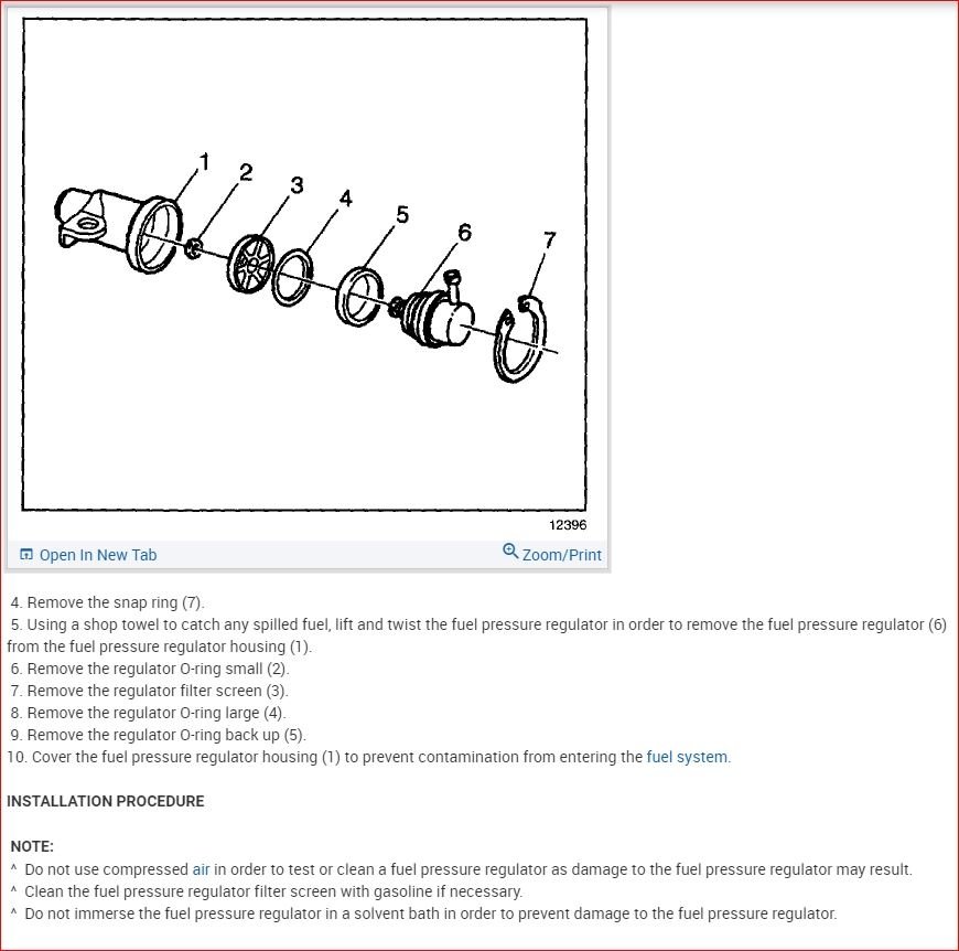

We have changed all plugs and wires, ignition coils (and all wires are ran correctly), and added treatment to the fuel to clean the injectors. It is still misfiring. Symptoms are rough idle and occasional stalling when put in gear, slow acceleration, and engine running loud and rough (which is not usual for the vehicle). What are we missing?

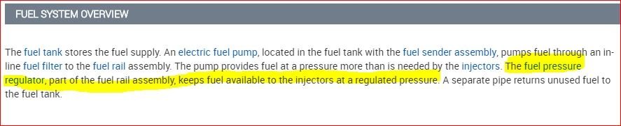

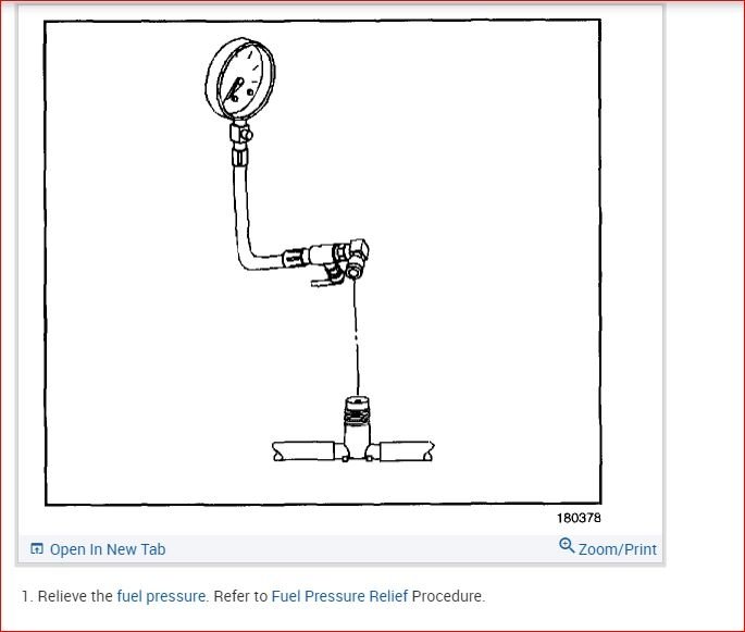

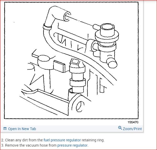

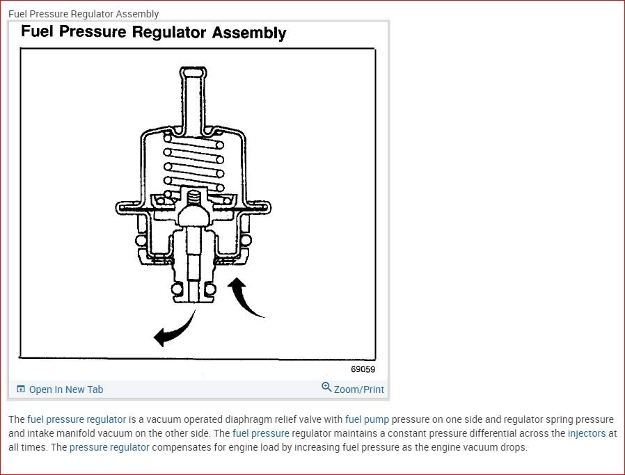

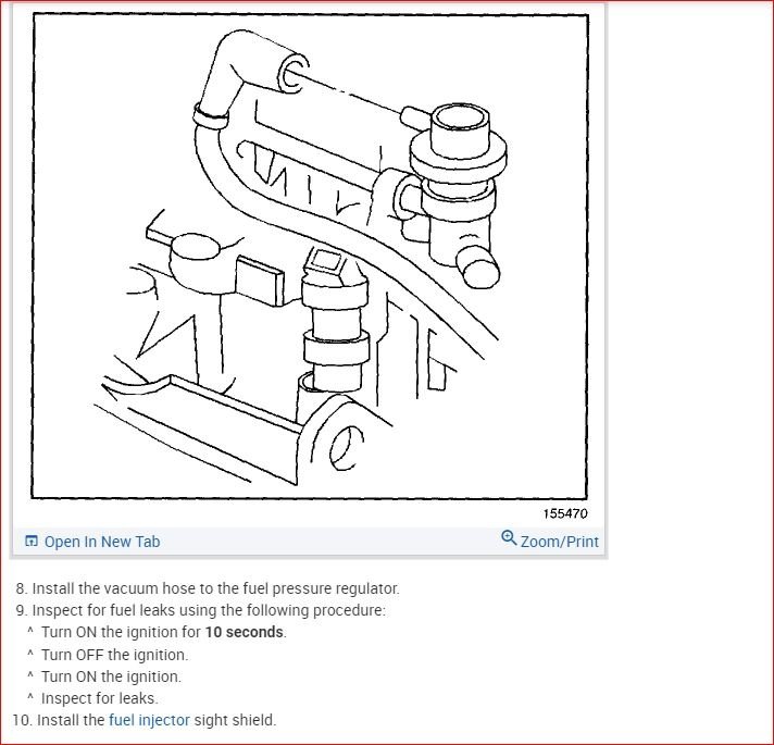

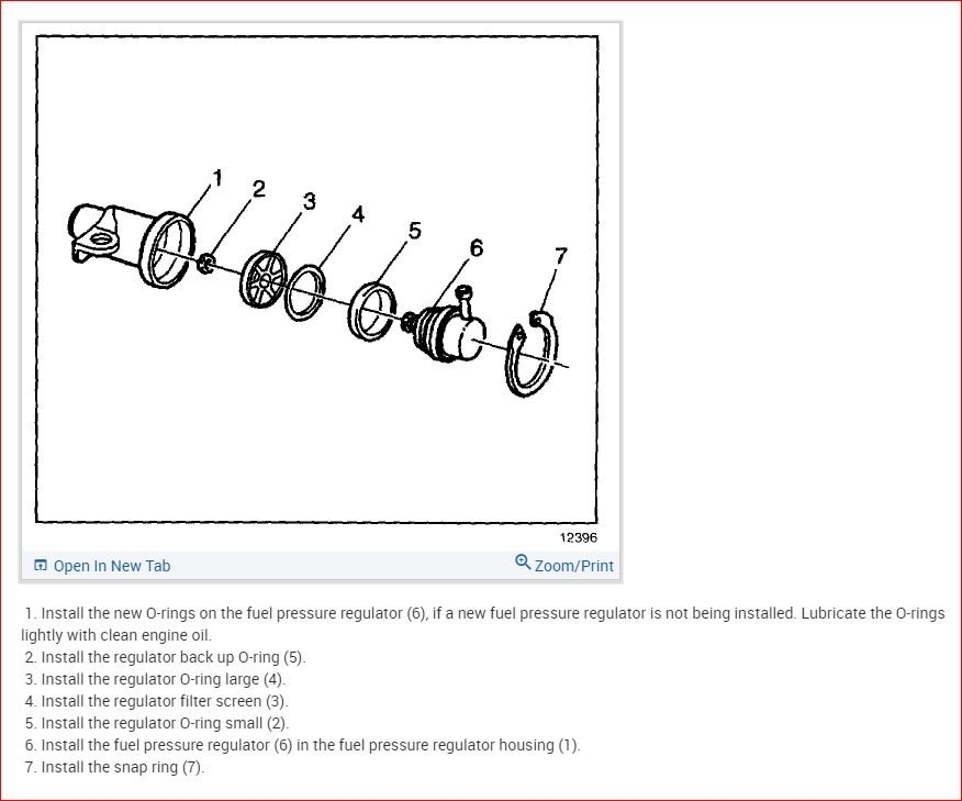

Hi Mommabear,
Have you checked you actual fuel pressure? Two things come to mind with the fuel, first you have low fuel pressure from the pump. You test this by putting a fuel gauge on the rail and see what the pressure actually is. Second, your fuel pressure regulator is faulty and your fuel volume being delivered to the injectors is not sufficient.
Next is unmetered air is coming into the cylinders. This means you have an air leak past the MAF sensor.
The way to determine which of these it could be is to monitor the o2 sensor data and see what vehicle is actually doing. Is rich or lean. I am going to guess it is lean but remember this P0300 means that different cylinders are misfiring at different times. So it is something that effects all cylinders and not just one. That means most likely it is either air or fuel.

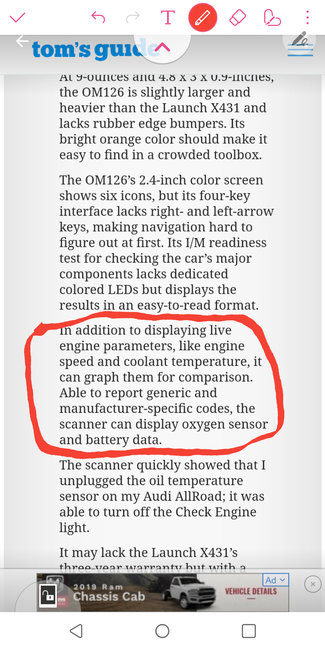

Okay. Thanks for explaining that for me! I am not that great with car lingo. So, this may be another stupid question, but a scan tool, is that like the code reader AutoZone uses to read the fault codes when the engine light is on, or is there a different one?
May 16, 2019 at 8:32 AM
MOMMABEAR34
  • 8 POSTS
Are you talking about an OBD scanner?
May 16, 2019 at 8:36 AM
Yes. OBD scanners but just be careful because some only read codes and do not let you monitor live data.
Someone actual just reported that the Autel AL329 from Walmart was not bad and pretty cheap for what you can do.
I am not recommending this but just make sure if you are going to look into buying one that it not only reads codes but can look at freeze frame data and live data.
May 16, 2019 at 8:40 AM

MOMMABEAR34
  • 8 POSTS
I circled what I am thinking would be what we would need it to do. Is that correct? It is a Autophix Code Reader OM126.
May 16, 2019 at 9:18 AM
The one I mentioned is about $50.00. They range from about fifty dollars to hundreds or thousands. Clearly, you don't need the higher priced ones if you are just looking to read sensors and stuff.
If you get one, just start with sending me the short term fuel trim for both bank 1 and 2 and we can go from there. Thanks
