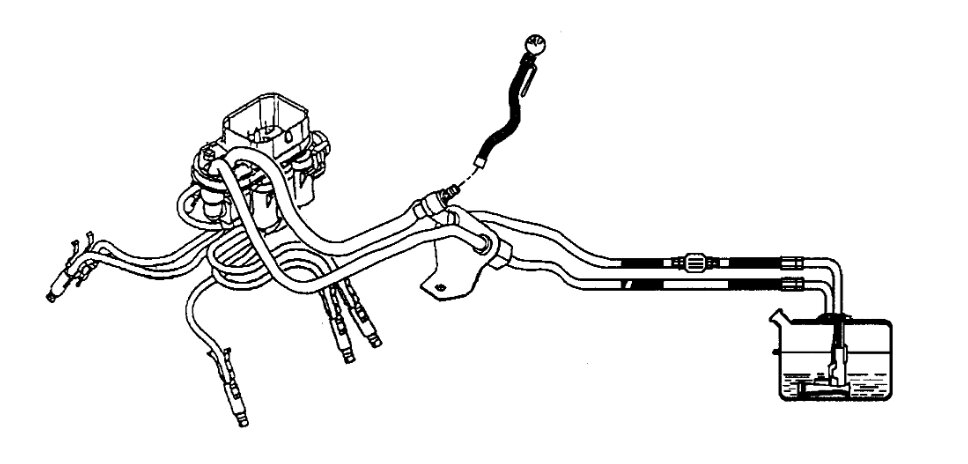

It can be a few things. For example, if the engine has 211K miles, it could simple be low compression due to wear. On the other hand, you could have a faulty fuel pressure regulator that is allowing too much pressure to build and causing the engine to run rich along with other things such as an engine vacuum leak, catalytic converter issues, and so on.
So, I have a few questions. Is this the only code you found? If it is, have you checked for engine vacuum leaks? If not, here is a link that explains how that is done:

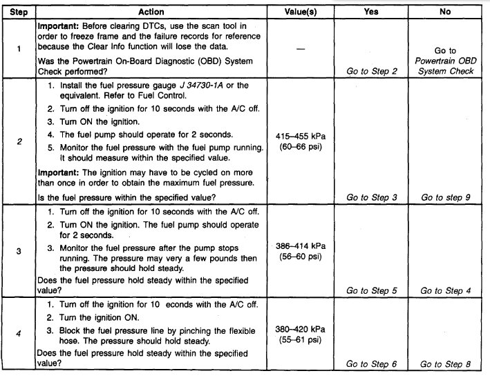

Next, it would be a good idea to check fuel pressure. Have you ever noticed any black or dark gray smoke from the exhaust? If so, that would indicate a rich fuel mixture., If not, here is a link that explains in general how to check fuel pressure:

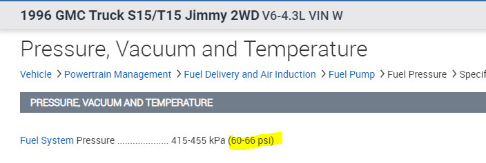

I attached the manufacturer's fuel pressure specifications below for you.
Also, if you have a live data scan tool, I need to know the short-term fuel trims as well as the engine coolant temperature sensor's temperature signal. Do this when the engine is cold.
See pic below.

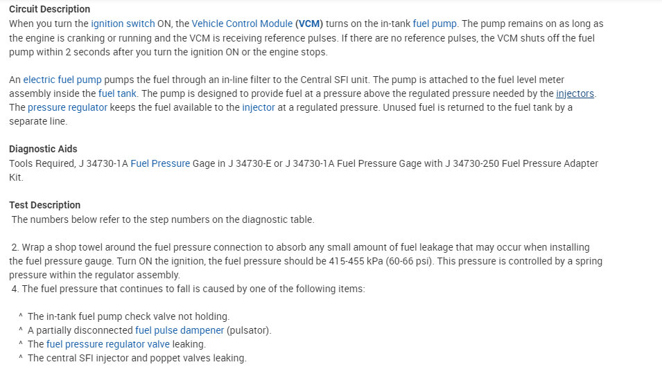

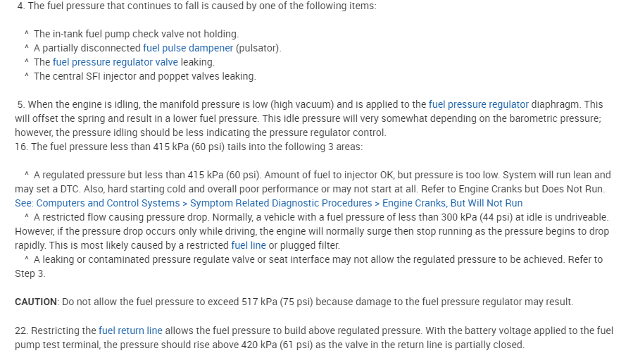

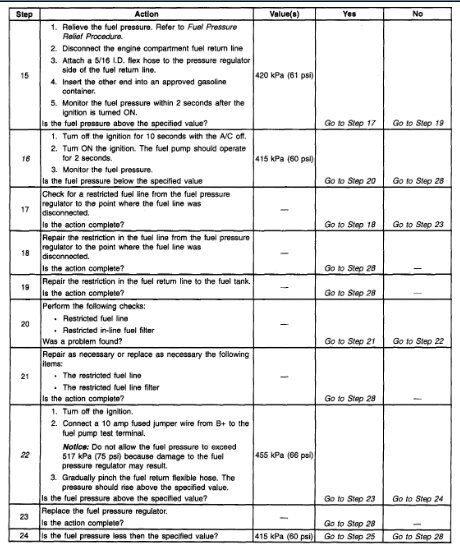

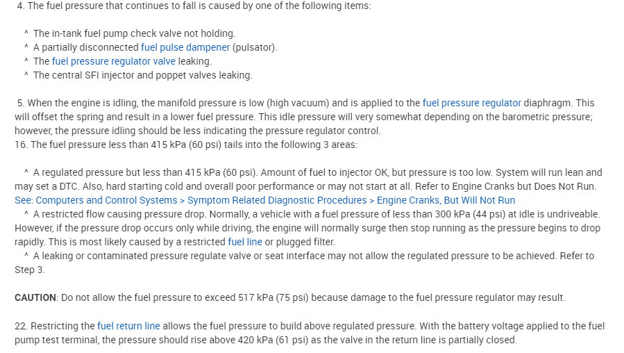

So, we checked fuel pressure, it’s supposed to be between 60 - 66 PSI and it was running at around 53 PSI and after letting it sit within 15 minutes it had dropped to 39 PSI. I have no external leaks that I can find, I’m leaning towards the regulator under the intake letting fuel leak into the back two cylinders.
Nov 19, 2022 at 1:40 AM
  • 110,244 POSTS
That is very possible. It could even be the pump is starting to fail or a restriction in the fuel line itself.

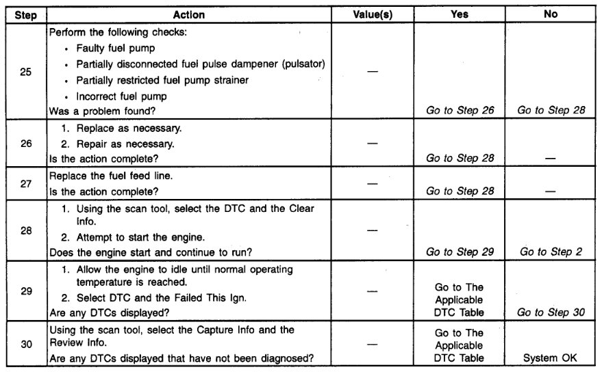

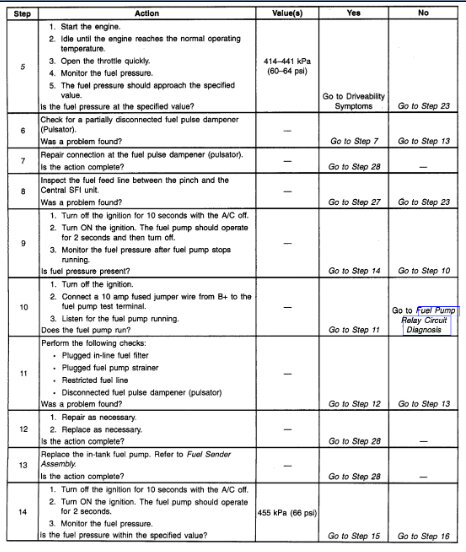

If you want to nail it down to the actual issue, I attached the diagnostics below which walks you through testing the regulator, pump, restriction, and nearly anything that can cause this.
Let me know if this helps or if you have questions.
