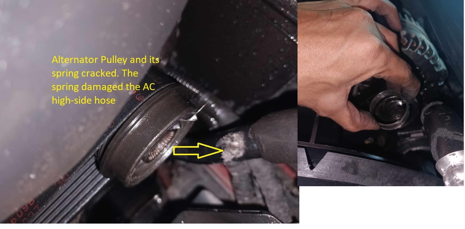

1. Two weeks ago my alternator pulley cracked , the spring inside the pulley 'flew' around the engine. Therefore causing multiple 'damages' to the aircon's high tube.
The following day, I had the pulley, high tube and freon topped up. Here's a picture of the damage before it was repaired.
Before the alternator was repaired, the battery were not charging.
