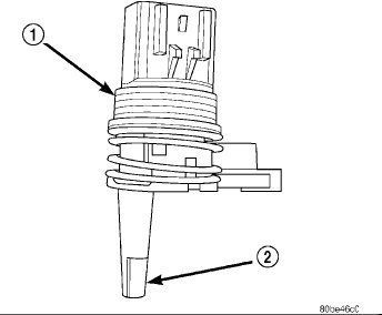

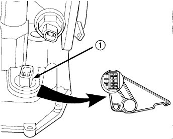

Keep in mind, it could be something as simple as the temperature switch. On this vehicle, the temp switch is integrated with the range sensor. Here are directions for checking and replacing:
TRANSMISSION RANGE SENSOR
DESCRIPTION
The Transmission Range Sensor (TRS) (1) is mounted to the top of the valve body inside the transaxle and can only be serviced by removing the valve body. The electrical connector extends through the transaxle case.
The Transmission Range Sensor (TRS) has four switch contacts that monitor shift lever position and send the information to the PCM/TCM.
The TRS (1)also has an integrated temperature sensor (thermistor) (2) that communicates transaxle temperature to the TCM and PCM.

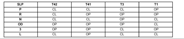

The Transmission Range Sensor (TRS) communicates shift lever position (SLP) to the PCM/TCM as a combination of open and closed switches. Each shift lever position has an assigned combination of switch states (open/closed) that the PCM/TCM receives from four sense circuits. The PCM/TCM interprets this information and determines the appropriate transaxle gear position and shift schedule.
Since there are four switches, there are 16 possible combinations of open and closed switches (codes). Seven of these codes are related to gear position and three are recognized as between gear codes. This results in six codes which should never occur. These are called invalid codes. An invalid code will result in a DTC, and the PCM/TCM will then determine the shift lever position based on pressure switch data. This allows reasonably normal transmission operation with a TRS failure.
TRS SWITCH STATES

See attached pics which correlate with these directions.
