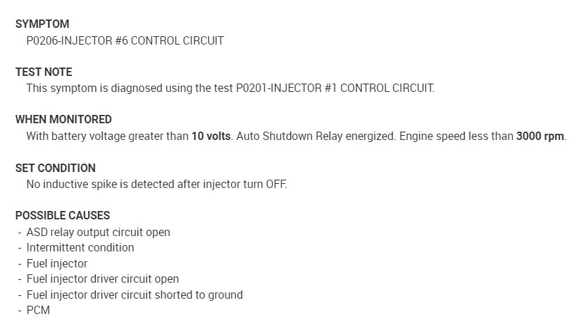

You indicated the injector passed the noid light test. That simply indicates power to the injector and that the PCM is providing a ground path. It doesn't indicate if the injector is working properly. It could be sticking open, staying open too long, and so on.

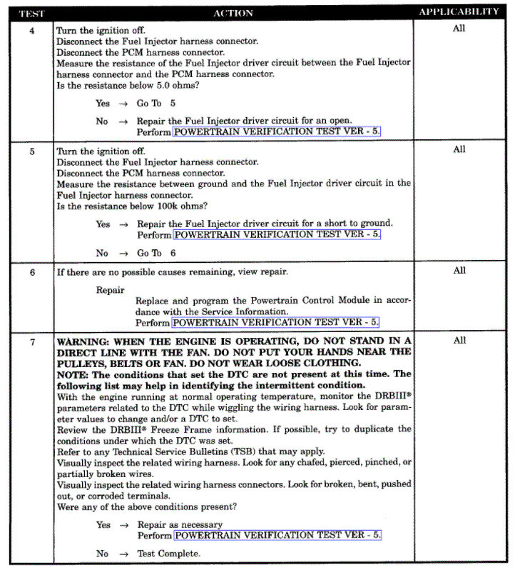

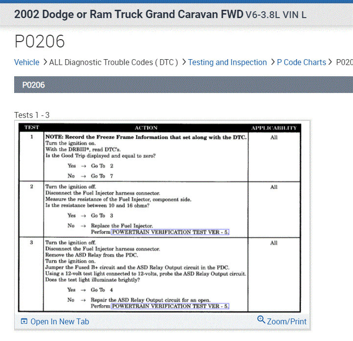

What you really should do is disconnect the cylinder 6 injector and test resistance between the two pins. It should be between 10 ohms and 16 ohms. If it falls outside of that range, replace it.
Now, I attached the diagnostics below for the P0206 code. Take a look through them and let me know if you are comfortable doing it.
Also, if you don't have a meter to test resistance, switch the number 6 injector with one from another cylinder and see if the code changes to the new cylinder.
Take a look at the diagnostics and let me know.
