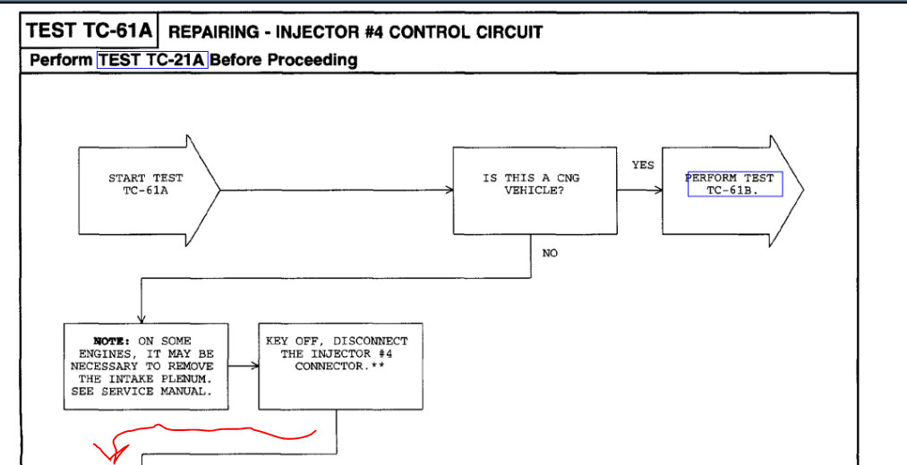

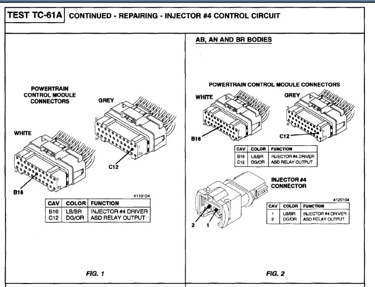

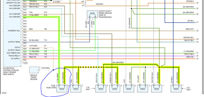

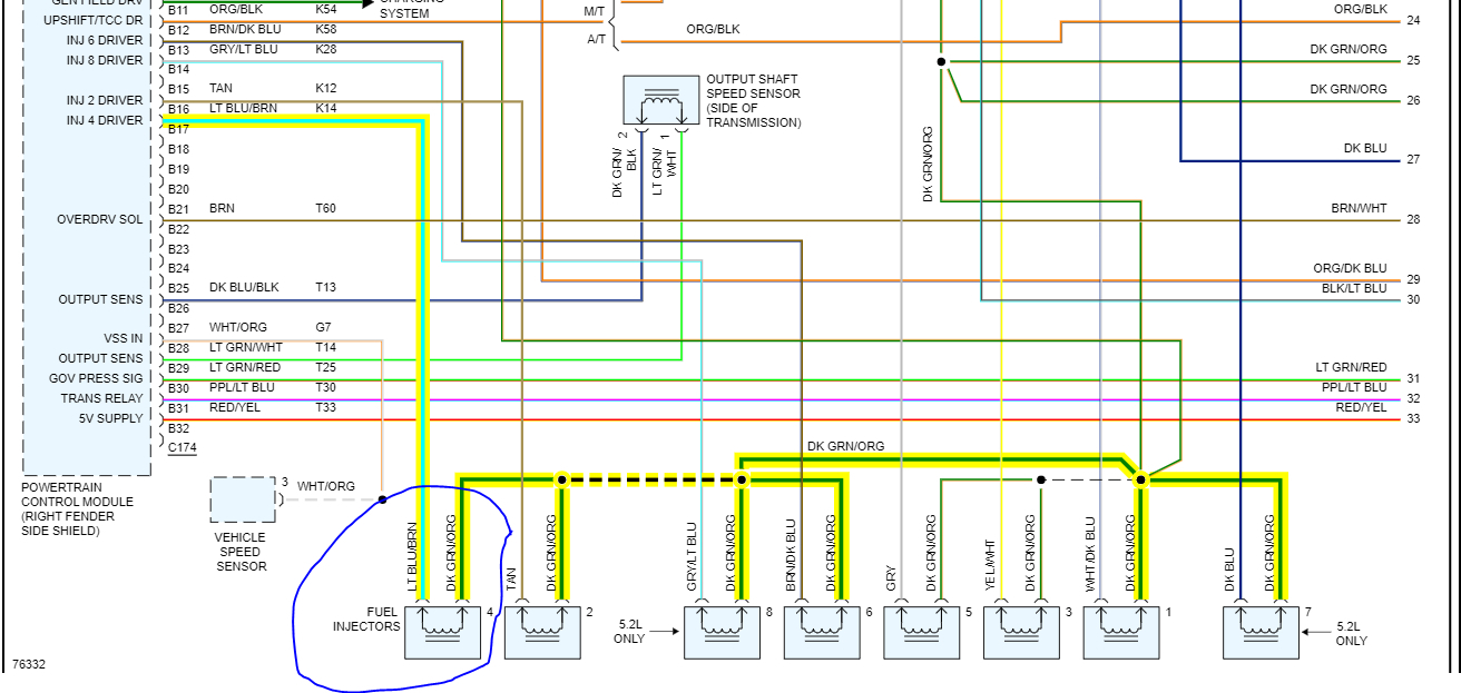

Are you getting power to the injector? You indicated there is continuity, but we need to confirm power. The injectors all get power from a common source and are spliced together. It isn't odd for a splice to fail.

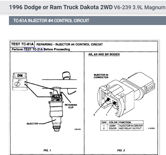

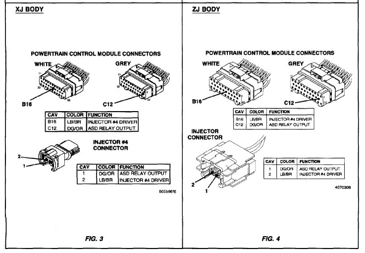

Each injector has a dark green wire with an orange tracer. (See pic below) With the key in the run position (Engine Off), each injector should have battery voltage at that wire. Please confirm.
If there is power, then we need to see if the PCM is providing a ground path to complete the circuit.
Here is what to do: Take a test lamp and attach the alligator clip to the battery positive. Probe the signal ground wire (light blue with a brown tracer) while you have a helper crank the engine. The test lamp should strobe on and off.
Let me know what you find.
See pic below.

Okay, with test lamp the green with orange wire has power with ignition in run position. Now with the ignition on but not running the light blue with brown pulses.
I tested another injector plug and it works as it's supposed to, green with orange wire has power with ignition in run position, the light blue with brown pulses when engine cranks.
I have traced the light blue w/ brown wire from injector to PCM and there are no breaks or shorts in the wire. So now I am really lost.

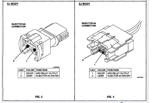

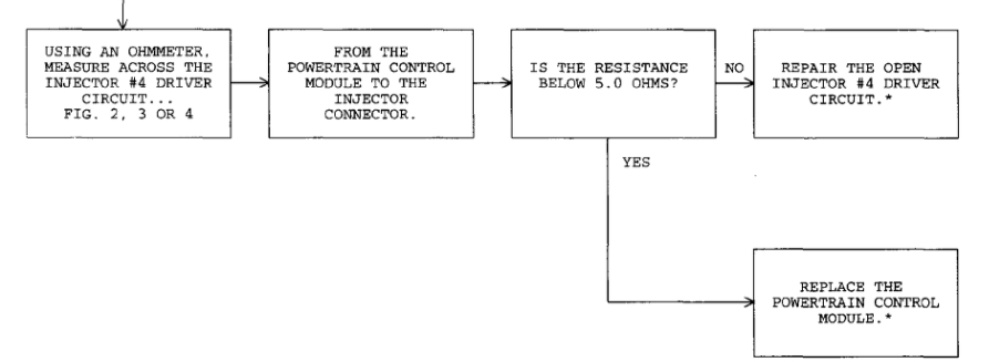

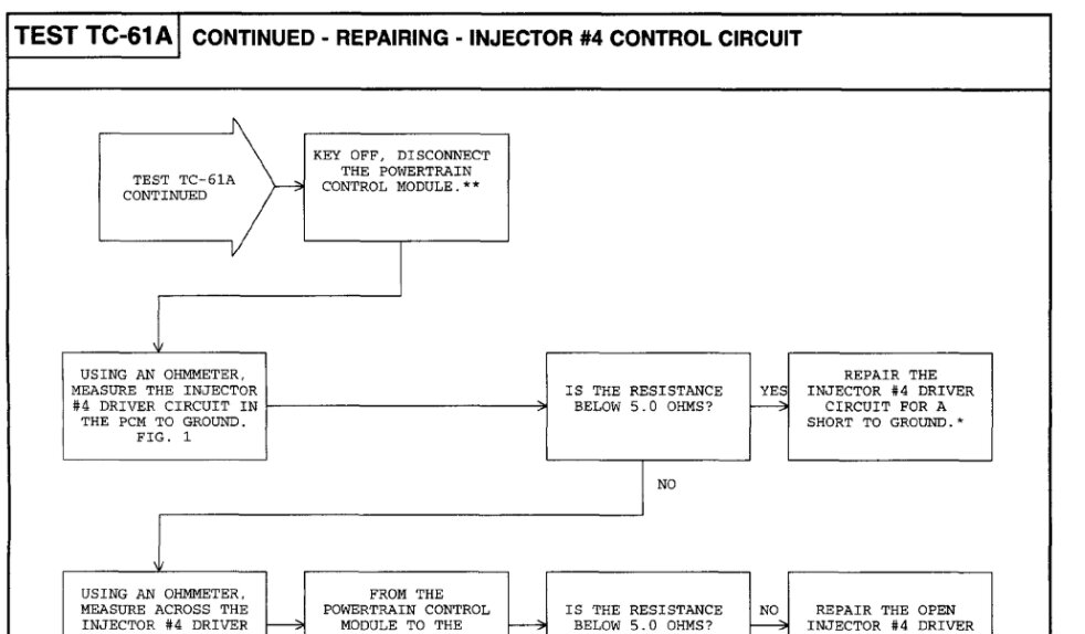

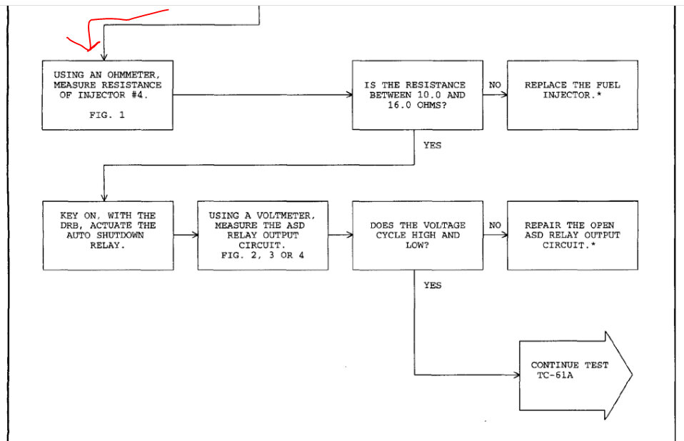

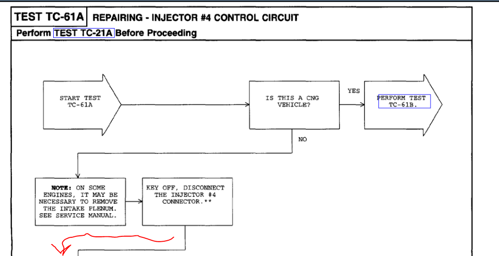

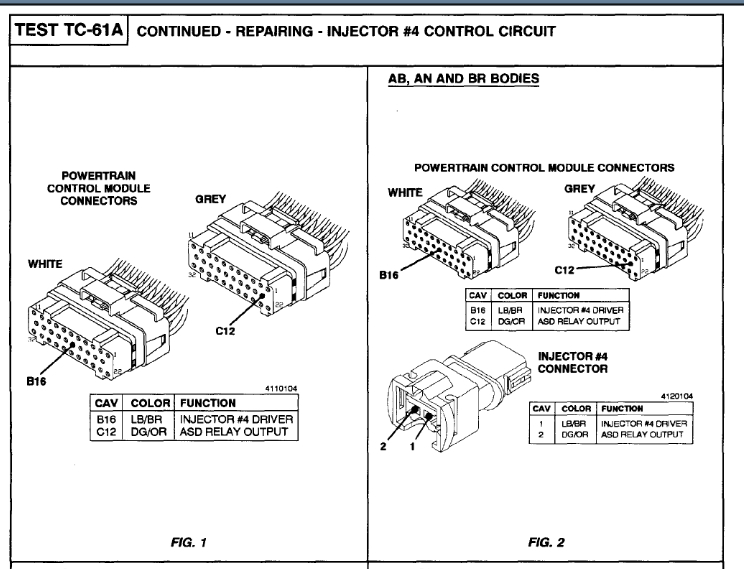

We must have an open circuit at some point. Do you feel the misfire? Also, take a look at the attached pics below. They are the diagnostics for this specific code and cyl-4.
Take a look and let me know if you are comfortable performing them.
