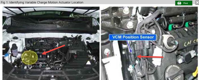

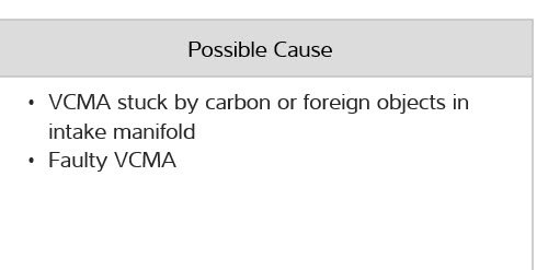

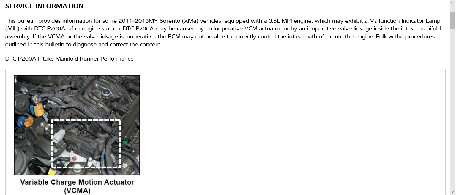

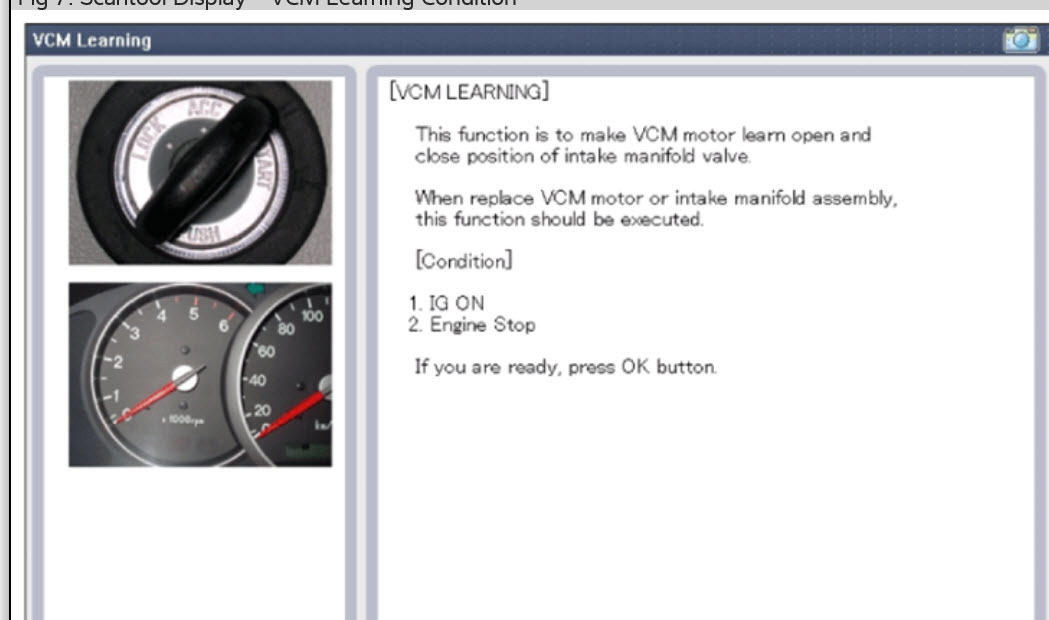

we don't list that code are you sure it's correct? auto parts can scan for free for correct code.we do list a p200a which you might want to check it's carbon in intake manifold. That may be the reason they are telling you it needs to be removed or replaced. after check for tsb's there is one on this and i'm sending a PARTIAL OF THE TSB in a pic. the rest of it must be done with a pro scanner. it may be linkage held up as well. also check the battery for condition including load test as this may be part of the cause if the valve is replaced there is a relearn procedure that a scanner must be used to relearn it
