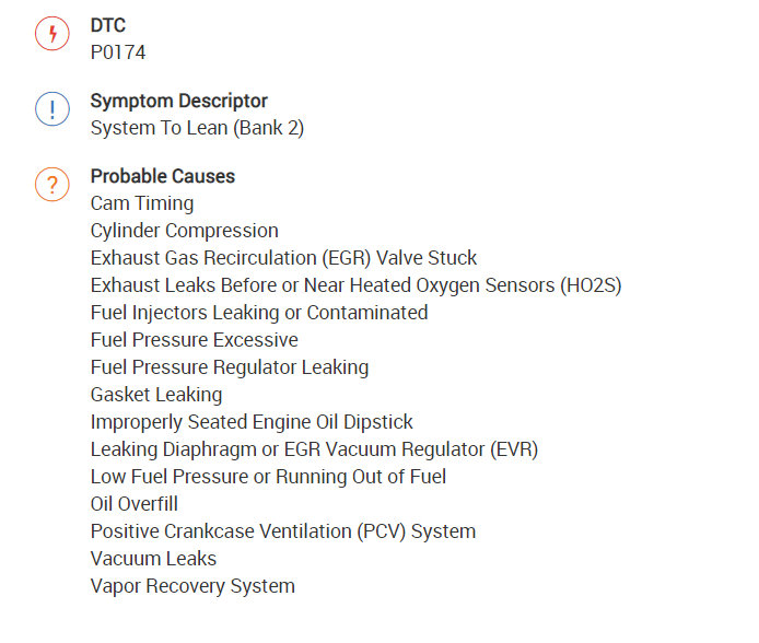

Good morning,
The 174 is a lean condition on bank 2.
https://www.2carpros.com/articles/repair-lean-mixture-codes-p0171-or-p0174-on-some-manufacturers

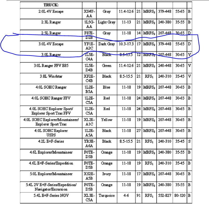

Very common failure for this is low fuel pressure. Test the pressure to be sure. I attached the pressure below.

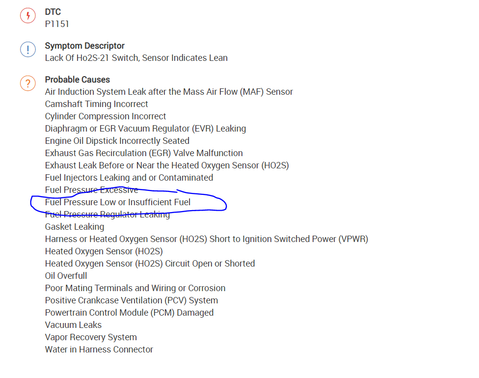

The 1151 is also for lack of fuel. The sensor is not switching from the lack of fuel.

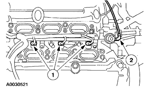

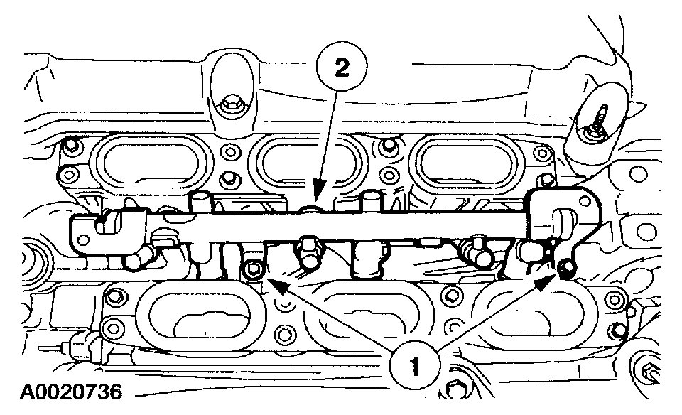

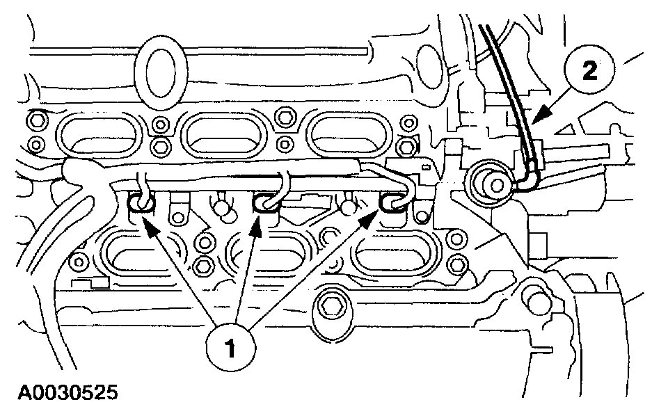

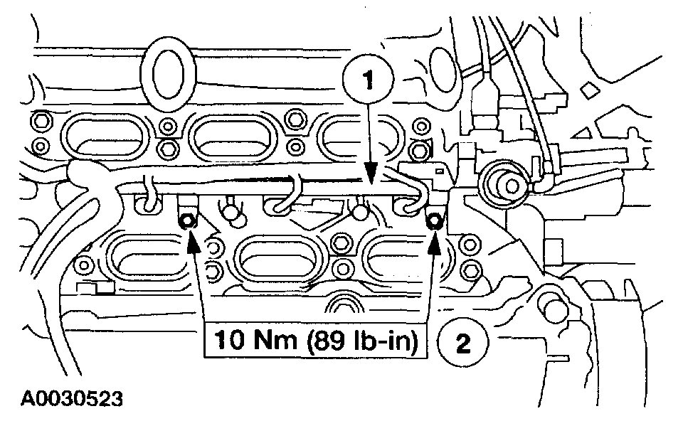

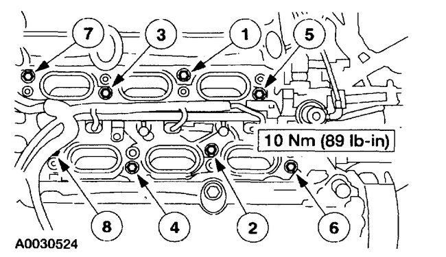

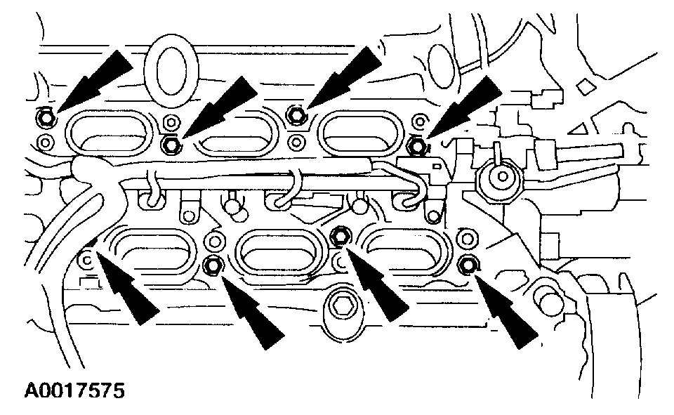

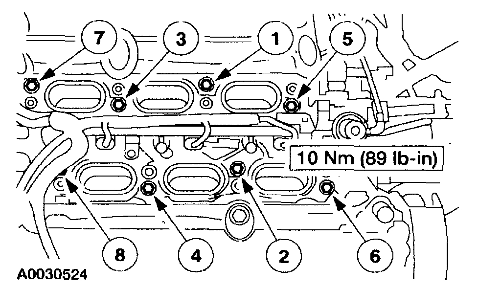

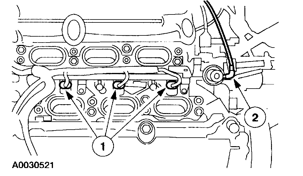

The intake gaskets on these are extremely common at my dealership. The easiest way to verify this is to pull up the o2s21 and o2s11 pids on your scanner, then while the engine is cold (first start) spray the lower intake area while looking at the voltage on your scan tool, if it spikes up when you spray, bobs your uncle=intake gaskets and you're done. Here are some images that should help you.

BMDOUBLE all of the upper and lower intake gaskets have been Changed prior to this issue .It was the first thing changed out when this problem started.
