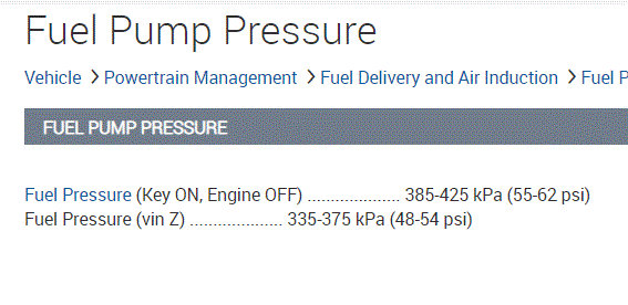

These two codes indicate an extremely rich fuel mixture. First, we need to check fuel pressure and the regulator. And yes, the rich fuel mixture will cause the P0300. The flashing engine light was indicating a misfire.
Here is a link that shows in general how to test fuel pressure:
Here are the manufacturer's specifications for fuel pressure.
Do this and let me know what you find. Also, let me know if you have a live data scan tool. If you do, let me know what the short-term fuel trims are.

I forgot to add the fuel pressure specifications. I did this time at the bottom.
I hope this helps. Let me know the outcome.
See pic below.

The fuel pressure with key on engine off was 50 PSI key on engine on was 45 PSI when snapping throttle psi went to 50 under load pressure stayed around 45. The freeze frame from when the code was set the stft bank 1 was -5.5 stft bank 2 was -11.7.
May 31, 2021 at 12:17 AM
  • 110,248 POSTS
The pressure sounds good. The trims indicate a rich fuel mixture. I'm wondering if there is a fuel injector or injectors leaking. When you checked fuel pressure (engine off), what happened to the fuel pressure when you turned off the key? Did it hold or did it drop somewhat quickly? Is the air filter in good condition and nothing blocking the air inlet?

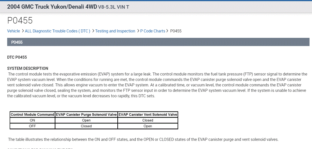

  • 110,248 POSTS

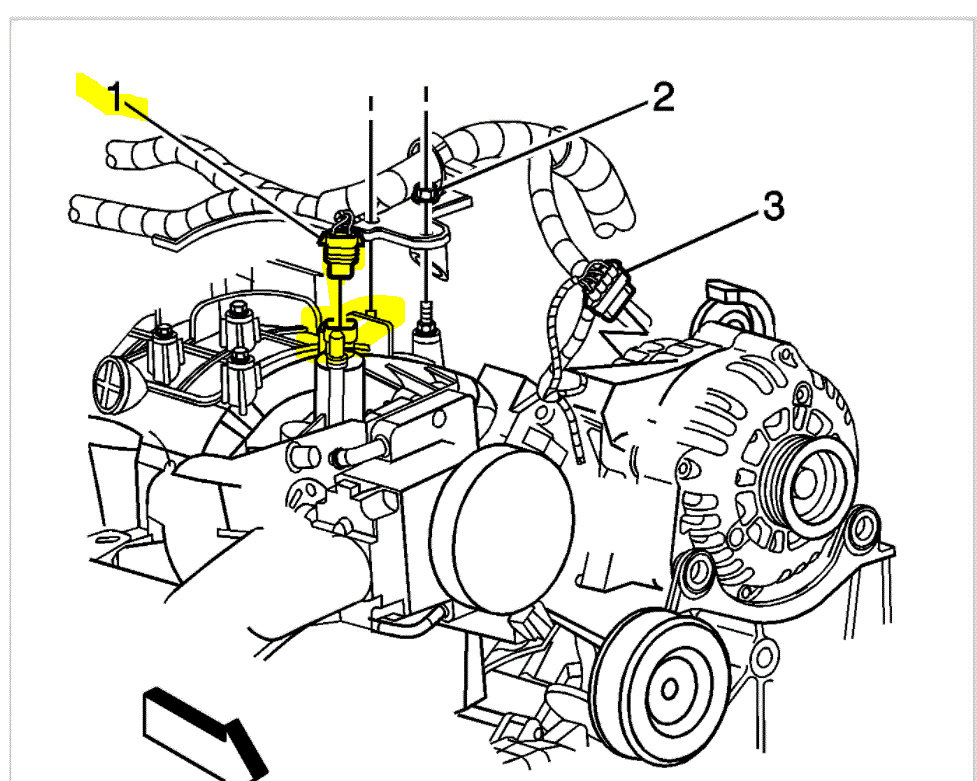

That code indicates a large leak in the EVAP system. Code 455 can indicate the canister purge valve is stuck open. This could draw fumes from the EVAP leading to a richer fuel mixture.
Do me a favor. The solenoid is on the intake manifold. Confirm the connector is tight, the wiring is good, and let me know what you find.
I attached a pic below showing the location of the part.
Take care and let me know.
See pic below.

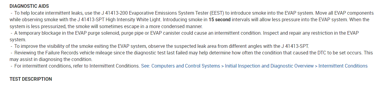

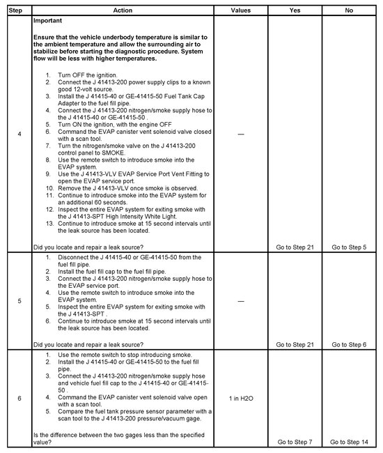

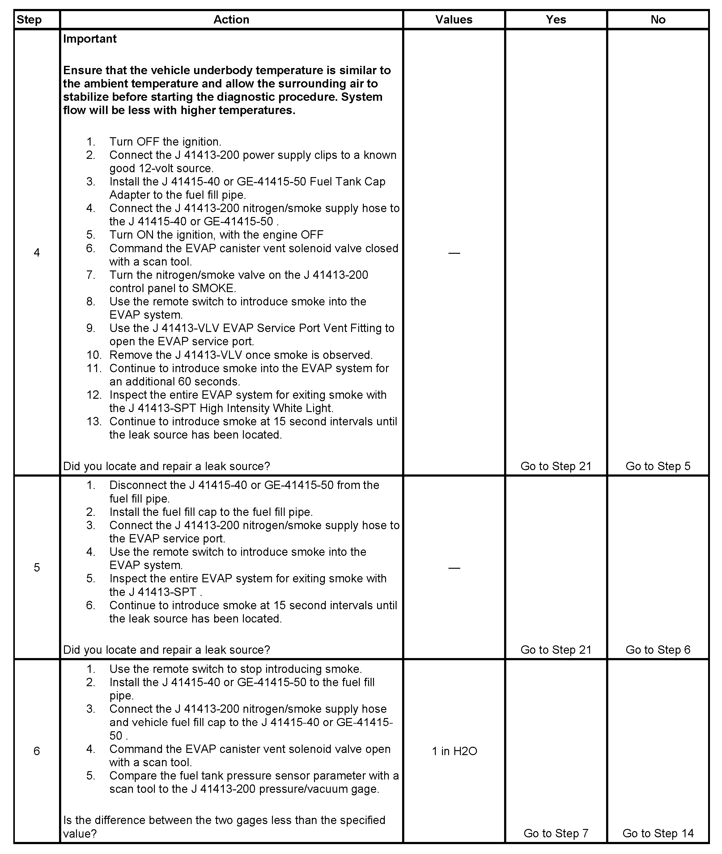

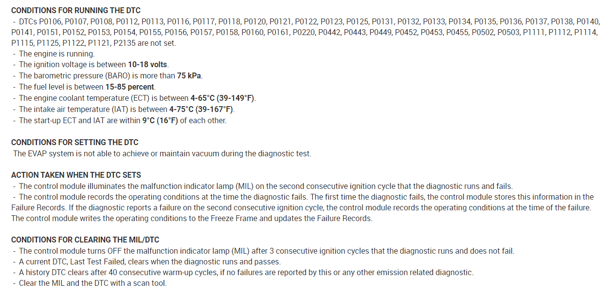

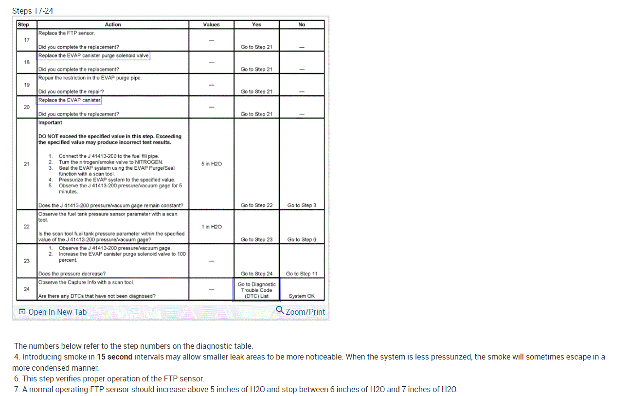

  • 110,248 POSTS

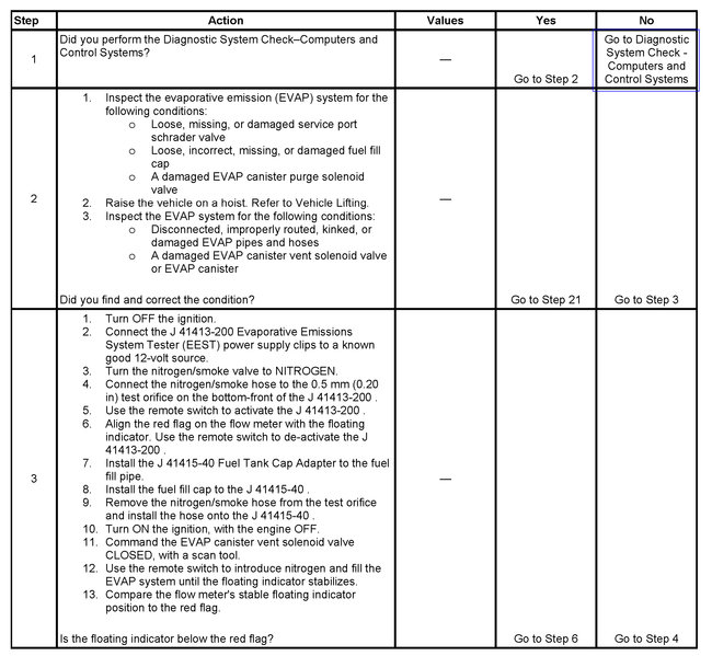

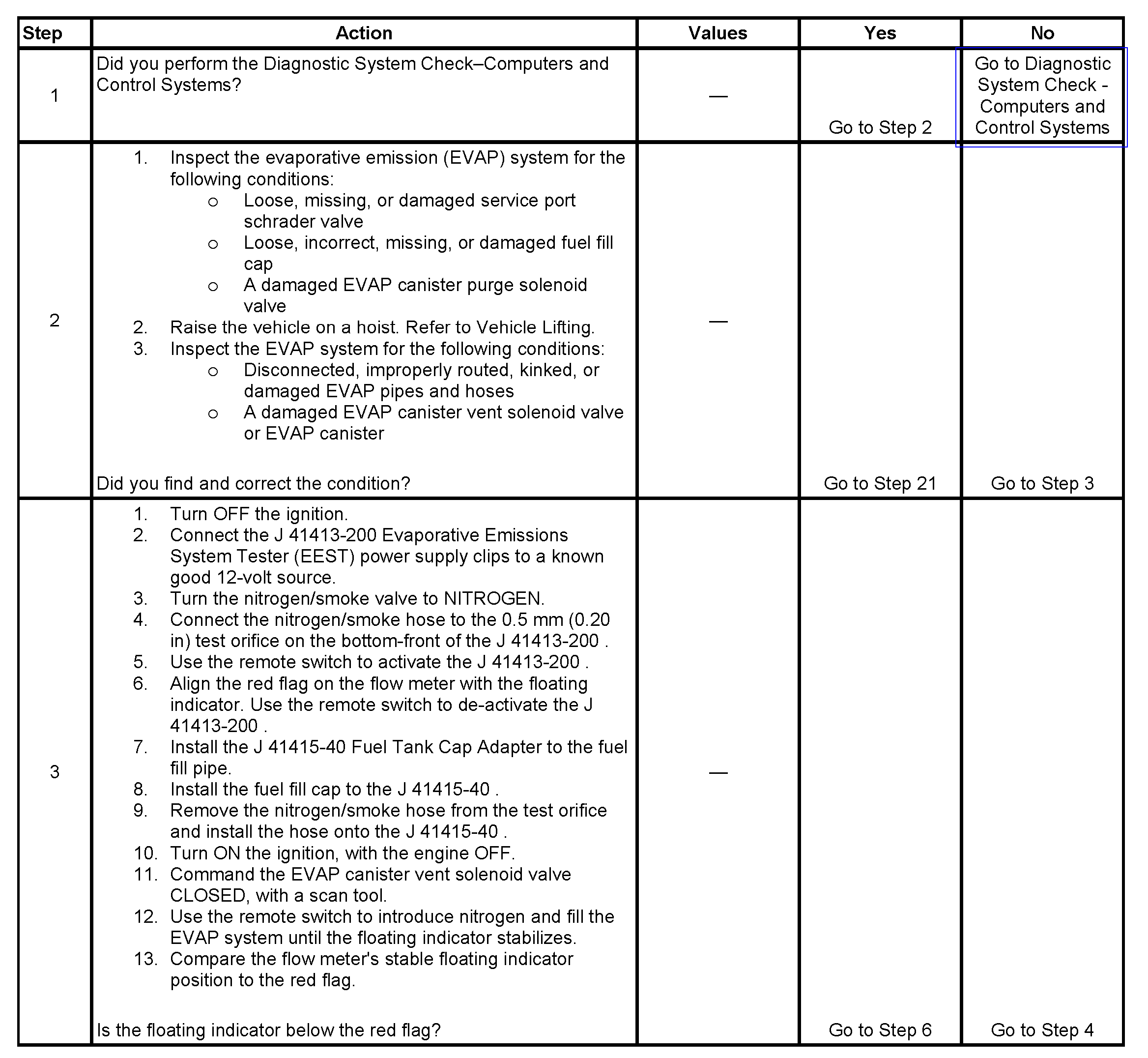

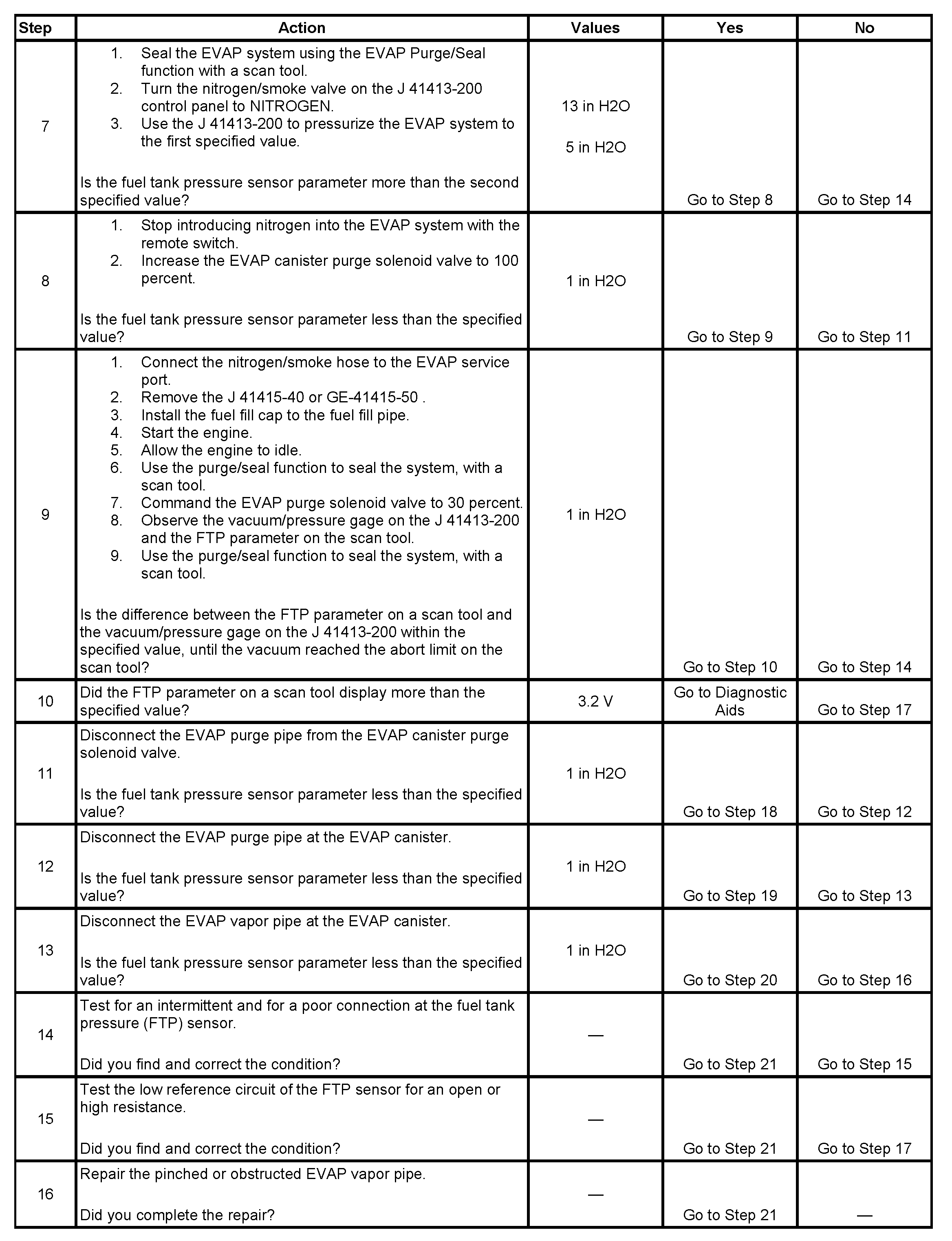

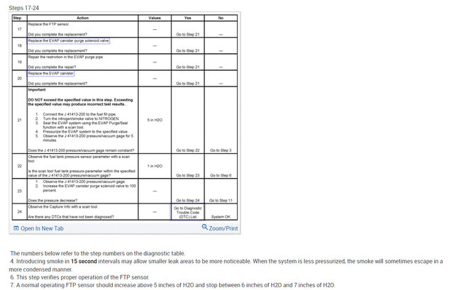

I don't want to arbitrarily replace it because it may not be the problem. I have attached the diagnostics below for checking the system, but it does require a scan tool that can communicate with the vehicle. This is the only way to be sure of the cause.
Take a look through the directions and let me know if it is something you feel comfortable performing it.
