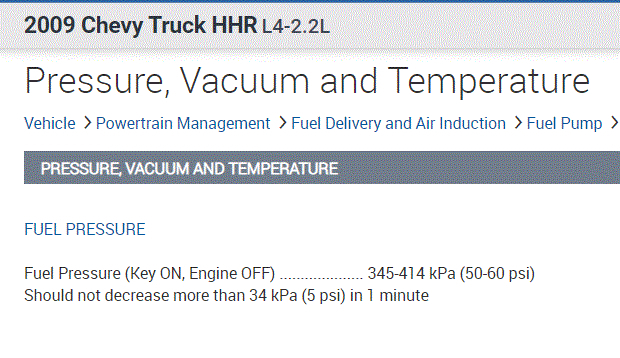

Got a system too rich bank 1 code. I changed the spark plugs and coil packs, changed the mass air flow sensor, changed MAP sensor, changed the 2 oxygen sensors, changed the fuel injectors, cleaned the throttle body. It still stutters and stalls out. I don't know how to perfectly do a vacuum leak test but I'm not even sure that's the problem, hence why I'm posting. Can you point me in the right direction?

Based on that code, you are getting too much fuel to the engine. In this case, it wouldn't be a vacuum leak. A vacuum leak would allow unmetered air to enter the engine and create a lean mixture. This code can be caused by several things. However, here is a link that shows how to test for a vacuum leak:
Have you checked fuel pressure? Is this the only code present? If you have a live data scan tool, could you let me know the short-term fuel trims?
Make sure there are no restrictions in the air intake tube/air filter box. Also, check fuel pressure. Here is a link that shows how it's done:
I attached the manufacturer's pressure specifications below. Do this and let me know what you find.
See pic below.
