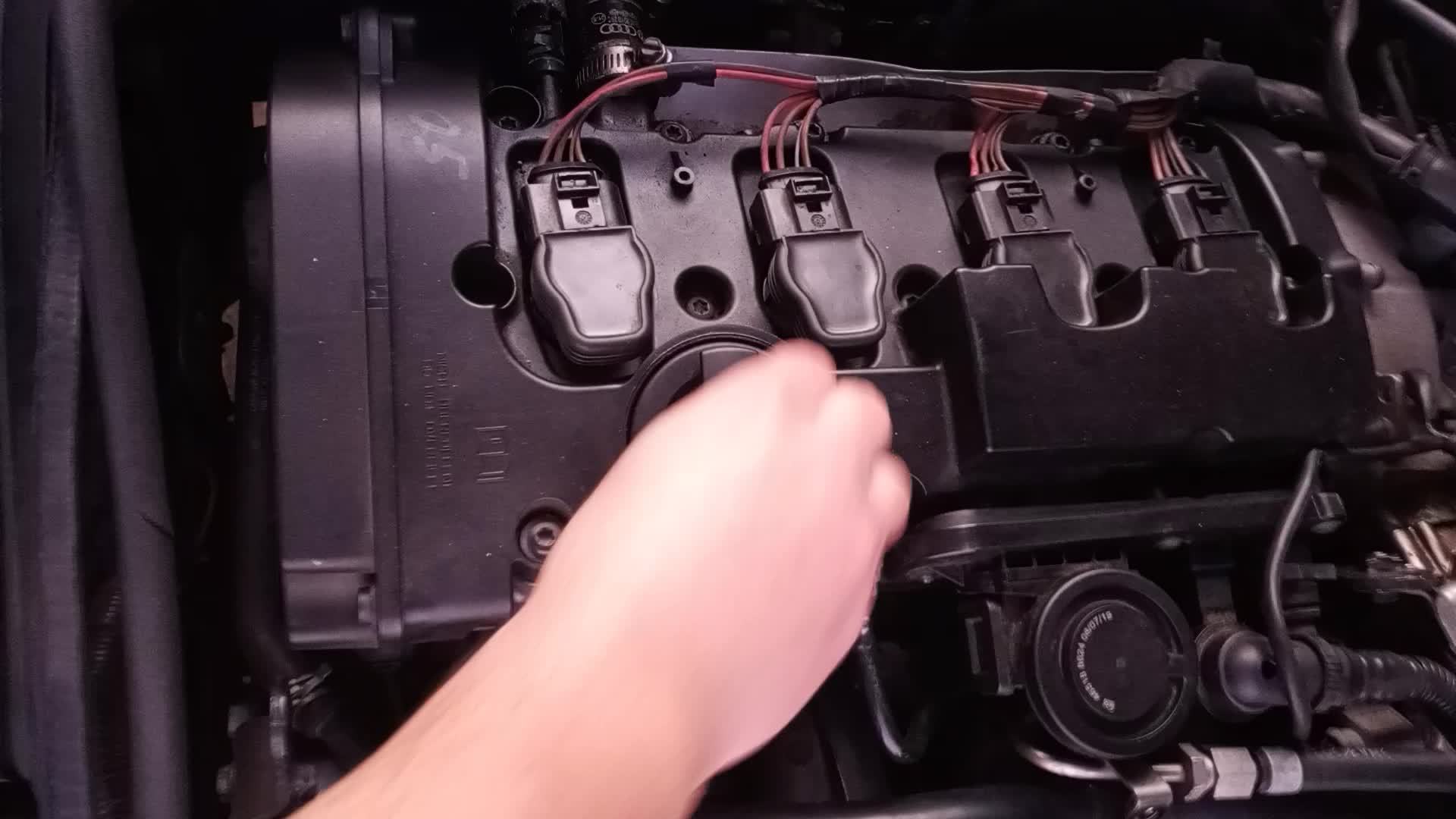

I have an issue finding the problem with my car listed above. I'm getting a P0171 code. Symptoms include hesitation and loss of power at acceleration from a stop and bad fuel mileage. Following are the repairs that I've tried: changing the fuel filter, PCV valve or (crankcase vent valve), EVAP purge valve, cam follower, new spark plugs, and MAF sensor. I've had this issue for over a year. Audi mechanics are scammers. Any help would be appreciated. Thanks in advance.

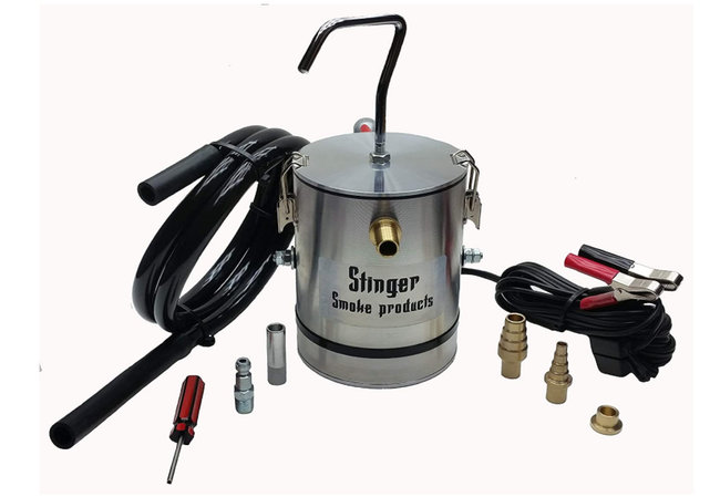

The first step would be to smoke test the intake and fuel tank EVAP system for leaks.
Smoke testing is a quick way to check if any of the intake or vacuum pipes have a potential air leak.
Small air leaks in either the intake or EVAP system can cause this code to set
Item like the EVAP lines from the fuel tank, activated charcoal filter or even the fuel filler cap can leak and could cause this code to set
Smoke testers are freely available online or even Amazon.
See picture below

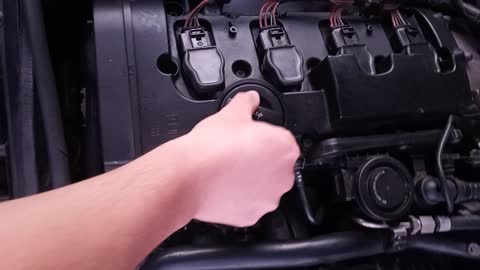

I did a test with the carburetor cleaner and couldn't muster anything, but when I removed the oil cap while the engine was running. I couldn't pull it completely out without the engine wanting to stall out, but I didn't feel vacuum when I removed the cap. Is that good or bad regarding the intake manifold gasket or the manifold entirely?

Removing the oil filler cap while the engine is running will cause this erratic idle behavior.
This is because you are introducing a huge amount of outside air into the crank case ventilation system which in turn will lean out the mixture in the intake system.
The only way to check if there is any crankcase vacuum is to use a vacuum tester and attach it to the crankcase ventilation system. I find the easiest place is at the dipstick tube. You could also attach a smoke tester to the dipstick tube to check for possible crankcase ventilation leaks.
With the vacuum gauge attached we should have a vacuum of around 15-40 mbar at idle.

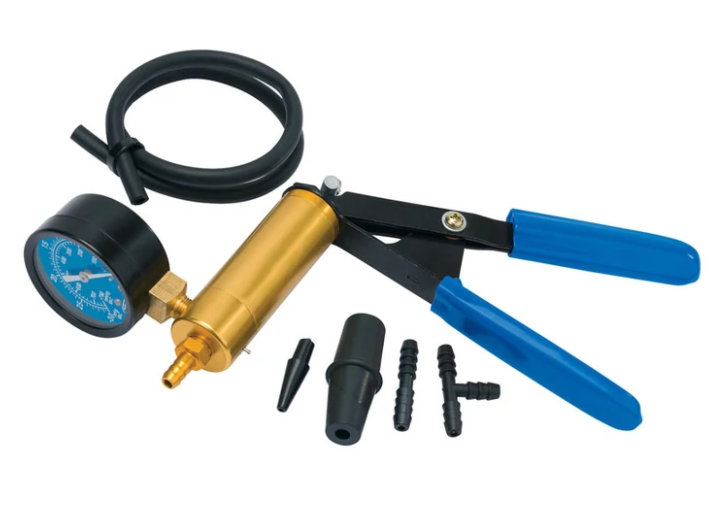

A handheld vacuum pump is the best way of diagnosing a vacuum system as you can read vacuum and also induce a vacuum to test lines, see picture below.

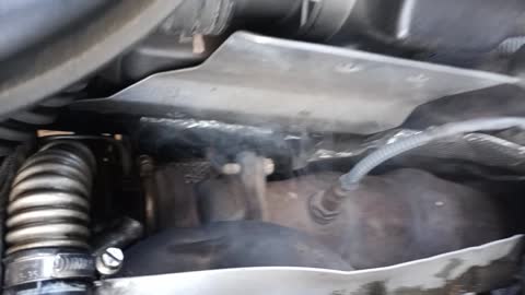

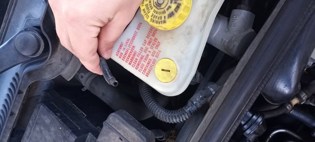

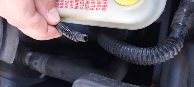

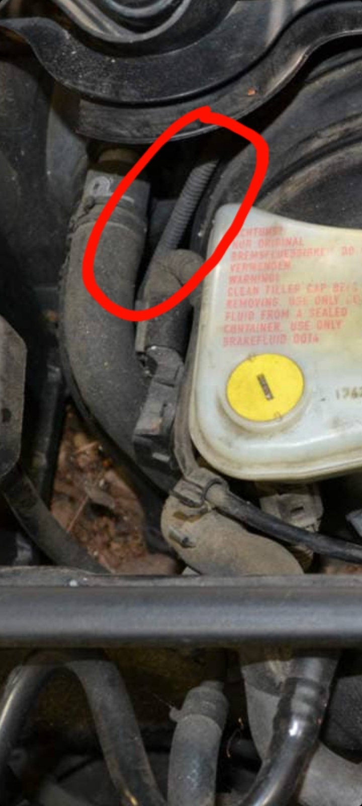

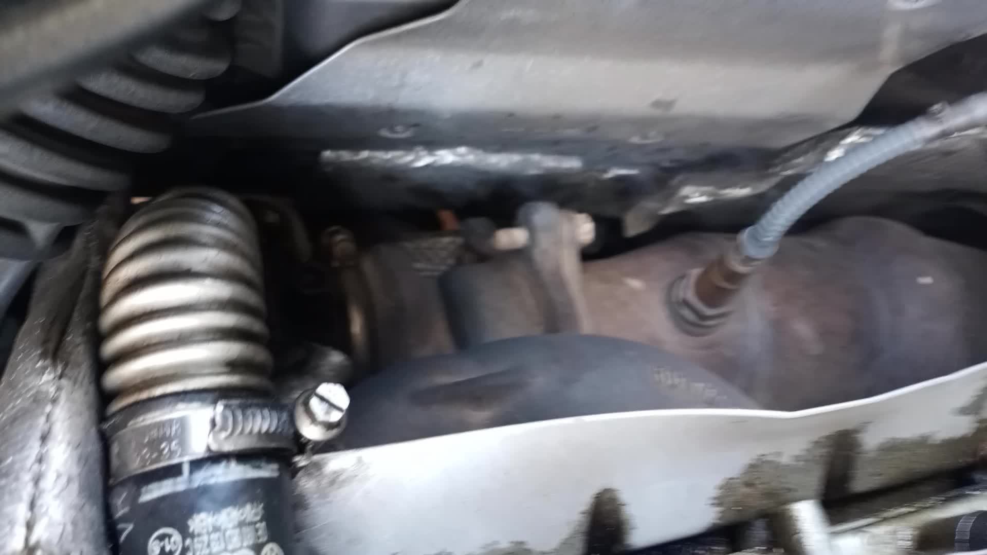

So, I used a smoker a friend made. I didn't see anything through the intake manifold or crankcase vent valve, but I ran the hose through the intake manifold and smoke came out through the side of the airbox (as seen on the video attached). Also found a rogue disconnected hose by the brake booster (see images attached). It was tucked in and hidden probably by the previous owner. Any clue on where it can possibly connect to or what the part is called? Thank you.

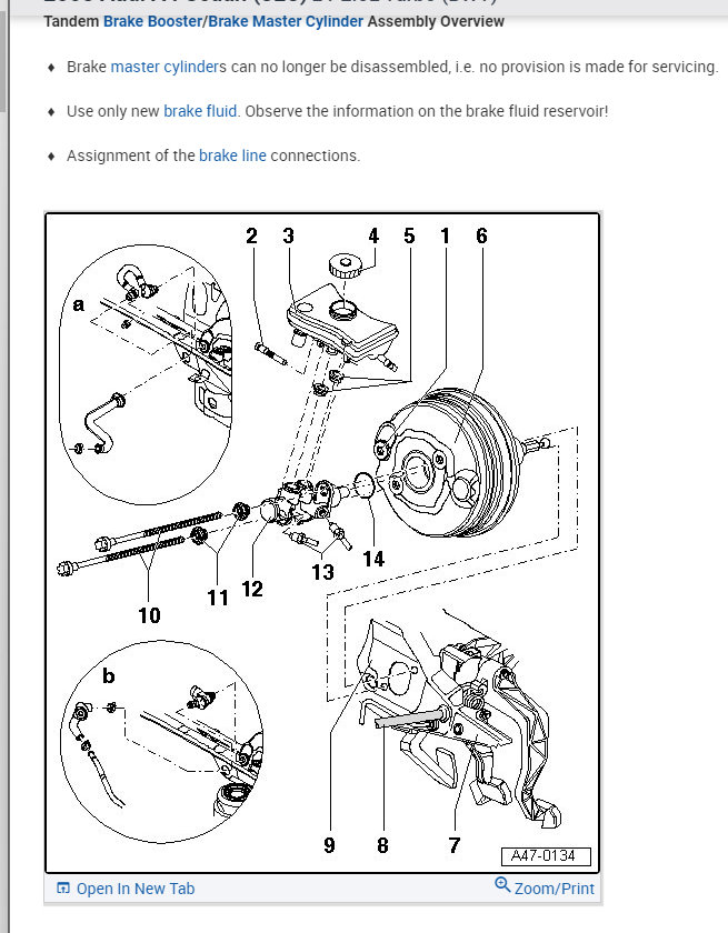

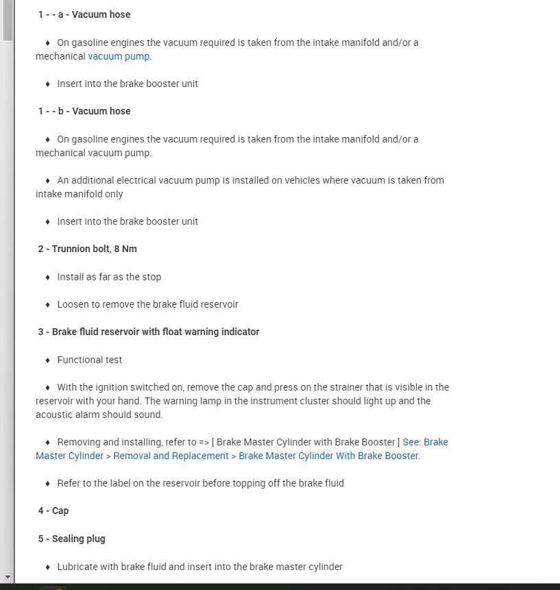

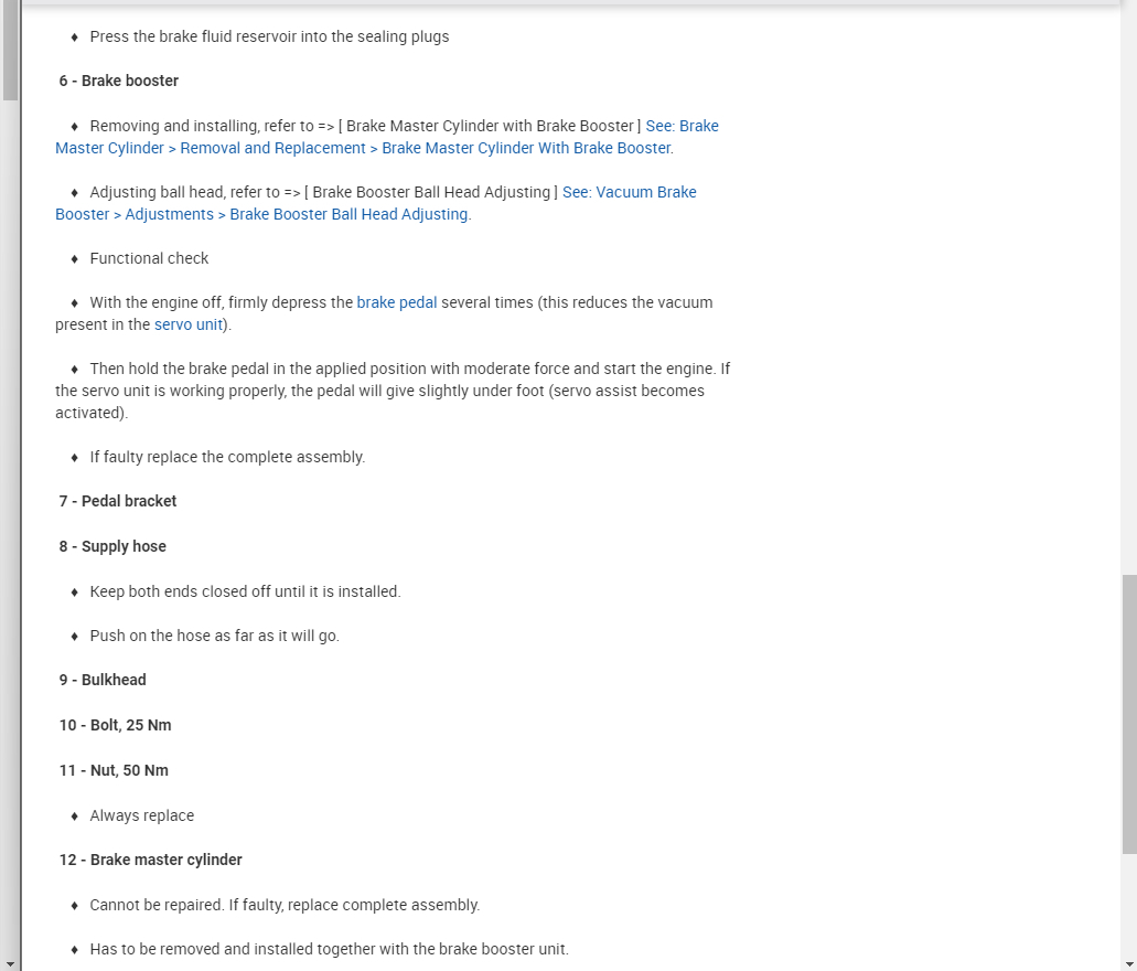

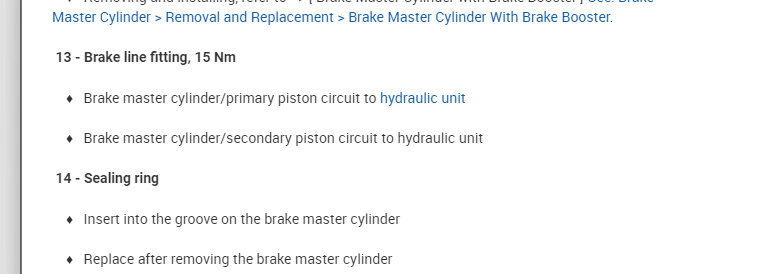

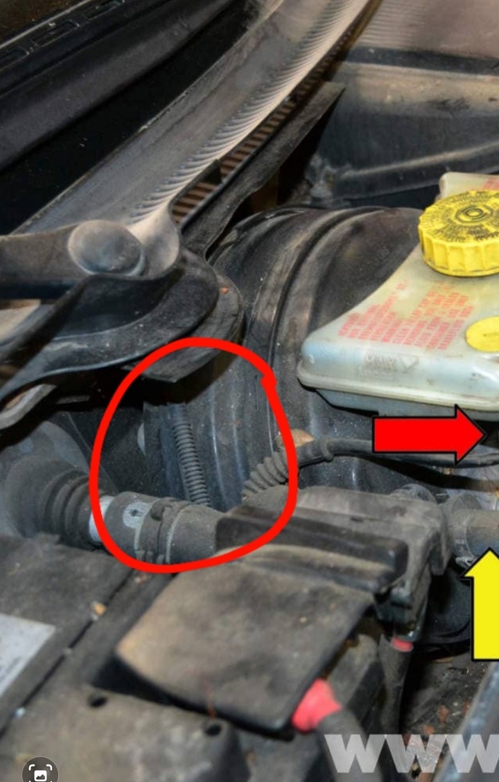

I searched everywhere online and couldn't find anything about what this plastic hose part is called and where it connects. The hose leads to the driver's side door. Some images I found online (see images attached) seem to show that it should connect under to the side of the master cylinder and booster or somewhere around there, but I can't see for sure. Help is appreciated.

Just to jump in on this, if you are seeing smoke coming from under what appears to be exhaust, then that is most likely not the cause of the lean code.
Here is a guide that talks about lean codes in more general info but if you find a vacuum hose then that is most likely the source:

Thank you for the response, Kenny K. I've done some research and inspection and figured out that the disconnected hose connects to the battery. It is a vent for the battery that releases the battery gases under the fender. I thought I was on to something. Back to the grind. Thank you for clarifying the smoke coming from the exhaust. I was confused. I cannot find a leak using smoke anywhere in the engine. Maybe it's a small leak. I've tried inducing smoke through the PCV valve, intake manifold, dipstick. Are there other areas I should run smoke through to inspect for leaks? Thanks again
