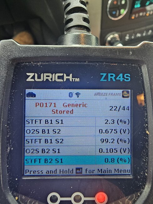

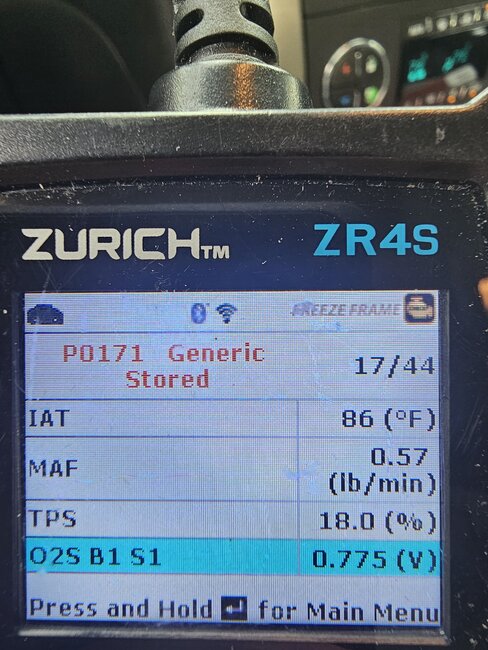

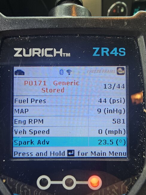

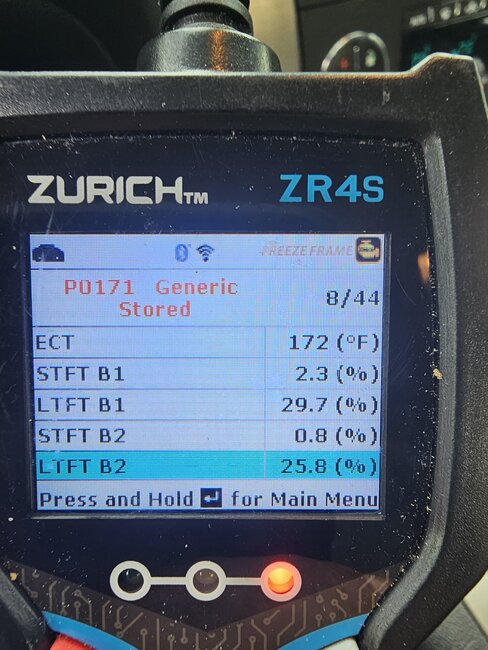

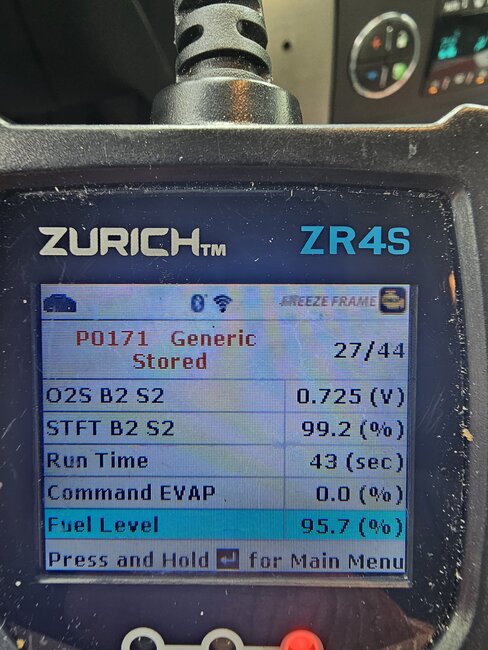

P0171 code. Cleaned MAF then got a p0174 temporarily. Sprayed water at base of intake and no noticeable difference. Not sure where to go next. My basic scan tool said fuel pressure at idle was 44 psi. It is the 5.3 lc9 flex fuel engine. Sluggish take off and bad fuel economy. About 13MPG.

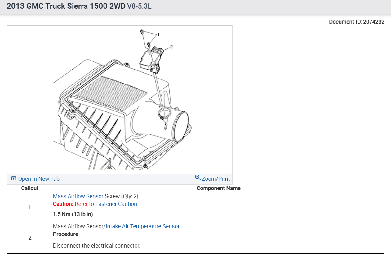

The P0171 code specifically points to a lean condition

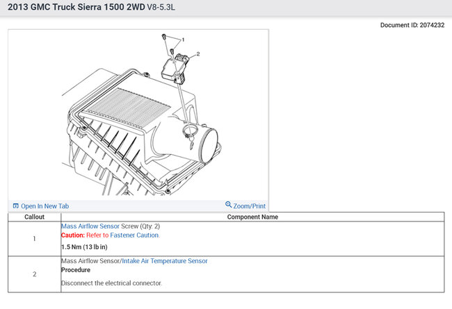

Since the cleaning fixed it for a while, I would replace the MAF sensor because once the sensor is too far gone cleaning it will not help to will also cause low power and gas mileage. Here is how to change out the sensor correctly. Check out the images (below). Please let us know if you need anything else to get the problem fixed.

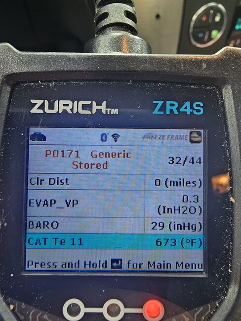

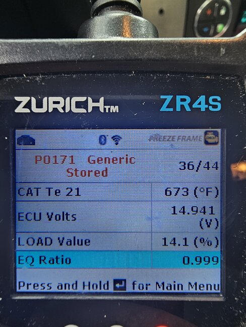

Sorry, the cleaning didn't fix it. It caused a second code, p0174, temporarily. I tried to load the scanner freeze frame to give you more info.

By these readings I would replace check for vacuum and exhaust leaks and if there none replace the sensor. Also, you should check the fuel pressure, here are guides to help you:
https://www.2carpros.com/articles/repair-lean-mixture-codes-p0171-or-p0174-on-some-manufacturers
Use this guide when the engine is cold only:
and
Key On Engine Off (KOEO): The fuel pressure should be approximately 60-66 PSI. (Pounds per square inch).
Key On Engine Running (KOER): The fuel pressure should be approximately 55-62 PSI.
You can rent the gauge at the local auto parts store for free or cheap. Please go over these guides and get back to us.
