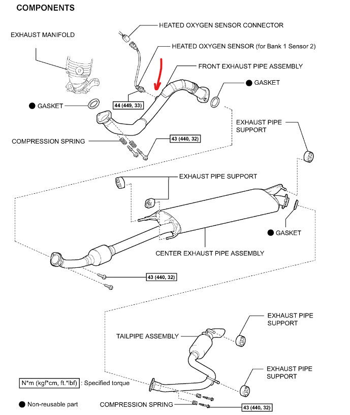

I keep getting a check engine, VSC, and 4WD light on. I have replaced fuel cap, downstream O2 sensor, spark plugs and coils. Where do I go from here?

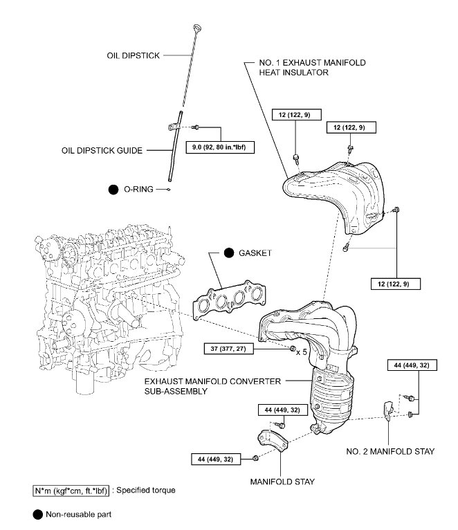

Code P0138 in the context of a 2007 Toyota RAV4 (or many other vehicles) refers to "O2 Oxygen Sensor Circuit High Voltage (Bank 1, Sensor 2).
So, with the voltage high it means there is air getting into the system so I would check for an exhaust system leak,

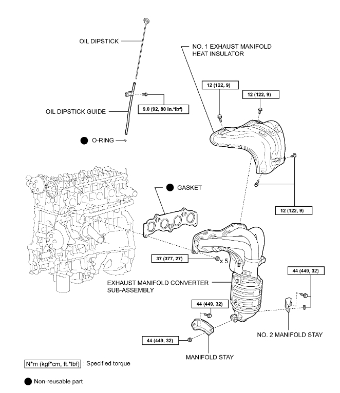

If no leaks are found the next step is to replace the catalytic converter or I have seen people install a spark plug extender where the oxygen sensor goes to help confirm the bad cat. Check out the images (below). Please let us know how it goes.

When I took my RAV4 into the shop, it needed a new muffler, and the check engine light, VSC light and 4wd light were on. I told them to fix it. They put a new muffler on and replaced the Bank 1 Sensor 2. 22 miles later the three lights came back on. The shop did a rescan and got the P0138 code again. They showed me a whole list of things to try but had no solution. I replaced the gas cap, checked vacuum lines, replaced the plugs and coils. The car has 116,000 miles on it. Could the catalytic really be bad?
