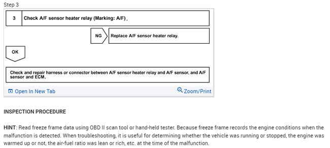

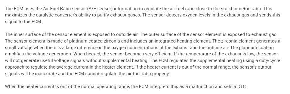

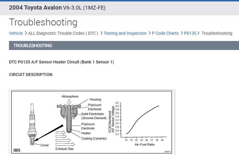

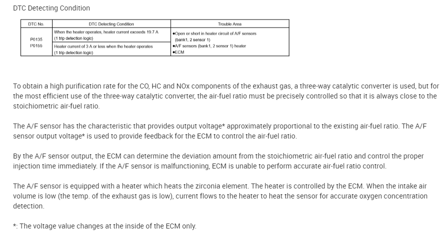

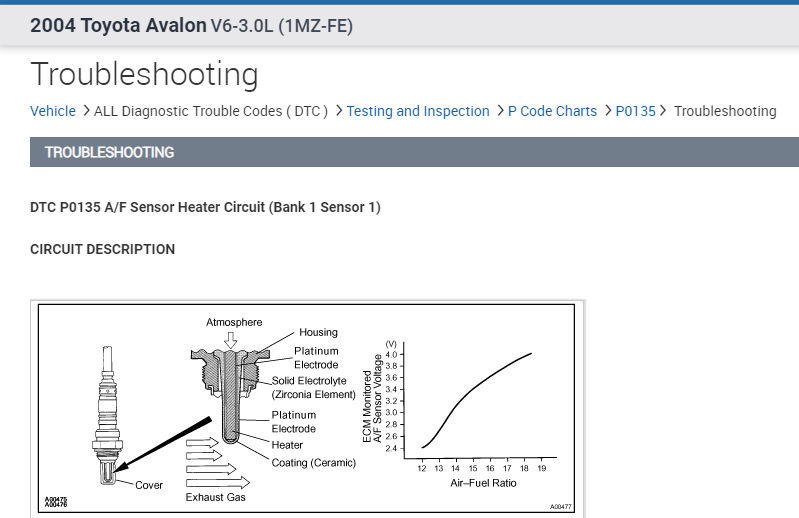

The code is related to the bank 1 sensor 1 heated oxygen sensor (A/F sensor). It simply could be a faulty sensor, a wiring issue, a rich or lean fuel mixture, and so on.
Here is what I recommend. First, confirm there are no engine vacuum leaks that can cause a lean fuel mixture to occur.
Here is a link that explains how that is done:
If no leaks are found, here is a link that explains how to test an oxygen sensor, do this next:
https://www.2carpros.com/articles/how-to-test-an-oxygen-sensor-02-sensor

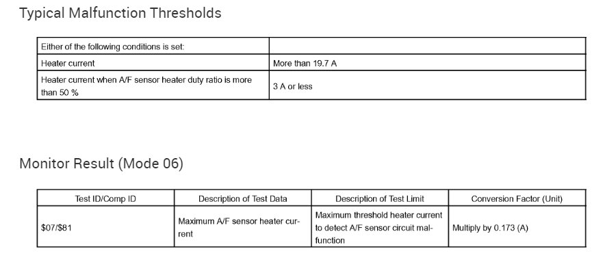

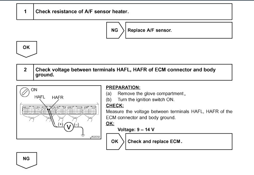

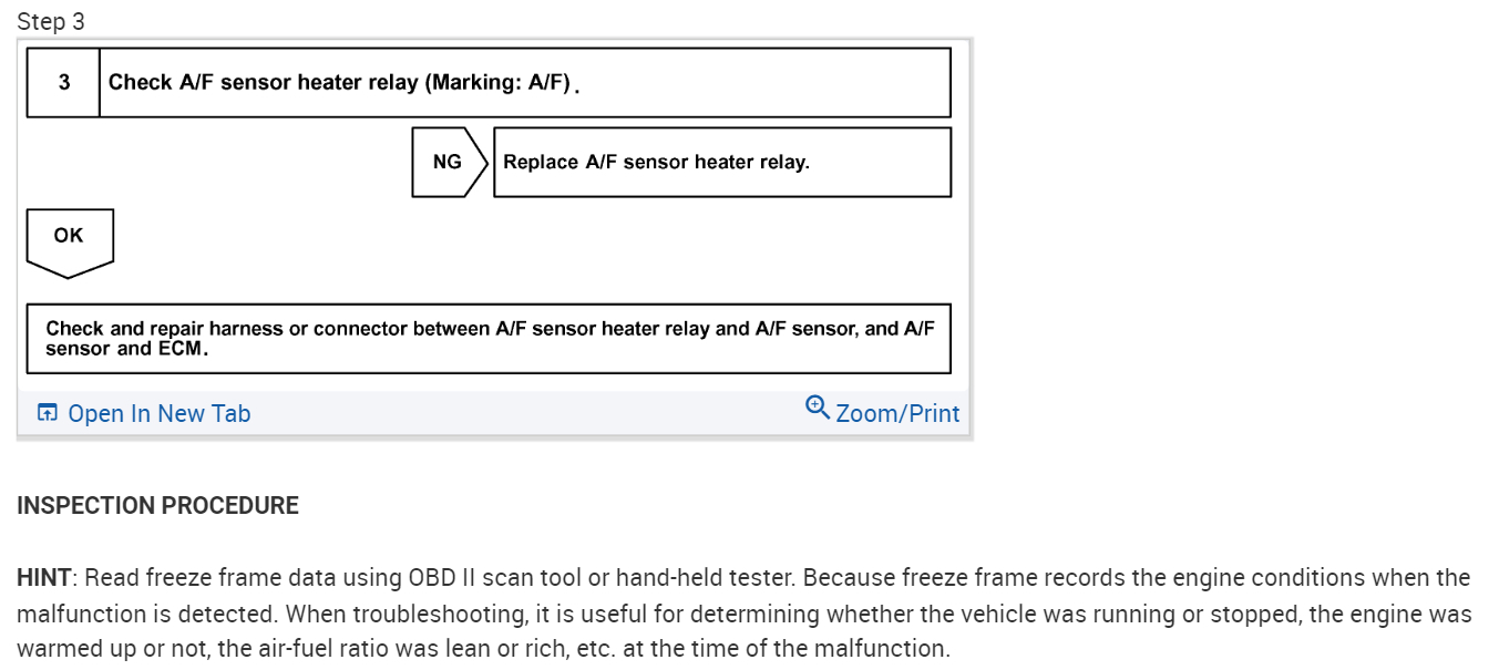

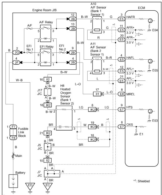

If there are no vacuum leaks or exhaust leaks, and the sensor tests good, I attached diagnostics below specific to this vehicle and code. Take a look through them and let me know if you are comfortable performing them.
Additionally, let me know if your scan tool provides live data.

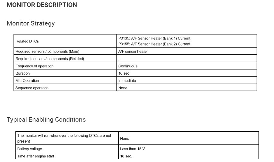

If you can watch the readiness monitors reset, I suspect live data is available. Not certain, but there is a good chance.
When you connect your scan tool, check to see if there is anything indicating live data or monitoring.
To answer your last question, when you delete codes, it clears all memory from the PCM until the readiness monitors complete their drive cycles. I suspect it is taking approximately an hour of drive time for the monitor related to the sensor to finish. When it sees there is an issue, the light is turning back on.
