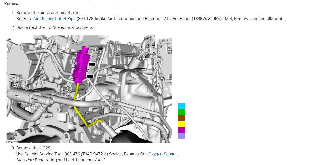

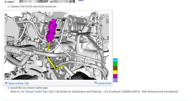

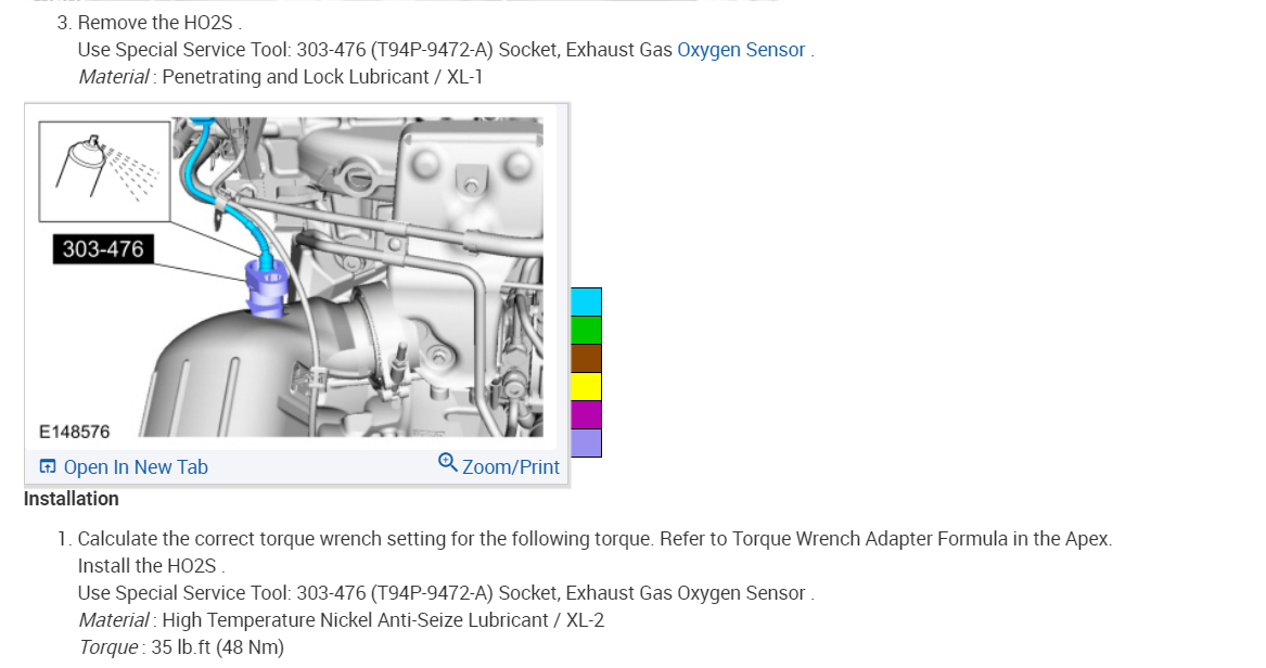

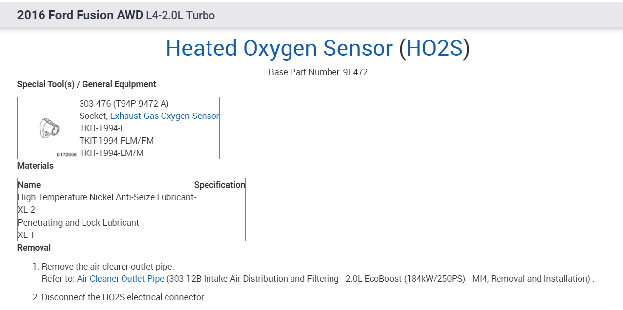

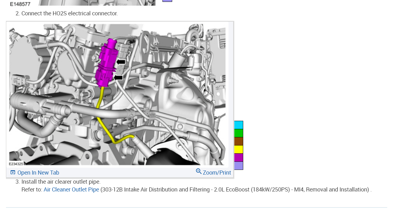

I want to know the location of this sensor so I can replace it.
May 17, 2023 at 1:40 AM
  • 55,433 POSTS
Sure, here is the sensor location so you can change it out.
The P0135 code indicates a malfunction in the oxygen sensor circuit for bank 1 sensor
