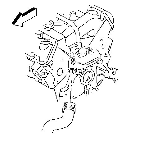

For the last couple of days my car has not been getting to the normal operation temperature it been getting to 160 degrees and usually it’s at 200. I got a check engine code for P0128 saying the car is taking too long to heat up. I’m planning to replace the thermostat tomorrow. Today I went to check the upper hose where the thermostat is and it was extremely hot to touch.
Nov 9, 2020 at 6:27 PM
  • 110,194 POSTS
The hose being hot is normal if the engine was just turned off or running. As far as the code, the thermostat is the likely cause. If the engine doesn't warm up fast enough because the thermostat isn't allowing it to, it increases the emissions put out by the vehicle which can result in the code you mentioned. So what you have suggested makes sense to repair the issue.

Thermostat Replacement
Tools Required
^ J38185 Hose Clamp Pliers
Removal Procedure
pic 1
1. Remove the air cleaner intake duct.
2. Partially drain the cooling system.
3. Use the J38185 in order to reposition the hose clamp from the thermostat housing.
4. Remove the radiator inlet hose from the thermostat housing.
5. Remove the thermostat housing bolts.

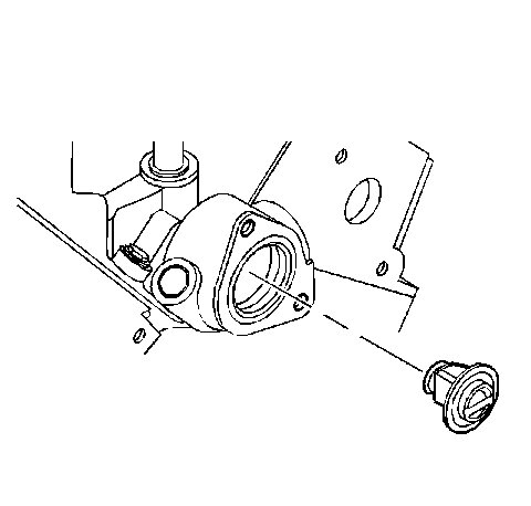

pic 3
7. Remove the thermostat.
8. Clean and inspect the thermostat housing gasket mating surfaces.
Installation Procedure
pic 4
1. Install the thermostat.

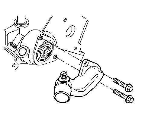

pic 5
2. Install the thermostat housing.
pic 6
3. Notice: Refer to Fastener Notice in Service Precautions.
Install the thermostat housing bolts.
Tighten the bolts to 25 Nm (18 ft. lbs.).
4. Install the radiator inlet hose to the thermostat housing.
5. Use the J38185 in order to reposition and install the hose clamp to the thermostat housing.
6. Install the air cleaner intake duct.

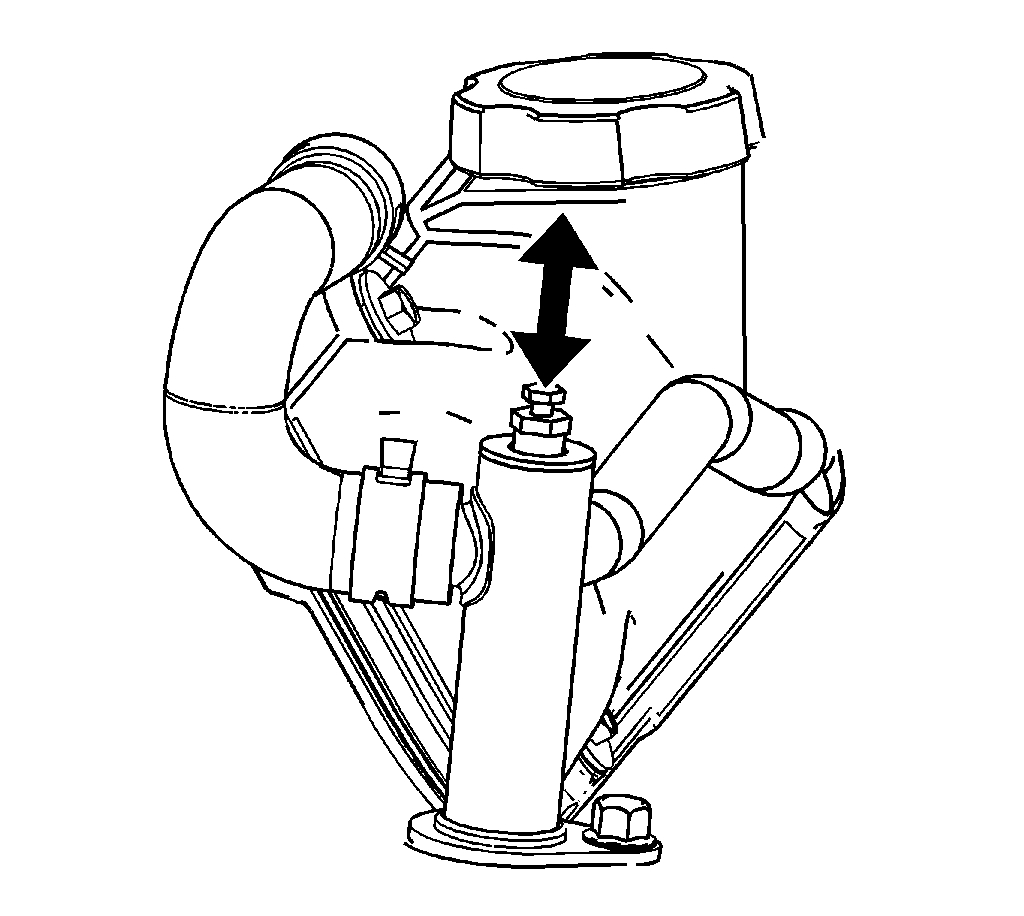

Fill Procedure
1. Notice: The procedure below must be followed. Improper coolant level could result in a low or high coolant level condition, causing engine damage.
Install the engine block left coolant drain plug.
2. Close the radiator drain plug.
3. Lower the vehicle.
4. Vehicle should be level.

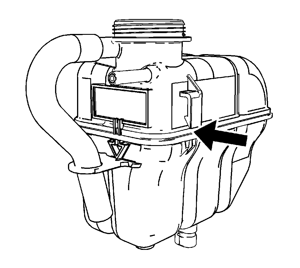

pic 7
5. Add a mixture of 50/50 DEX-COOL(R) antifreeze and clean drinkable water until the level stabilizes at the weld seam on the surge tank.
pic 8
6. Unscrew the coolant bleed screw on the engine until coolant comes out of the bleed screw.
7. Close the bleed screw.
8. Add coolant until the level stabilizes at the weld seam on the surge tank.

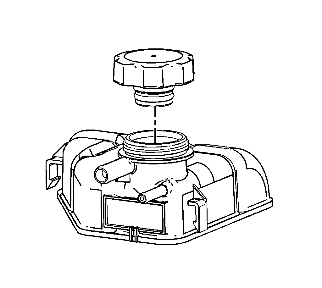

pic 9
9. Install the surge tank cap.
10. Important: DO NOT exceed 2,200 RPM.
Start the engine and run at 2,000 RPM until the engine cooling fans turn ON.
11. Remove the surge tank cap.
12. Refill to the weld seam on the surge tank.
13. Important: Coolant should be at the full cold mark when the system cools.

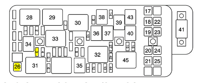

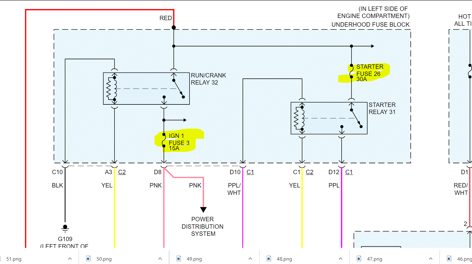

So during this process I disconnected the battery cause a evap code came on for the canister purge valve so now the it’s ticking a lot. So I disconnected the battery and now it won’t start all lights turn in radio is good. I went to AutoZone and had the battery tested and it’s good. I believe the starter maybe be bad. I was reading a forum where the starter goes bad over time because the exhaust pipe is so close to the starter.
Nov 10, 2020 at 12:49 PM
  • 110,194 POSTS
Do me a favor. Have a helper turn the key to the start position while you record what is happening under the hood. Also, take a look through this link and let me know if it helps. I doubt the starter went bad, but anything is possible.
Make sure the battery terminals are clean and tight and confirm a fuse didn't blow when you disconnected the battery. Also, make sure it is fully in park or neutral when trying to start it.
See the attached pics to help locate the fuses I need checked. In addition to checking the fuses' conditions, make sure there is power to them and out from them. Here is a link you may find helpful:
Let me know what you find.
