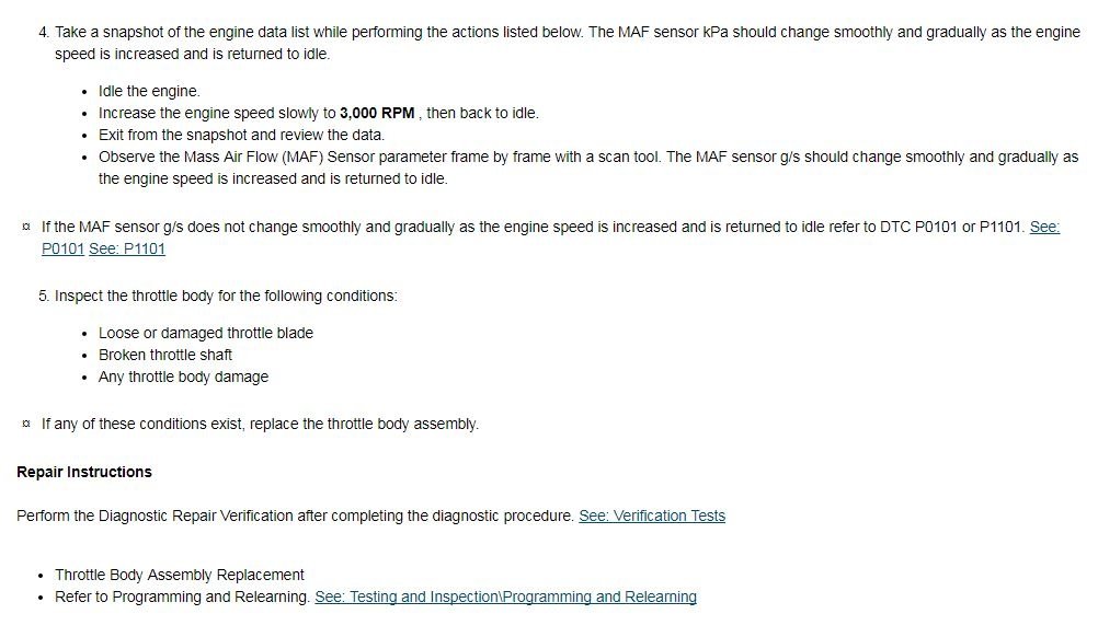

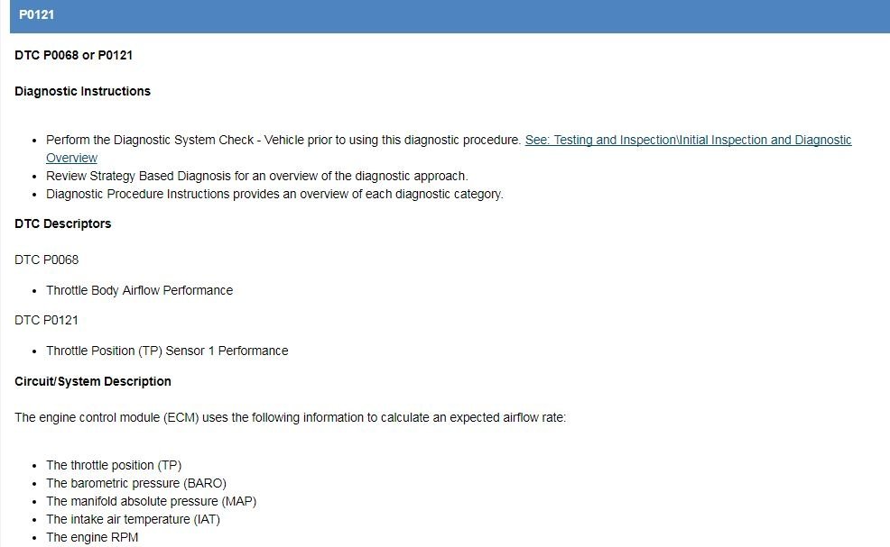

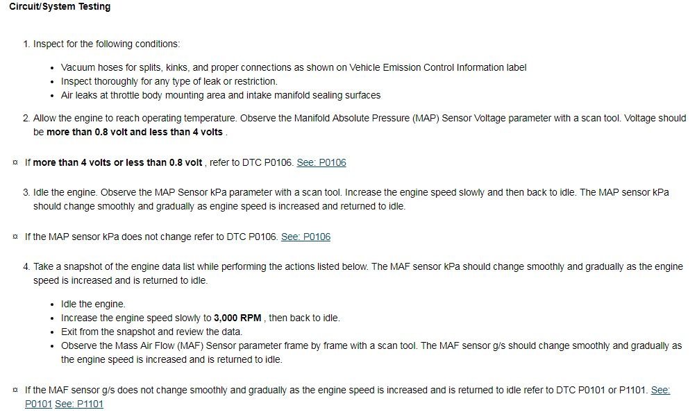

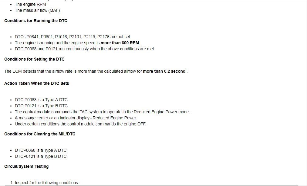

Okay, that code actually indicates that air flow is more than the PCM expects it should be, based on the reported throttle position. It could be a bad sensor, or it could be an air leak of some sort. I am attaching ALLData's information on the code in the images below. I get that you may not be able to run all of the tests, but do what you can. I am also including a link to our how-to guide on finding and fixing vacuum leaks: https://www.2carpros.com/articles/how-to-use-an-engine-vacuum-gauge
Hopefully you will be able to find and fix your problem using it. Let us know what you find.
