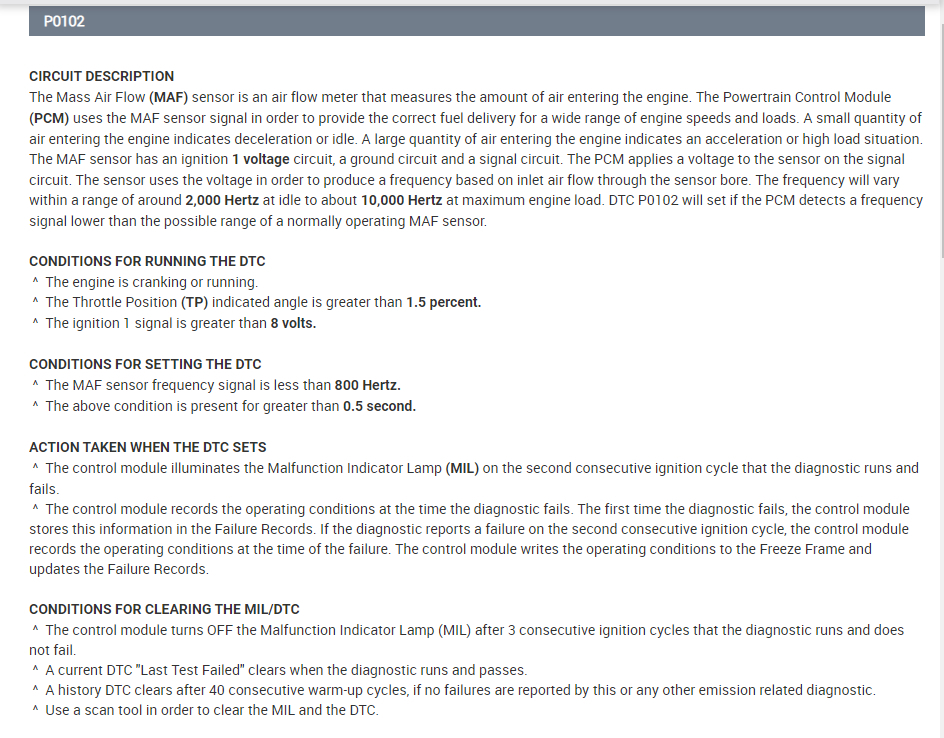

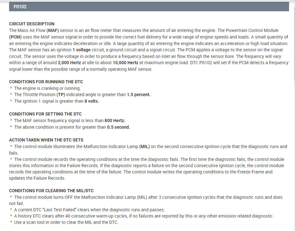

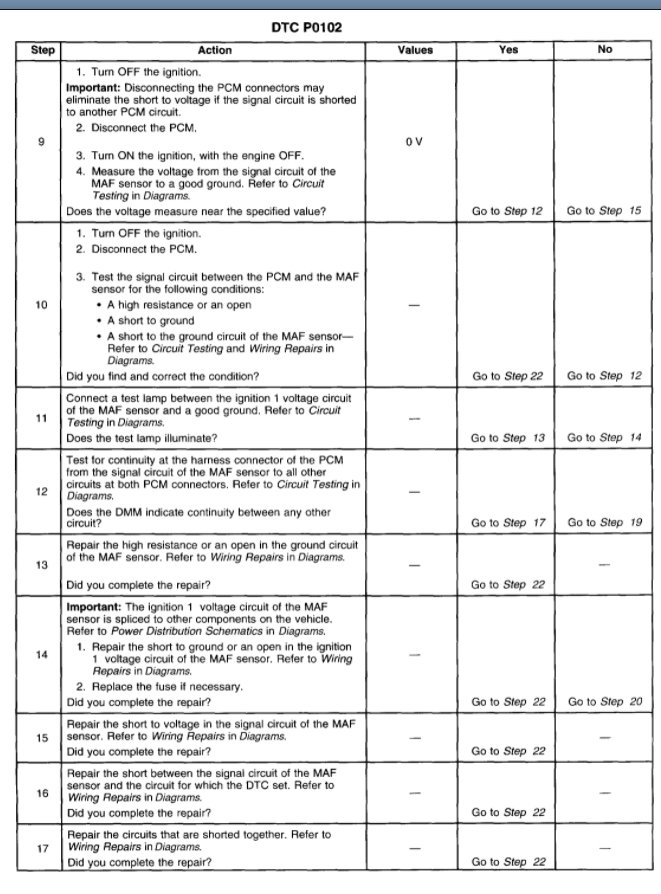

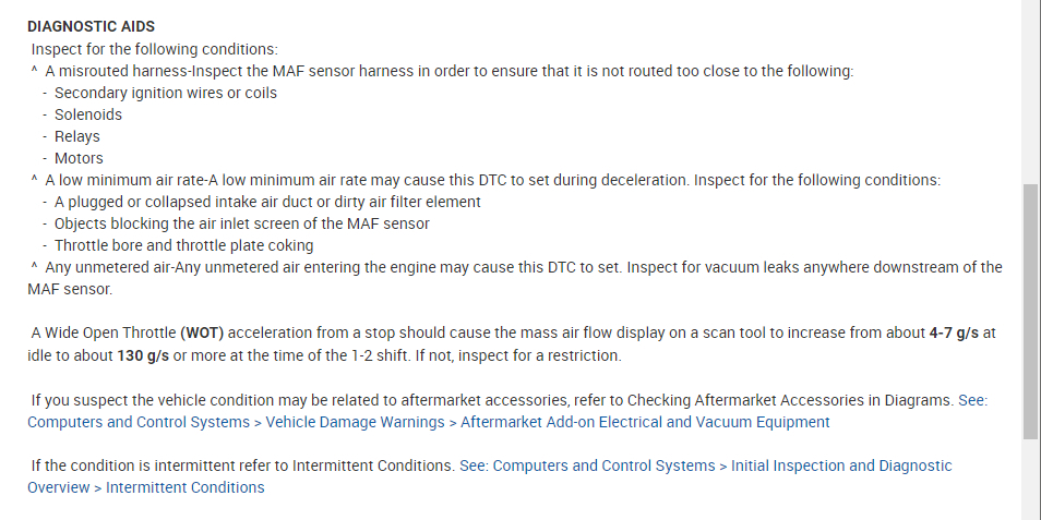

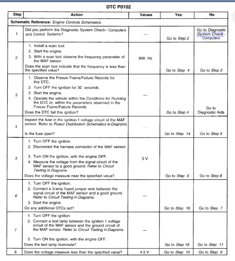

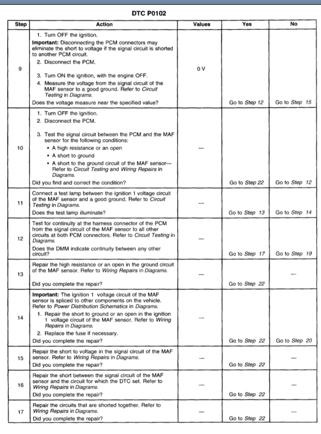

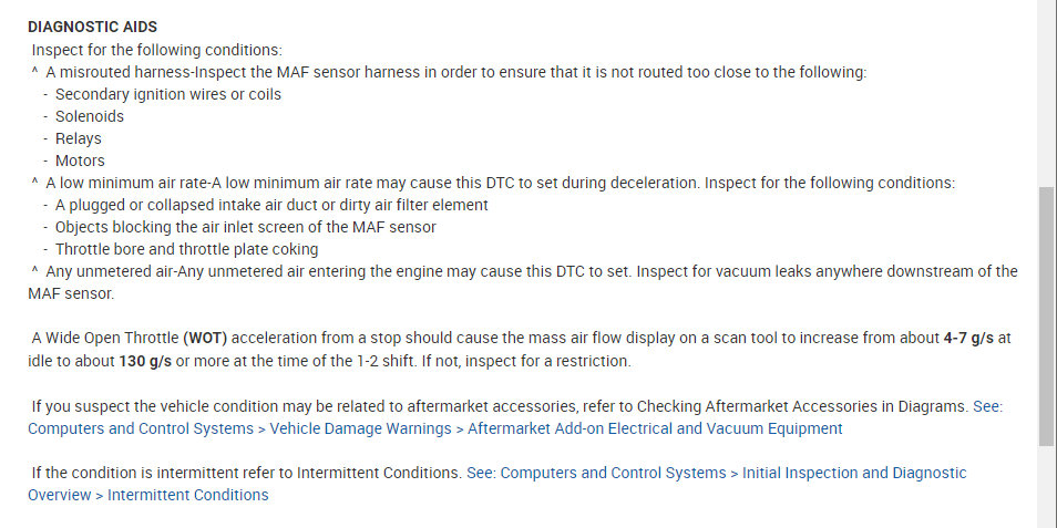

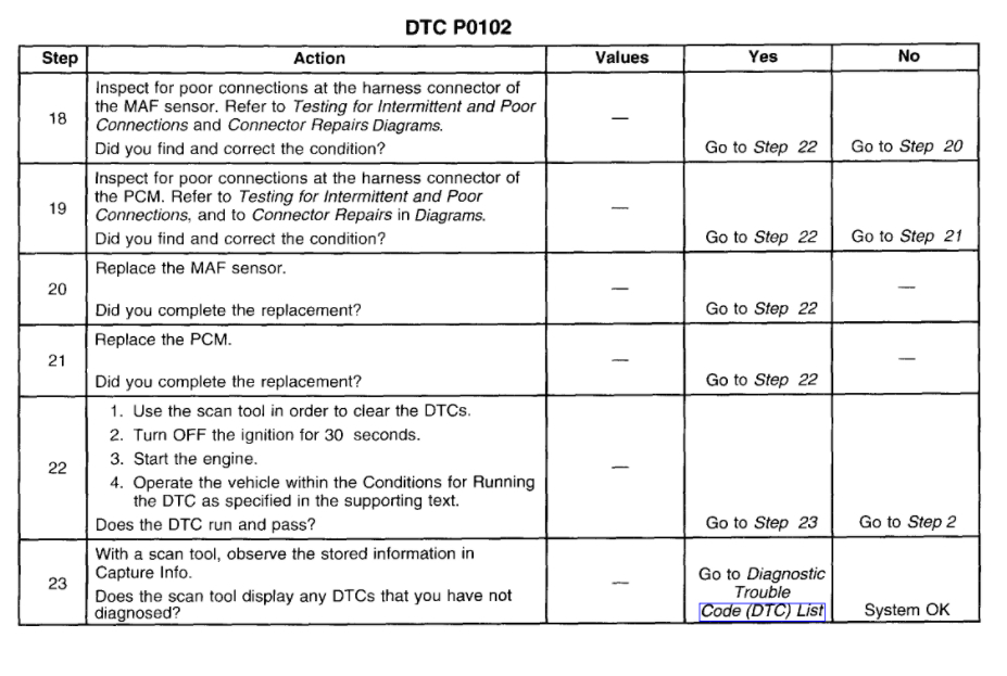

However, I would suggest running through the testing that I am attaching below and that will walk you through the issue.
You may be testing this correctly but just the way you described it is not clicking with me. I would suggest we follow the testing below and go from there. Thanks
