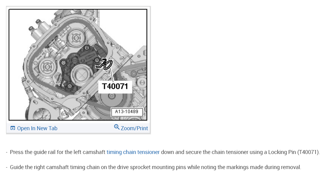

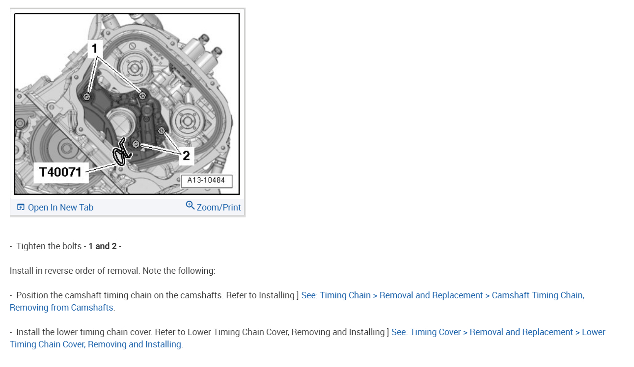

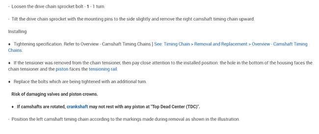

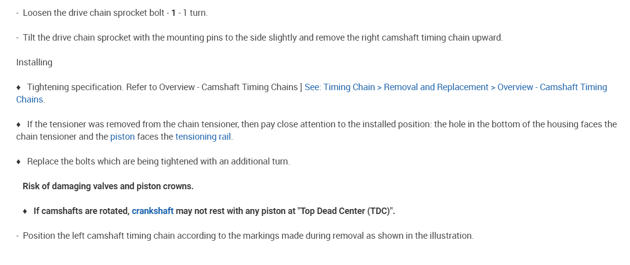

Hi, I did a timing chain on an Audi 3.2. Did leak down test before reassembly and no leak down and lobes were pointed correctly, I also had timing kit installed to lock. The engine was out of time on the 2nd bank, one tooth. Rotated engine marks lined back up. Reinstalled engine. P0018 and p0019 come up. (These were the codes to begin with.) Verified it was out of time, engine is in time, verified with leak down test, going to compression test it tomorrow, but is there anything else that can cause this? I believe the VVT are new too, not sure if off brand though. Also, has a secondary air fault code.
Oct 5, 2022 at 3:05 PM
  • 55,433 POSTS

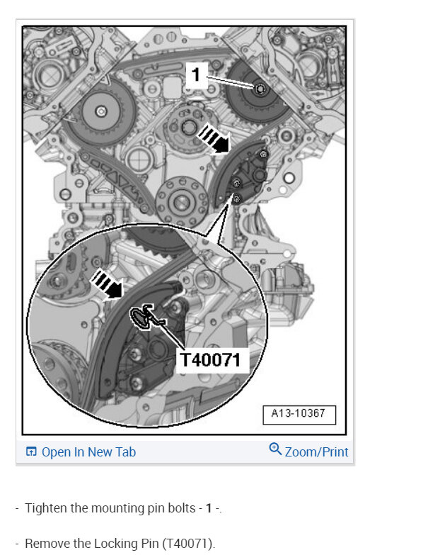

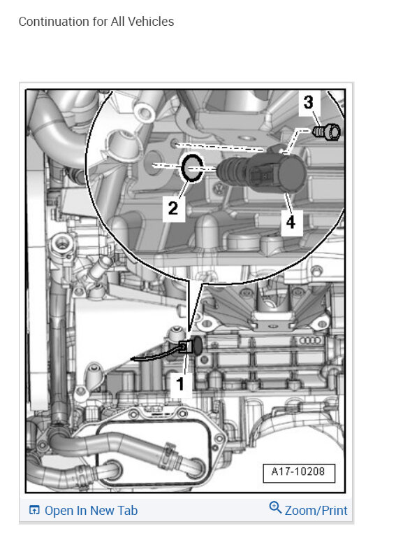

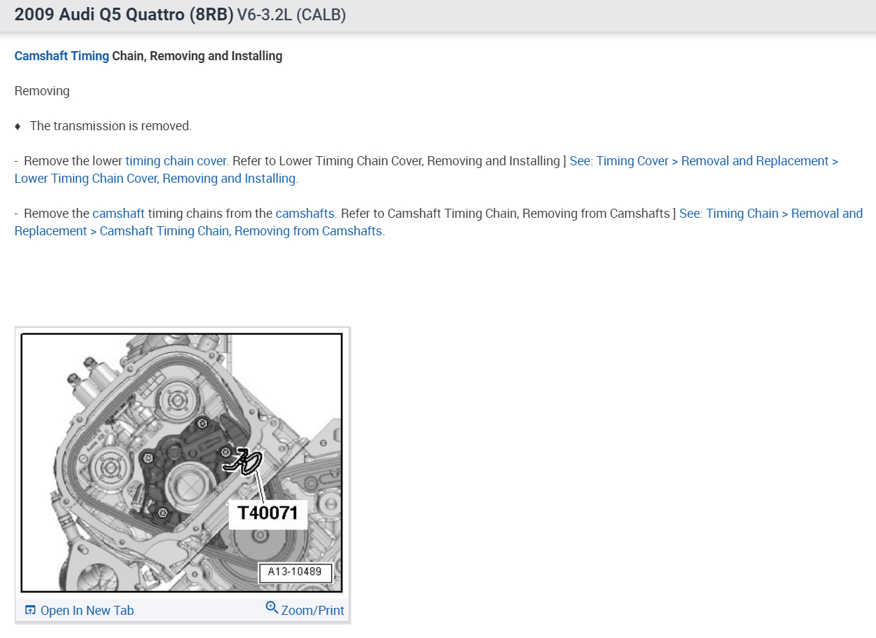

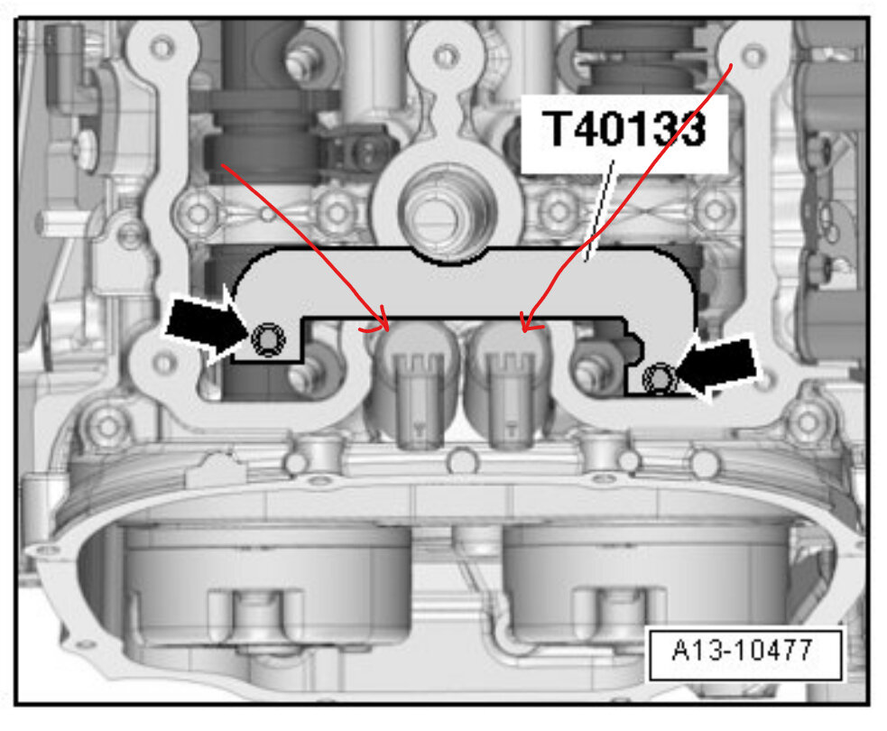

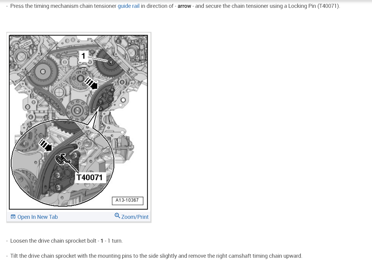

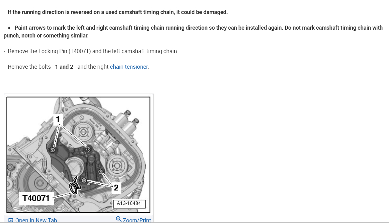

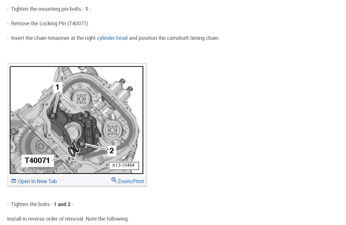

The code P0018 stands for Crankshaft Position Camshaft Position Correlation (Bank 2, Sensor A). On these cars the sensor wrong can plug into different sensors, in other words you could have the sensor connections in the wrong placements. If there are any questions, try swapping the connectors. If that is okay, I would check or replace the camshaft oil control solenoid valve and re-check the timing marks. here is how the job is done in the images below and the location of the valve as well. I would also remove the camshaft oil control valves and clean the screen because they can get clogged up and stop working. Also, make sure the engine is full of good clean oil, and a new filter. Check out the images (below). Let us know what happens and please upload pictures or videos of the problem.

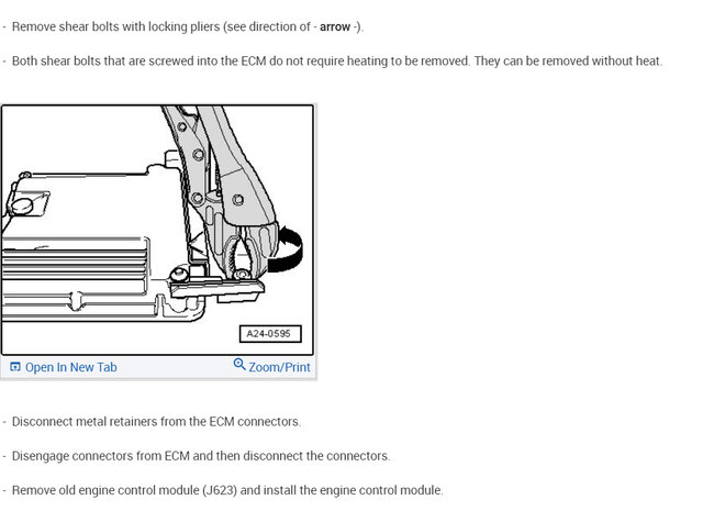

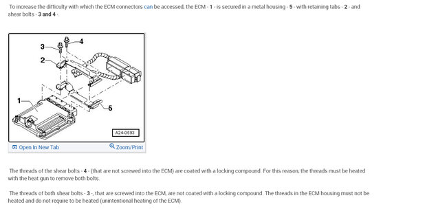

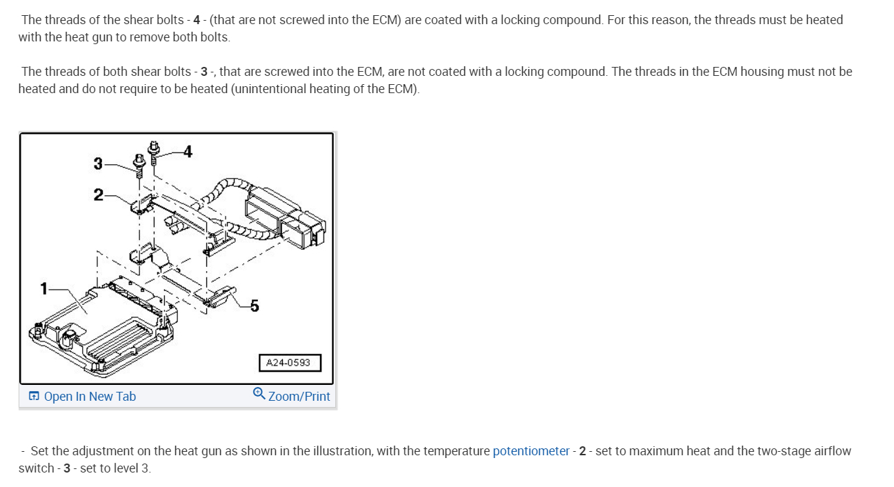

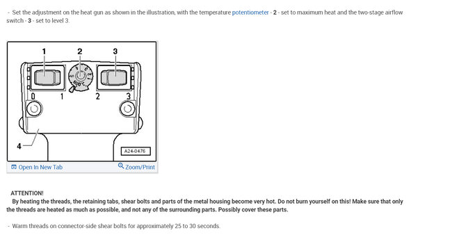

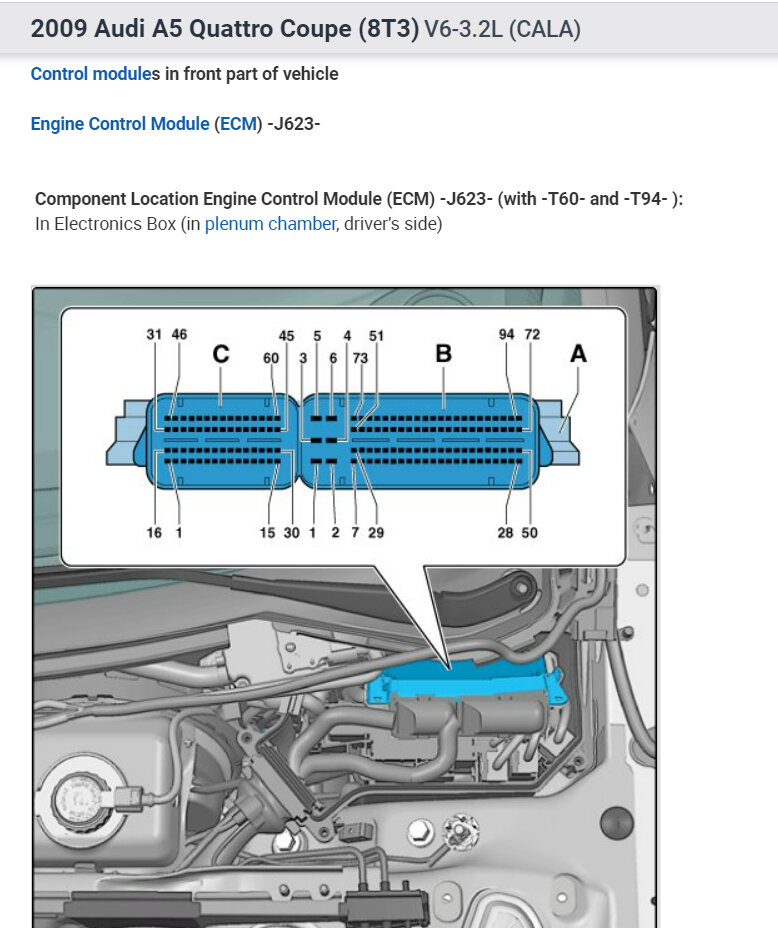

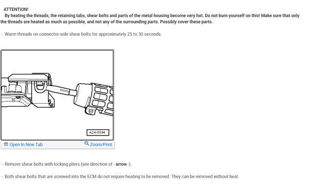

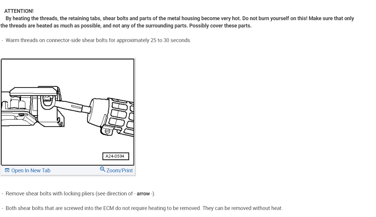

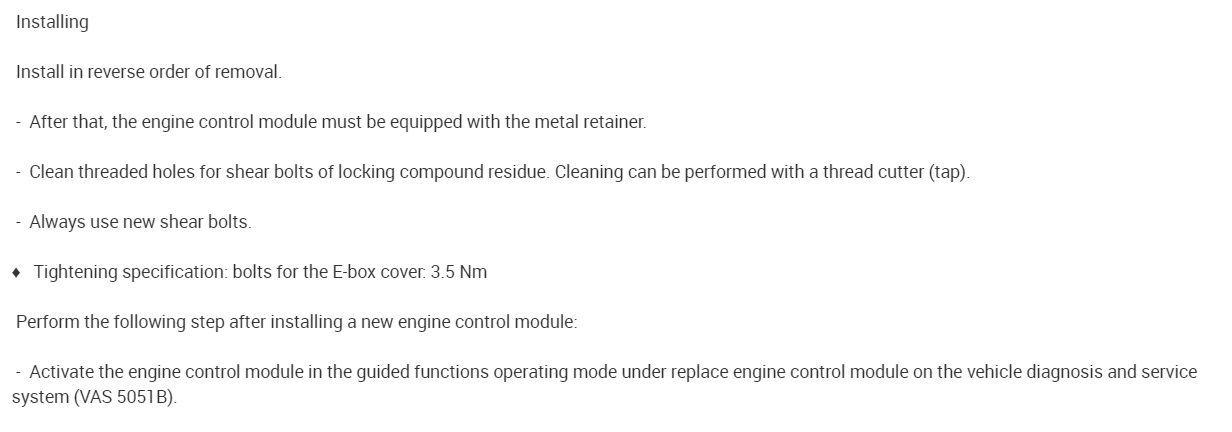

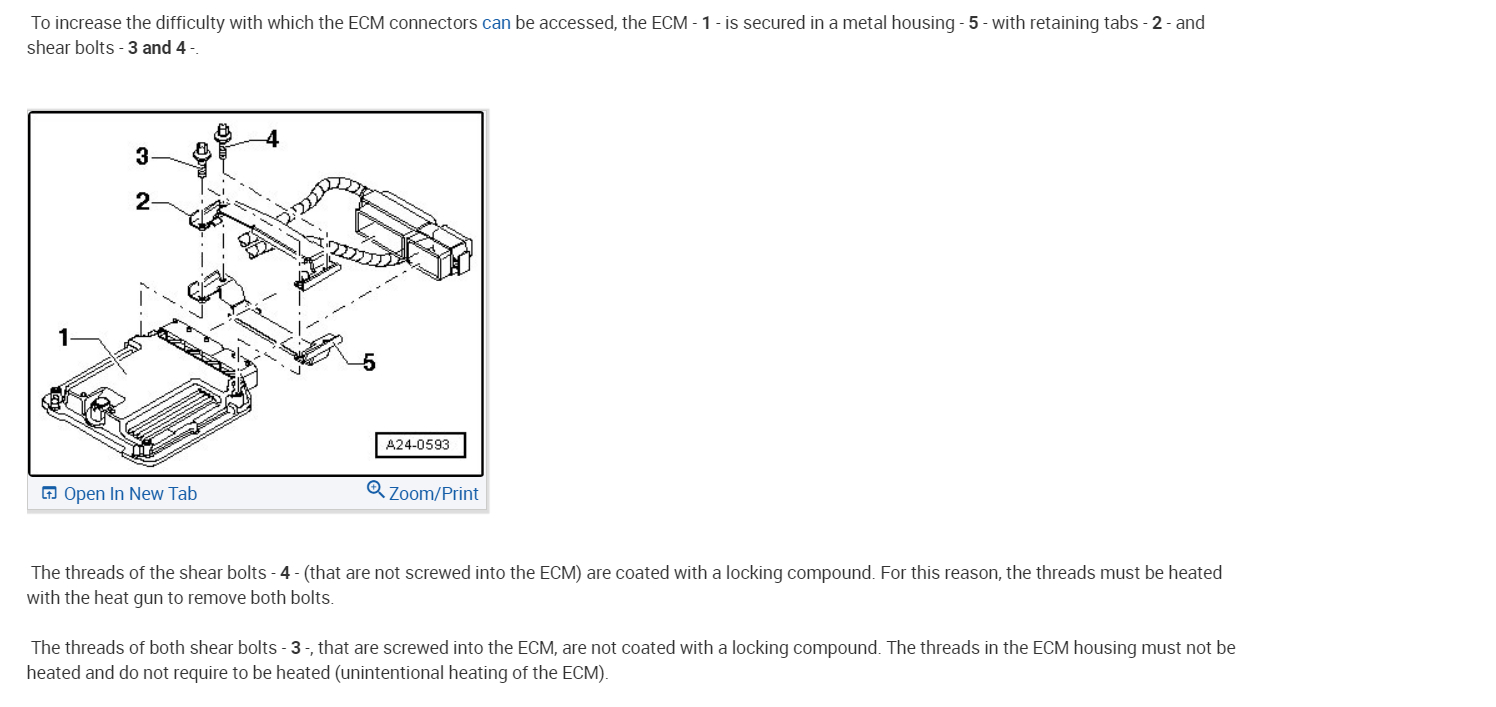

Yep, that is strange the way the code changed I have to agree the computer could be bad. Here is how to change out the PCM in the images below.
