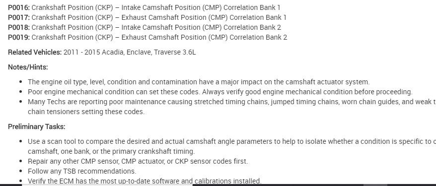

I am not sure which one it is and how to get to it?

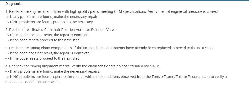

This could be a loose timing chain from wear or it could be a crank sensor. When the cam and crank sensors are not together at top dead center, this is the result. Someone will need to check the chains to see if they need replacing.

Vehicles with 2.8 LP1, 2.8 LAU, 3.0 LF1, 3.0 LFW, 3.6 LFX, 3.6 LLT, or 3.6 LY7 engines may exhibit two or more of the following DTCs: P0016, P0017, P0018, P0019, P0008 or P0009.
Recommendation/Instructions
If the above concern is present, check for loose timing chains or tensioners.
If after following SI diagnostics the root cause is not found, the following may be helpful.

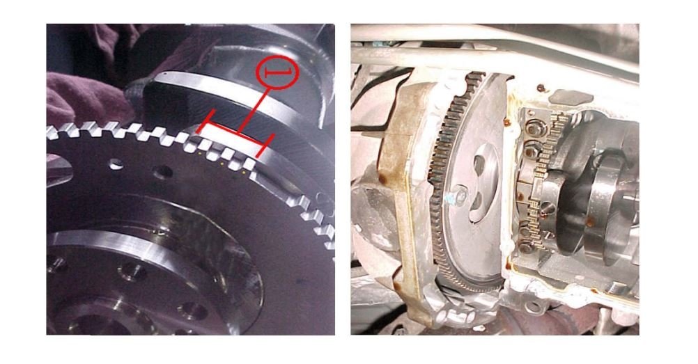

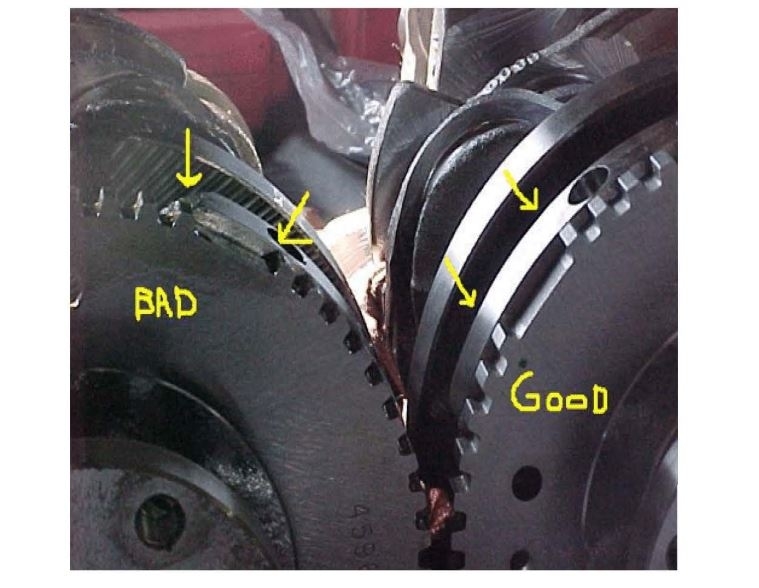

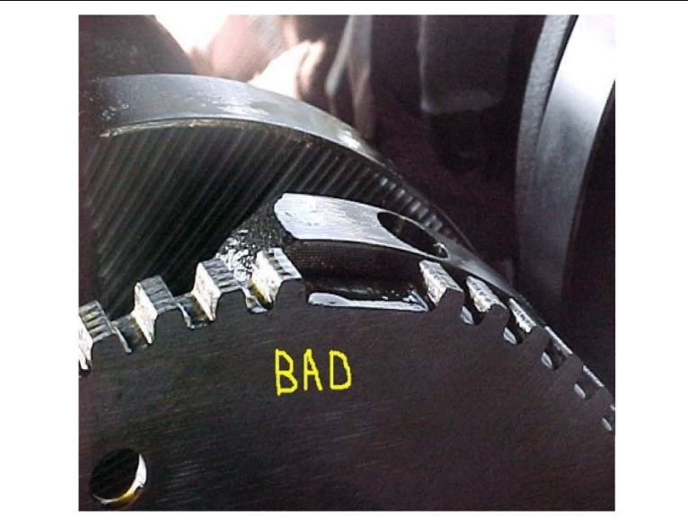

The reluctor for the crankshaft sensor pressed on the crankshaft may have moved.
Refer to attached photographs for exact location.
(It is possible on some applications to view this with a bore scope through the crank sensor hole without removing the oil pan)
If the reluctor has moved then replace crankshaft.
1= The actual measurement of a good Reluctor wheel.
25 to 26 mm This measurement is from the end of the machined surface of the crankshaft throw to the edge of the open space in the reluctor. (approximately 3 1/2 teeth)
2 and 3 = Show a good reluctor next to a bad reluctor.
Crankshaft with bad reluctor wheel.

The distance can be offset either clockwise or counter clockwise. Both will result in these codes.
Note:
The balance hole does not come into play when determining if the reluctor has slipped or not.

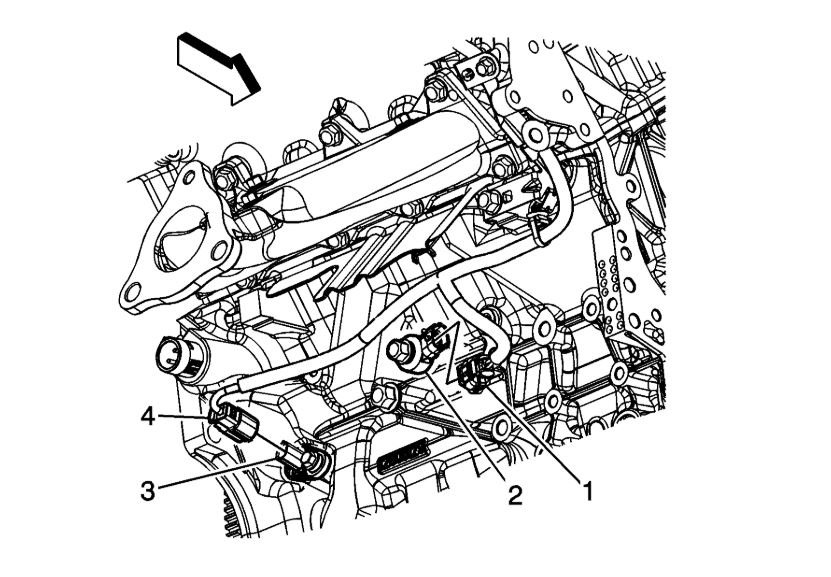

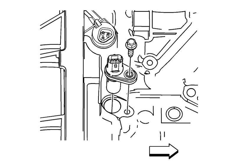

Crankshaft Position Sensor Replacement
Removal Procedure
1. Remove the exhaust manifold lower heat shield. Refer to Exhaust Manifold Lower Heat Shield Replacement See: Heat Shield, Exhaust > Removal and Replacement > Exhaust Manifold Lower Heat Shield Replacement.
2. Disconnect the engine wiring harness electrical connector (3) from the crankshaft position (CKP) sensor (4).
3. Remove the crankshaft sensor bolt.
