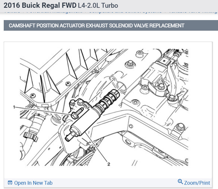

Hello i need help with my car listed above. It idles roughly and sometimes shuts off. I checked for codes and i got a p0017 code. It's says Crankshaft Position - Exhaust
Camshaft Position Not Plausible.

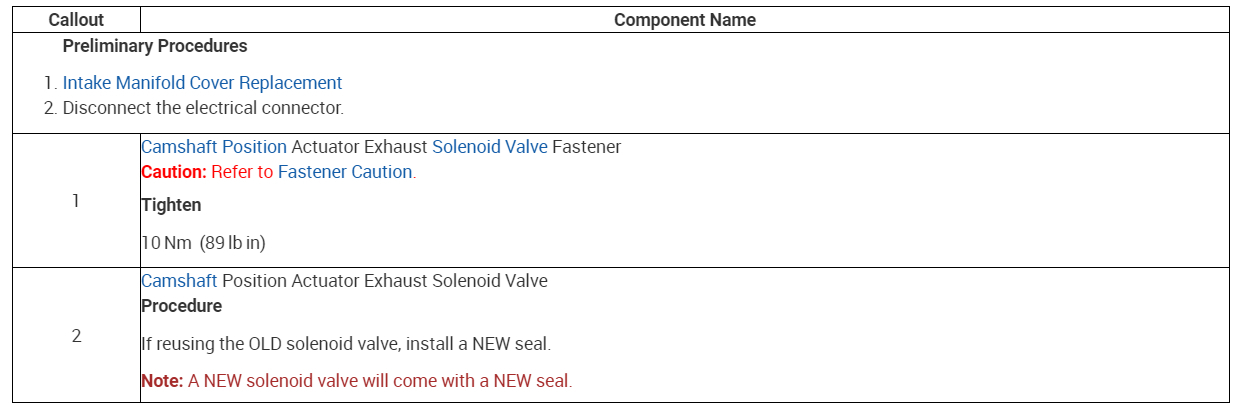

The first thing I would do is make sure the engine oil is full and clean. If so, I would swap out the exhaust camshaft oil control valve. Here is the location in the images below.
code P0017 Position Correlation (Bank 1)" error.
Check out the images (below). Please let us know how it goes.
