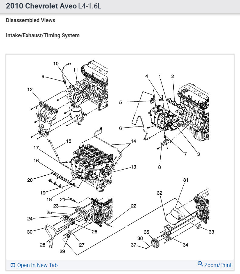

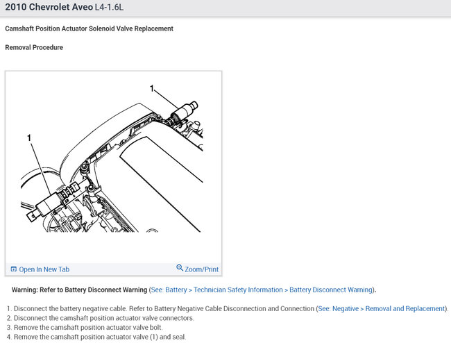

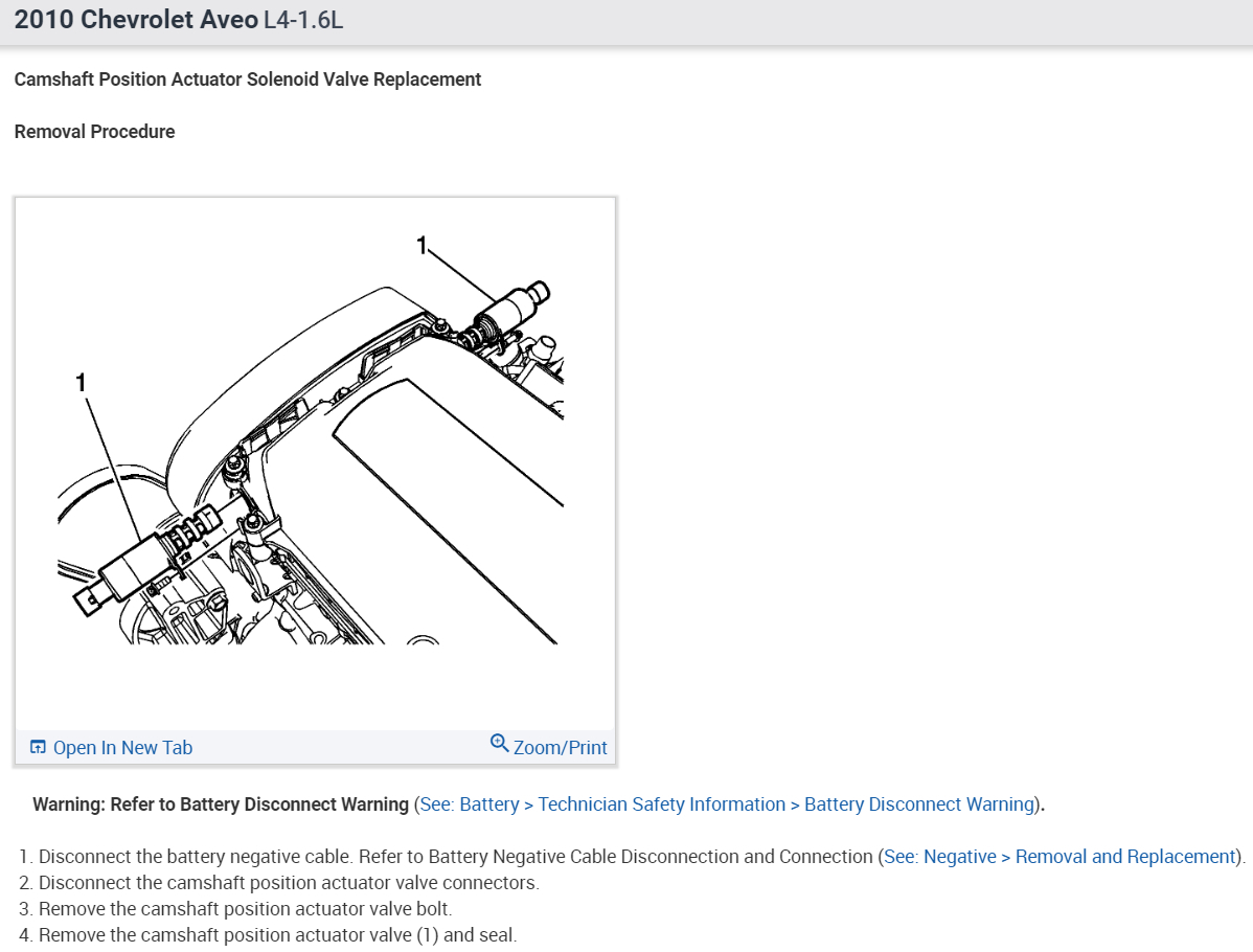

I would try replacing the oil control solenoid because they can plug not supplying oil pressure to the camshaft actuator. Here are diagrams to help.
Check out the diagrams (below). Please let us know what you find. We are interested to see what it is. Cheers, Ken
Dec 19, 2018 at 1:57 PM
CARBUFF64
I had the same problem and replaced the oil valve then cleared the codes they have not returned! Thanks I love this site.
