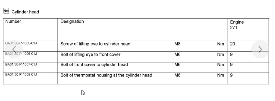

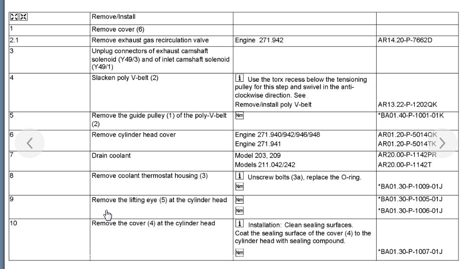

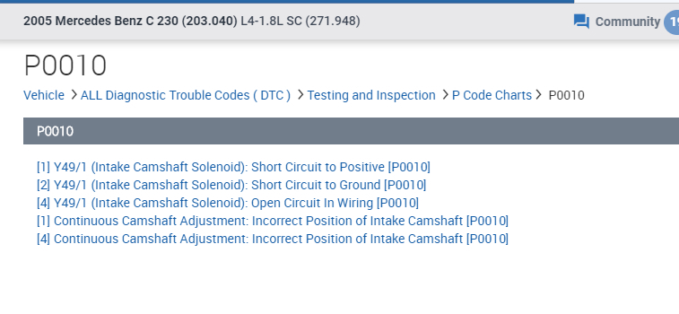

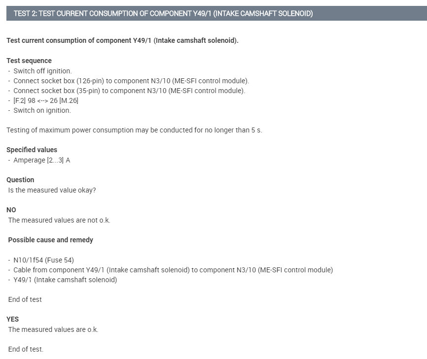

I would be happy to provide you the test for this code and then repair procedure if it turns out to be the head gasket. Or if you just want me to give you the head gasket procedure I can just do that.
As for buying the manual, I am not to sure other than ebay or something like that. I did a quick search and did find any for your specific vehicle. However, as I said we can help out in most cases.

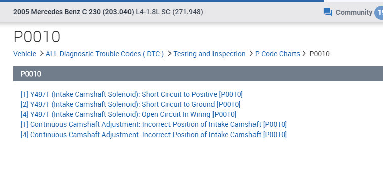

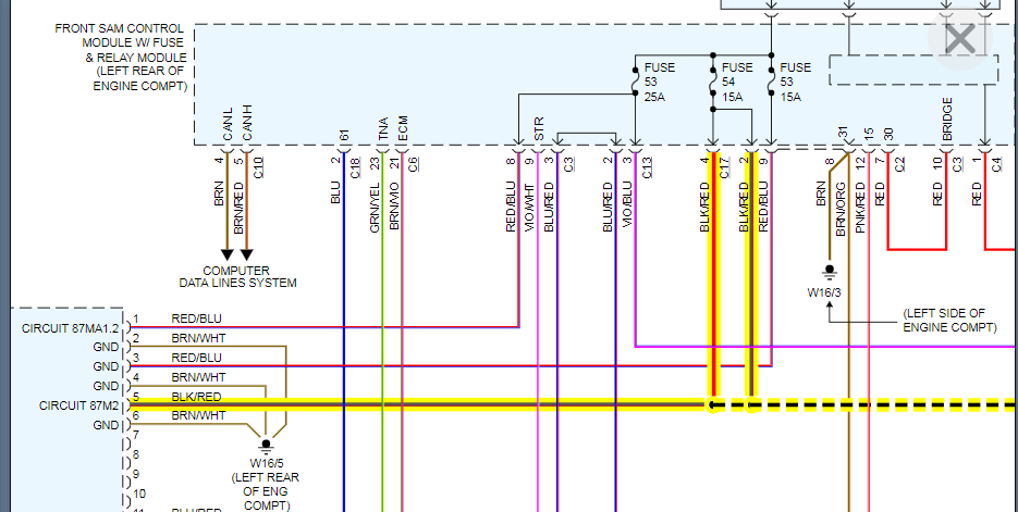

Just let me know the detail about the code that you have because there are options. The scan tool should have given you more info other than just the code. See attached.
Jul 22, 2019 at 10:11 AM
BIGRUSSELL18

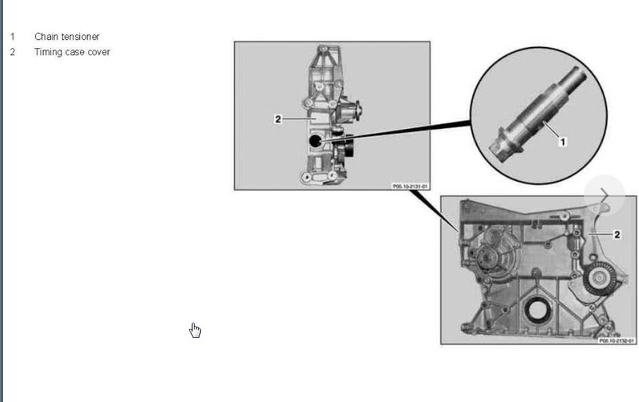

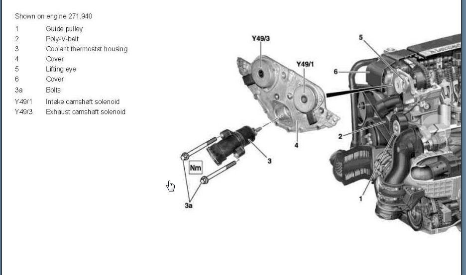

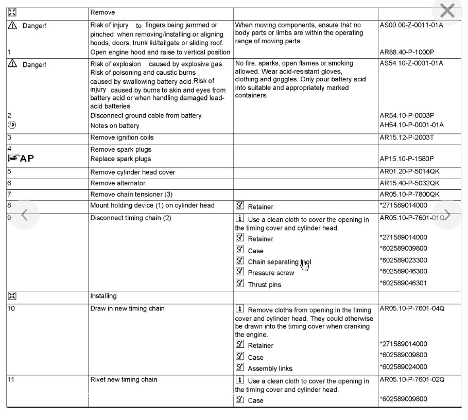

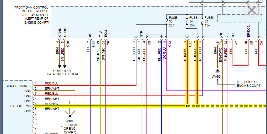

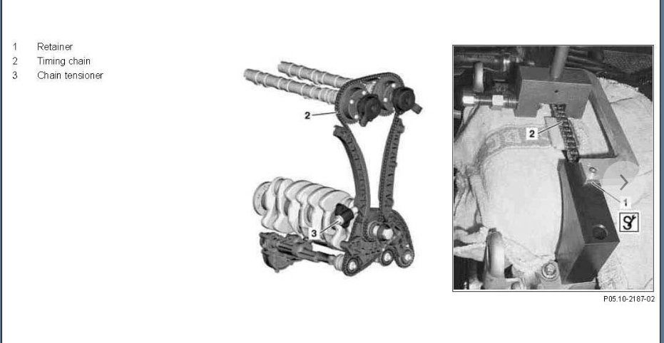

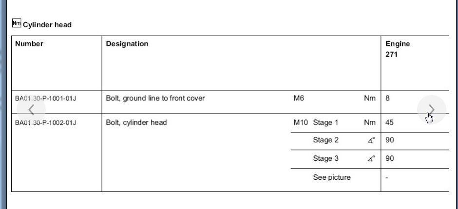

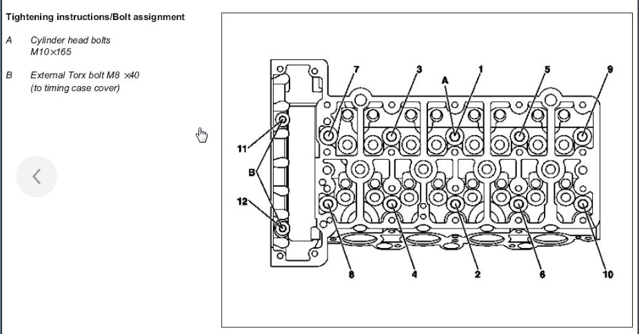

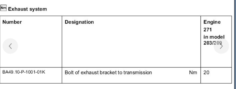

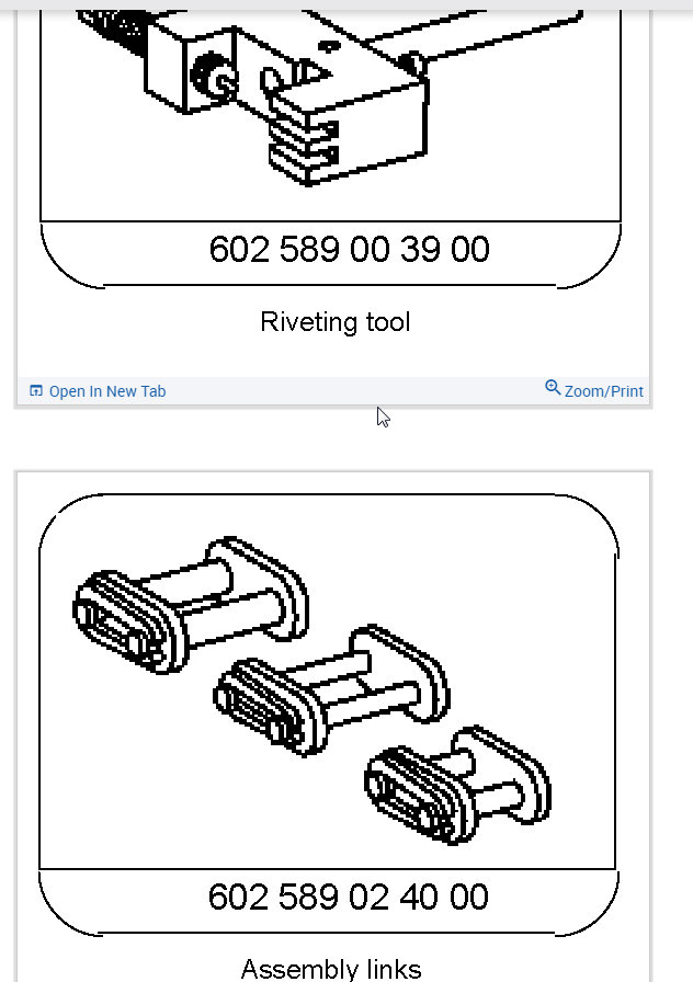

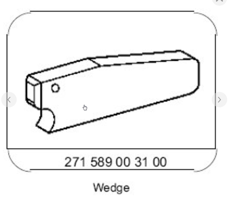

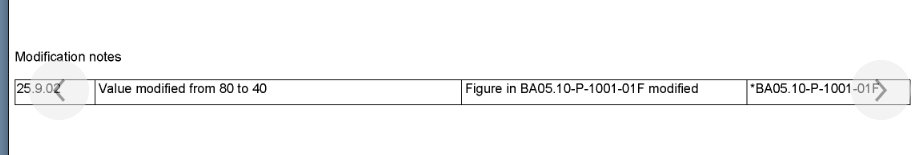

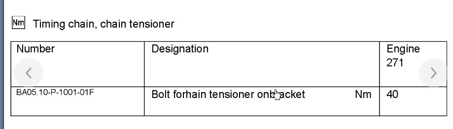

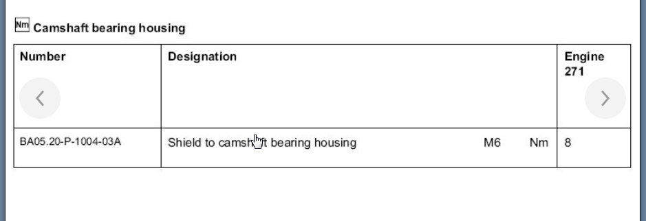

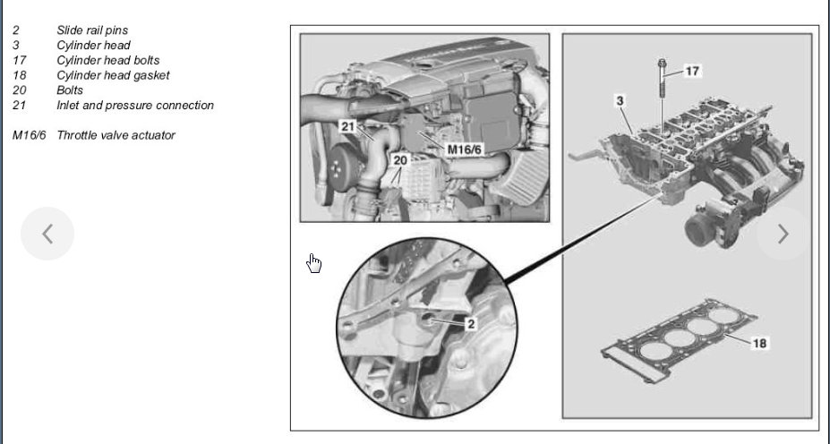

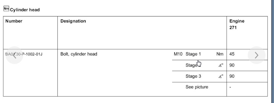

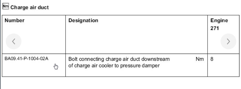

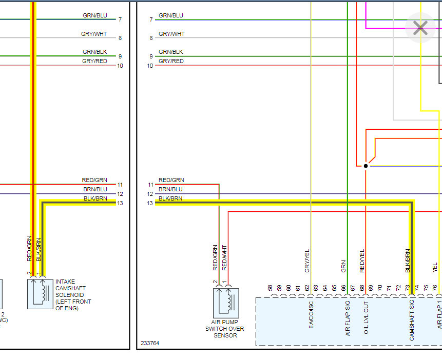

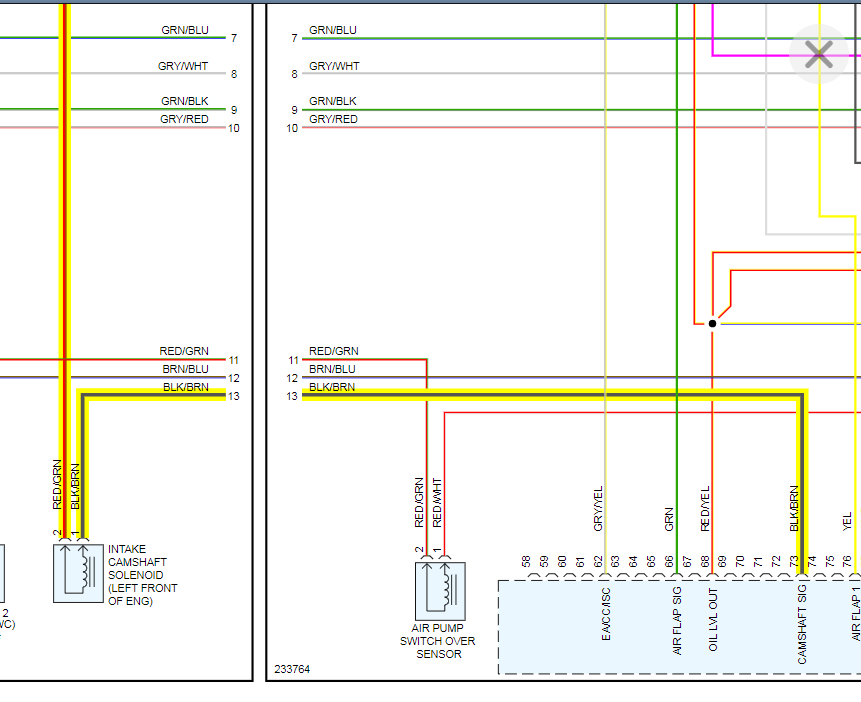

It’s the Y49/1 intake camshaft open circuit, but it turns out it does need a new head gasket and I’m going ahead and replacing the timing chain and tensioner along with camshaft magnets due to them being covered in oil poorly. What else would be good to do as well? I’m hoping it didn’t jump time and bend any valves, but if so is there any documentation on those repairs as well?
Thank you very much for a fast response and your help
Jul 22, 2019 at 2:09 PM

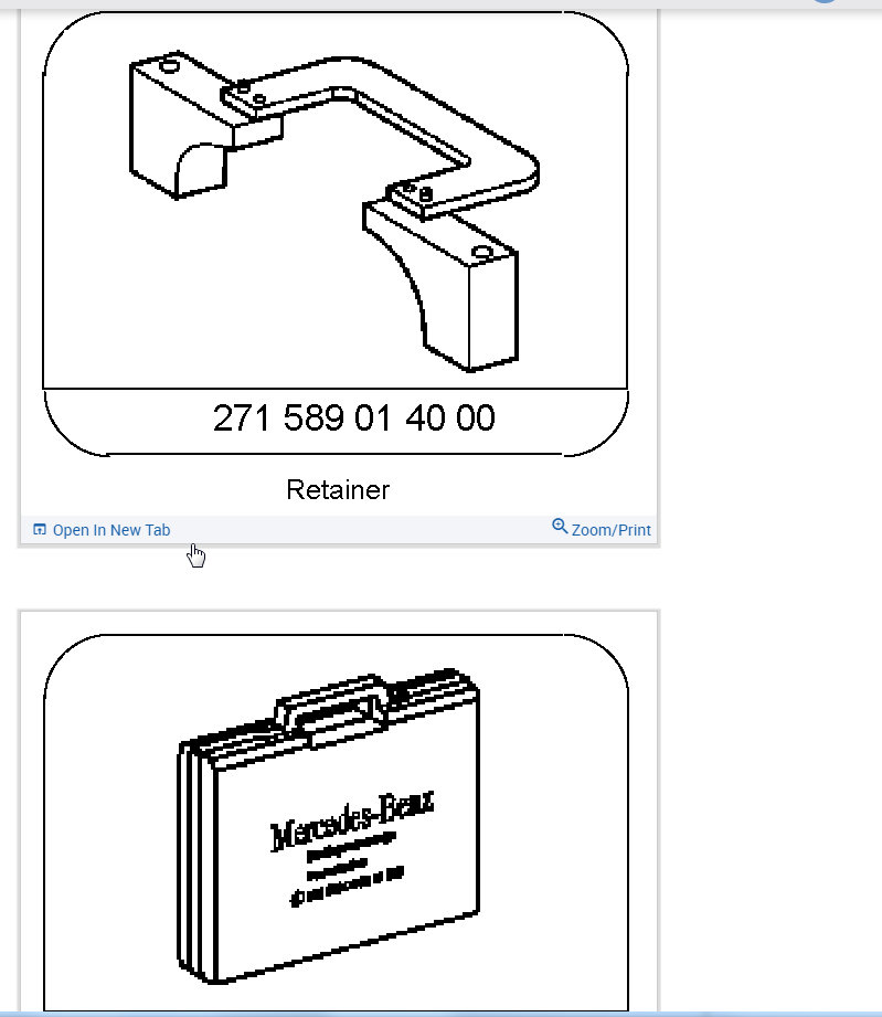

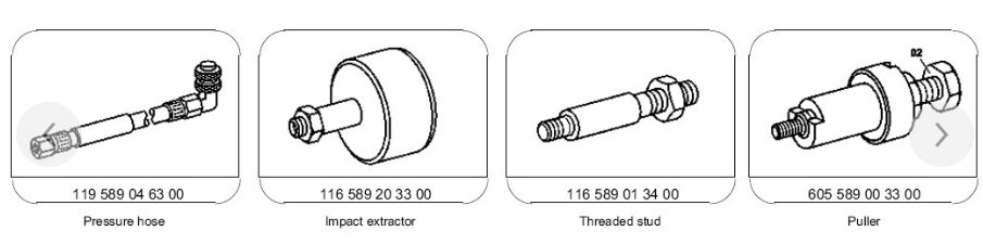

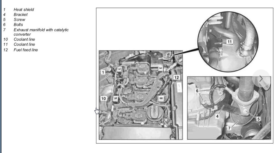

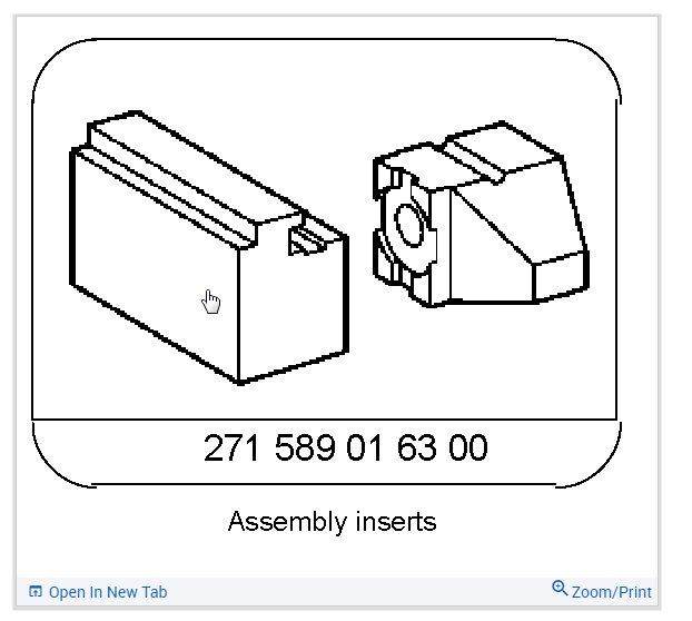

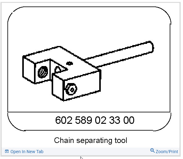

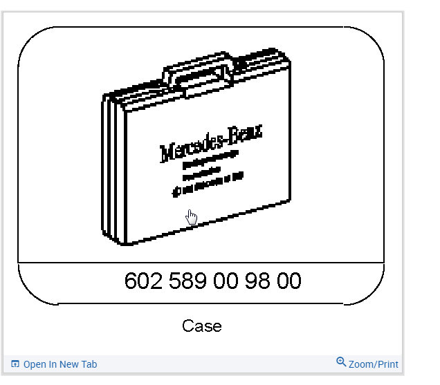

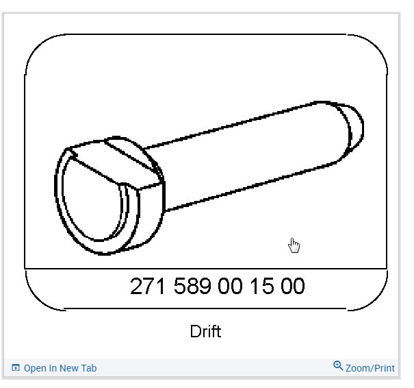

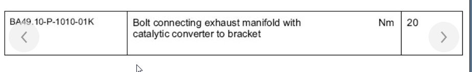

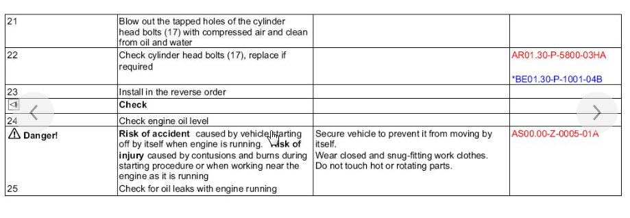

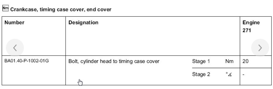

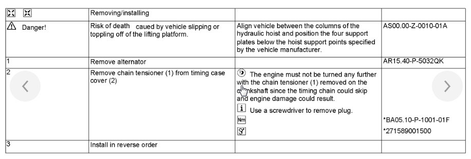

Okay. First of all, this is a circuit issue so just make sure you test the circuit from the ECM to the solenoid for an open.

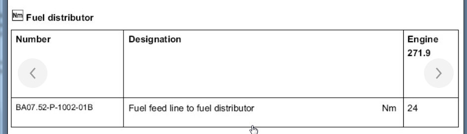

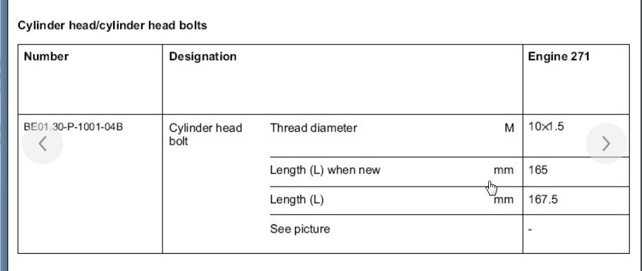

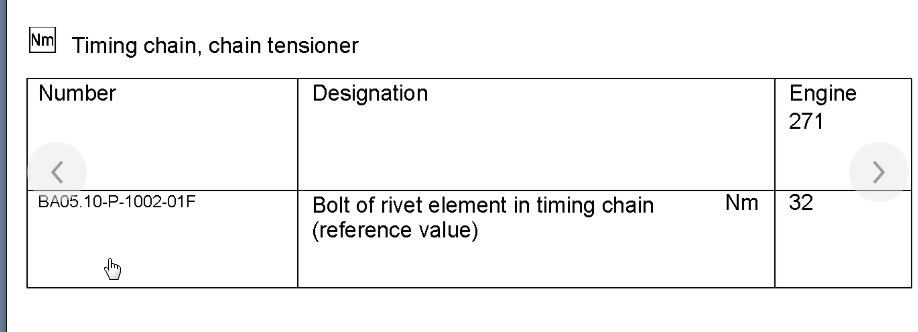

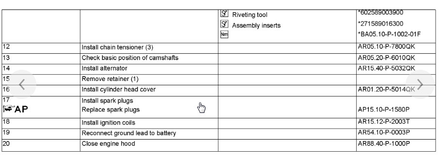

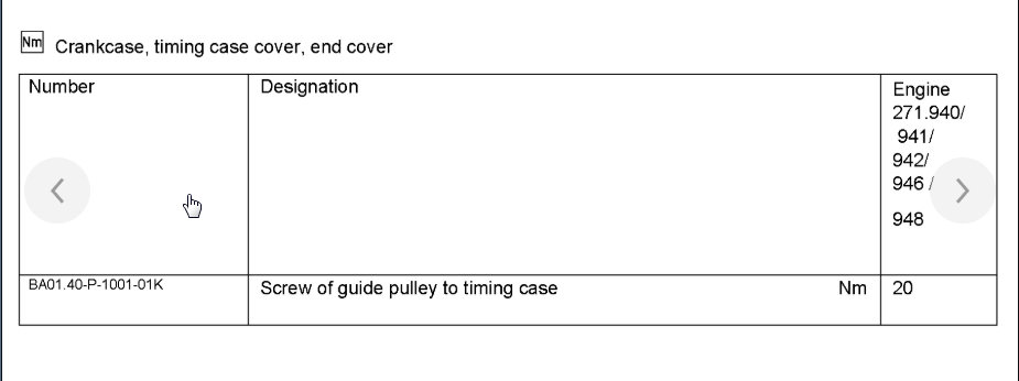

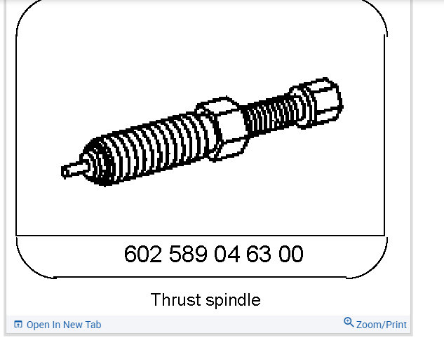

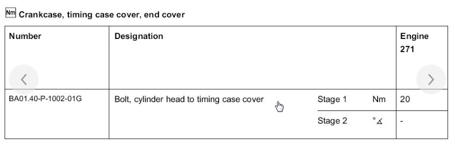

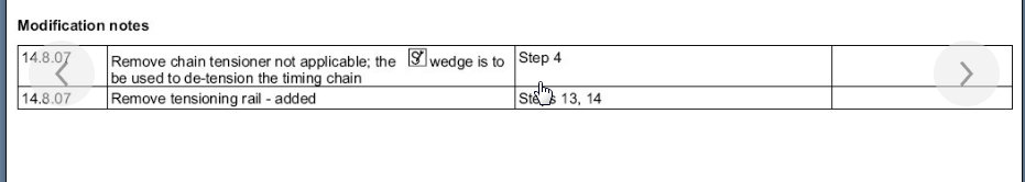

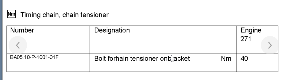

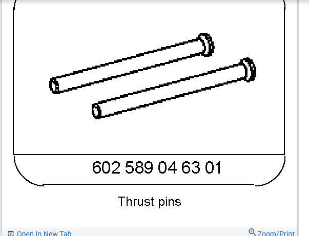

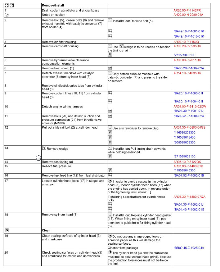

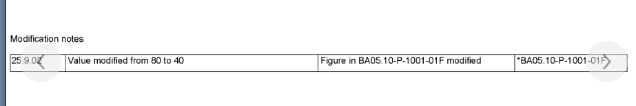

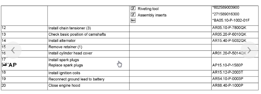

Here is the procedure for the timing chain, tensioner, front cover, and cylinder head/gasket. Some is overlap but it is all there. Unfortunately, MB is not well known for there detail in removing and installing. So some of these things are not step by step.
