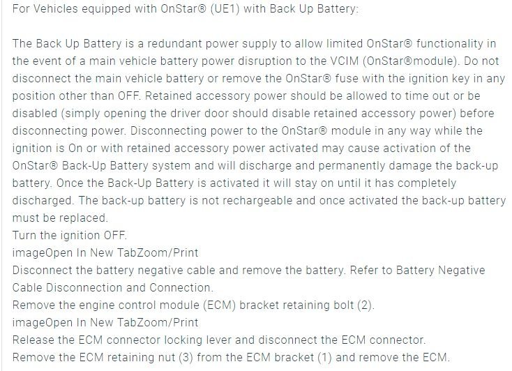

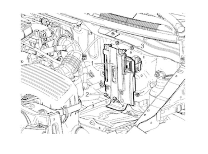

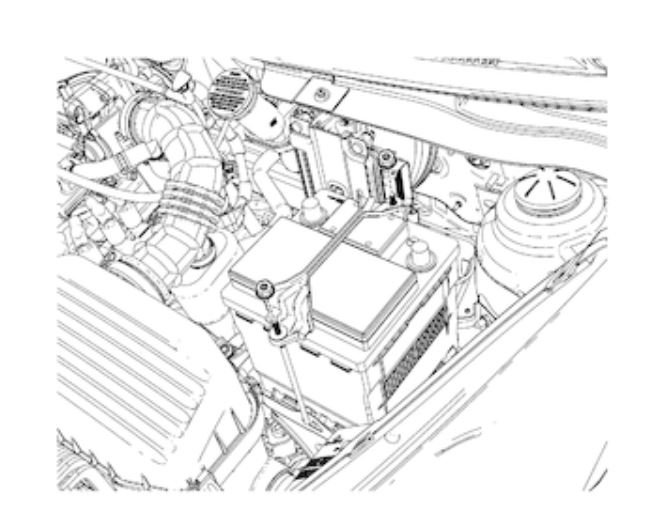

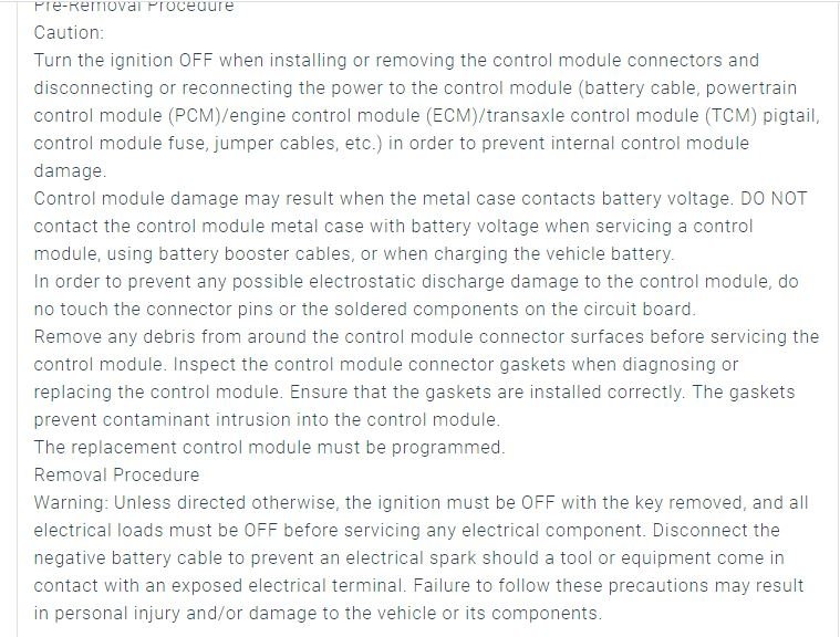

I changed a bad computer and installed a used one from a junkyard after it was installed it would crank but would shut off after about 5 seconds and the only way it would crank again is if I take off the battery post for a minute and then replace it.
Jan 6, 2021 at 6:41 AM (Merged)
Good morning,
Did you have the replacement programmed to your VIN? If you did not, then it will not start and will lock you out.
https://www.2carpros.com/articles/how-a-car-computer-works-pcm-ecm-bcm
I posted the replacement procedure below for you to view. You need to do a security reset as well.
https://www.2carpros.com/articles/how-to-reset-a-security-system
