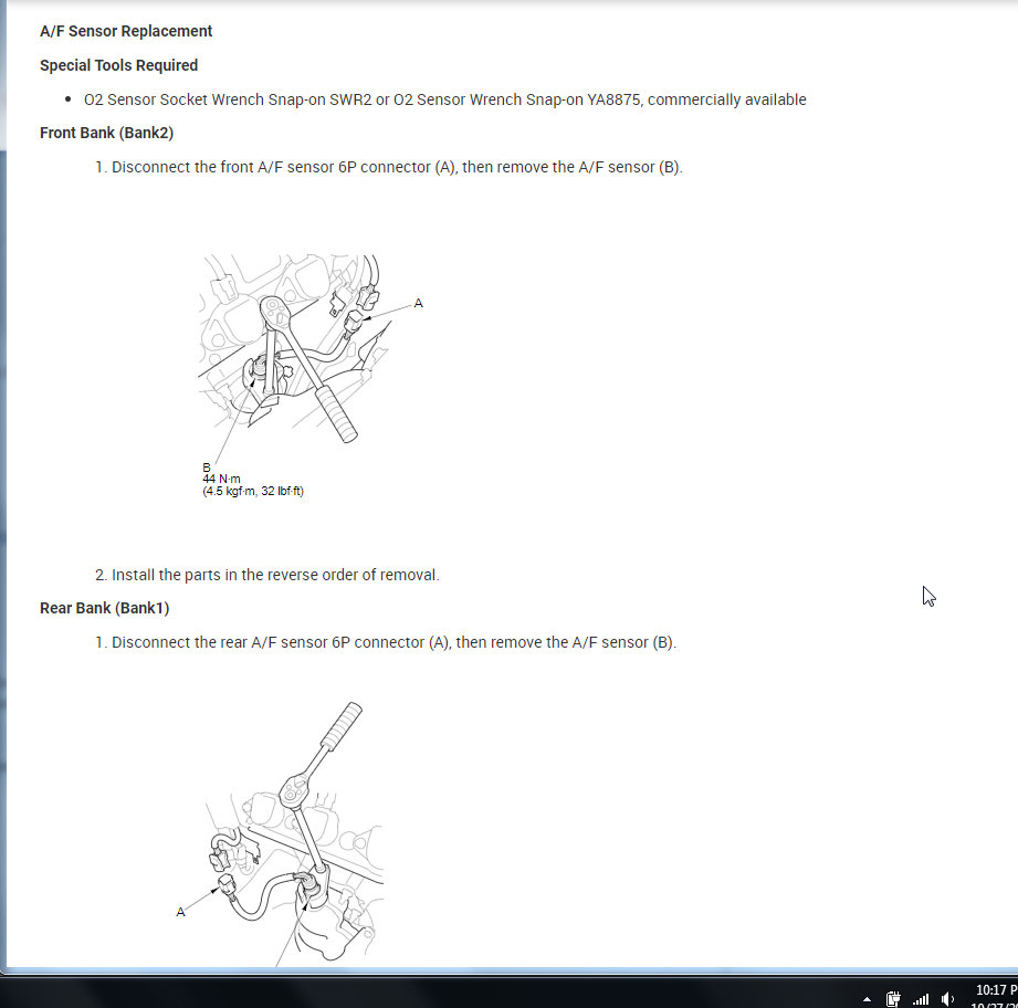

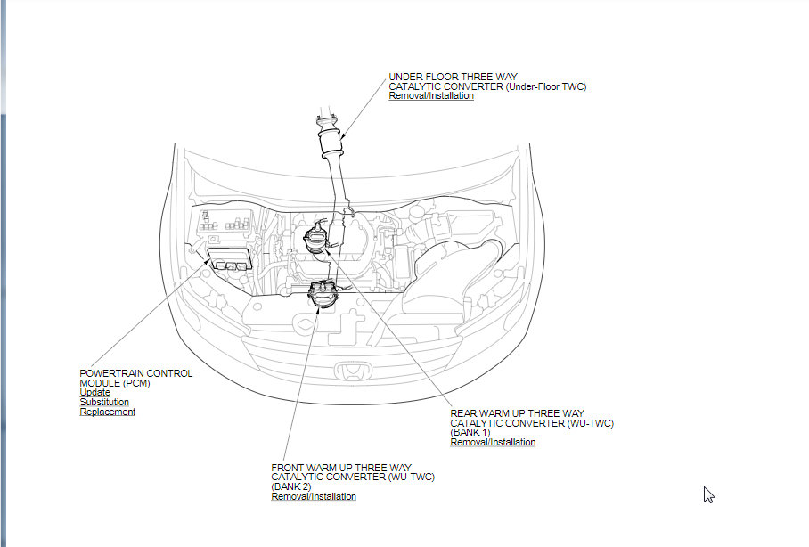

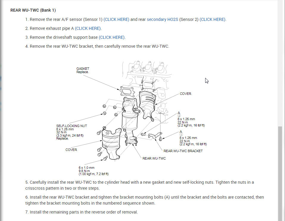

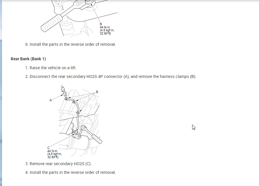

How many oxygen sensors and catalytic converters does this car have? Can you please provide a diagram of their locations?
Cheers!
Thank you!
Oct 27, 2020 at 12:10 PM

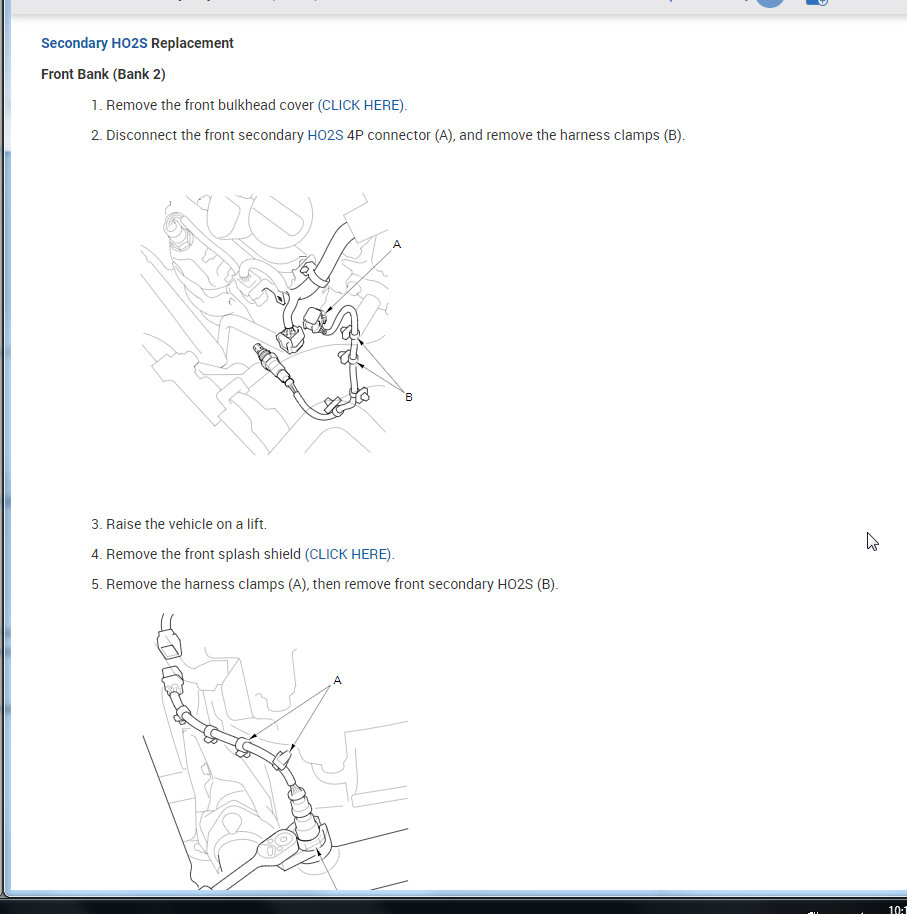

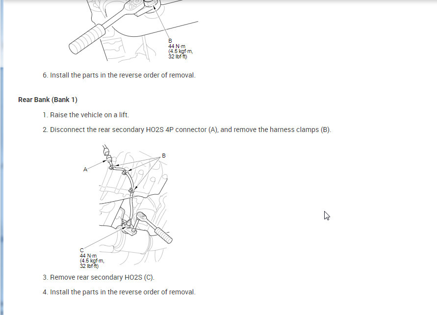

You have two converters. One per bank of cylinders. I included diagrams of this. Also, you have an upstream and downstream sensor for each converter for a total of 4 sensors.

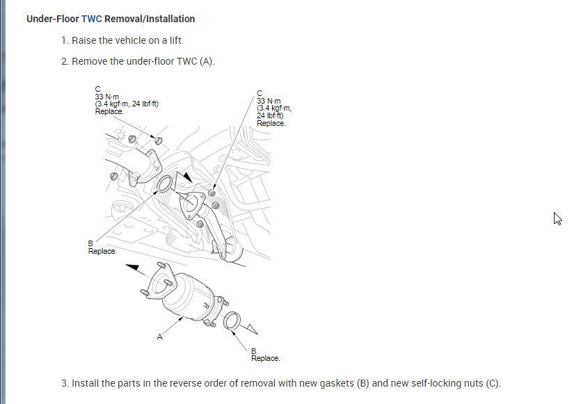

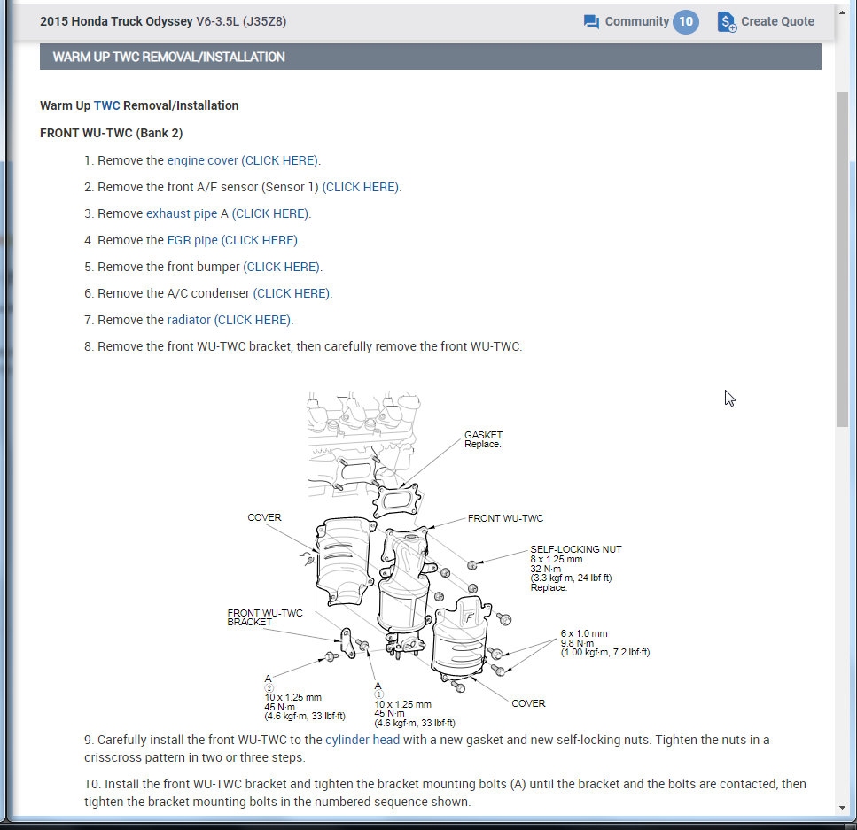

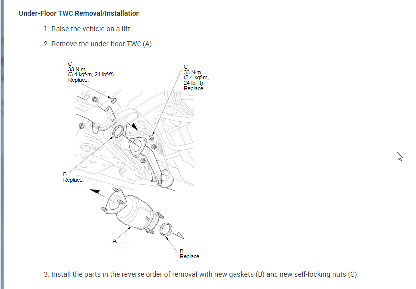

Doesn't the first diagram show a total of 3 catalytic converters? Two in the engine bay and one in the under-floor?
Oct 27, 2020 at 12:52 PM
My mistake. You are correct. Normally the rear and the "under floor" are one unit but it appears they are all separate. The warm up converters (bank 1 and 2) are what the PCM monitors and uses to adjust air fuel ratios. The underfloor converter is just there are adding reduction in emissions. Notice how the underfloor does not have o2 sensors. That means it is not monitored so if you are having an issue with a code, the front two are going to be where the issue is.
