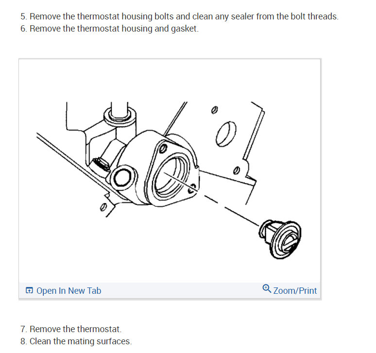

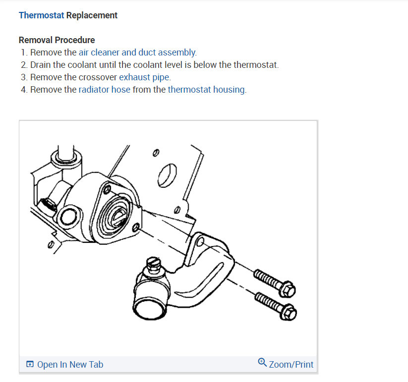

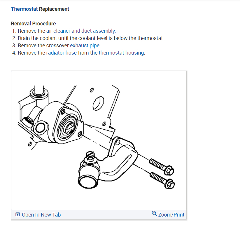

I would also recommend replacing the thermostat as well since it has overheated.
