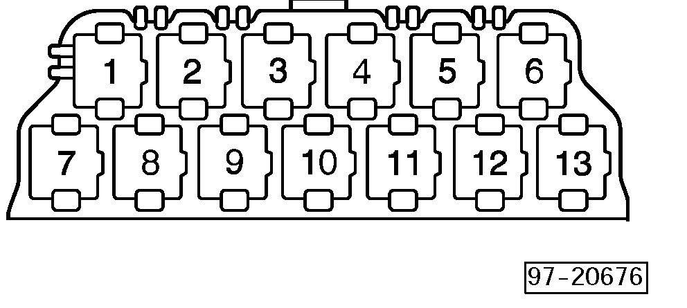

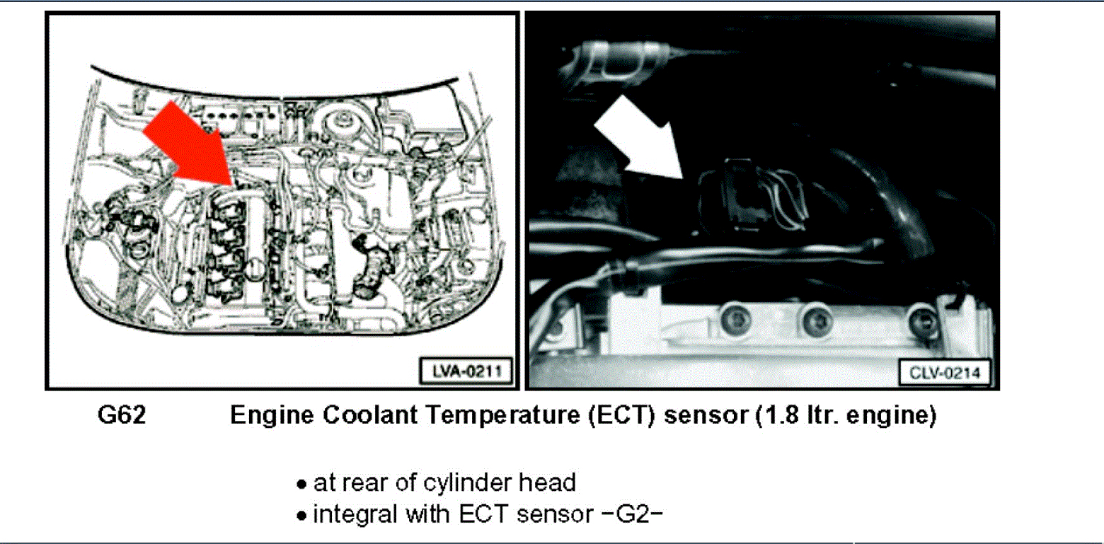

doesn't overheat when sit idling, until you start to drive. replaced coolant temperature sensor, thermostat. no leak in hoses but still overheating. what to check next with images please? how to check fuses or relays this car is continuing with no diagram of where components are exactly? so relay check next or how to check high speed fan ? not turning on and is there another sensor by radiator to check if so where is it? oh yeah heater core was already bypassed, car was bought off a tow yard? guess this might be why it was there. hu? money pit or easy fix? Help!

As far as the cooling fan relay, here is the location info that I have.
RELAY LOCATIONS
Relay location on the thirteen position auxiliary relay panel, above relay panel:
Thirteen Fold/Position Auxiliary Relay Panel
See pic 1
1 - Coolant Fan Control (FC) Relay (214) (a)

As far as a temp sensor, the only one is on the engine (rear of head).
See pic 2
