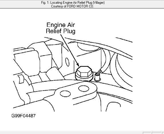

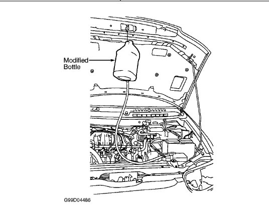

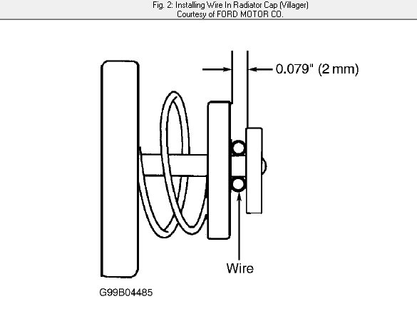

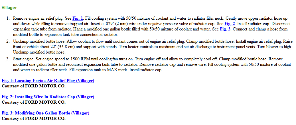

Sounds like air trapped inside the cooling system, as a first step check and correct the coolant level and perform coolant bleeding.

Check the diagram and the procedure below how to bleed the coolant system.
