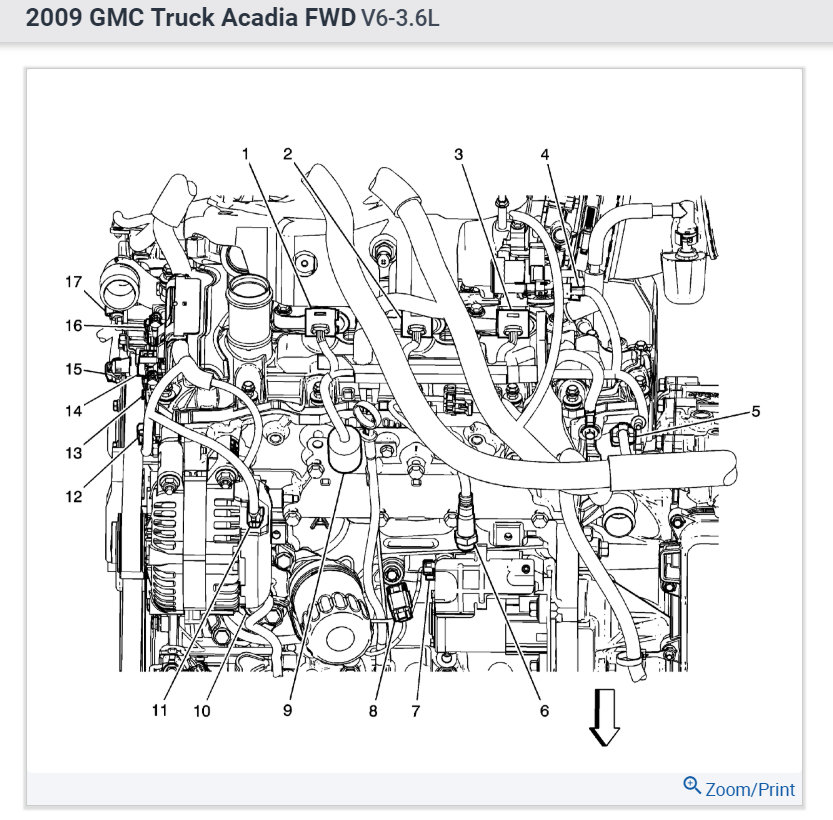

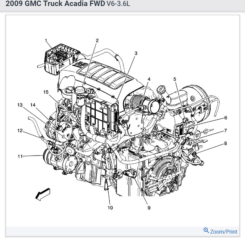

JUNG
I had the same problem with my Acadia 2009 I replaced the engine coolant temperature sender and it fixed it. Here is a guide and a diagram below to help you see how:
https://www.2carpros.com/articles/coolant-temperature-sensor-cts-replacement
Cheers
