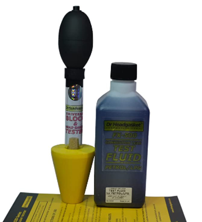

overheats and seems to have cooling system build up with pressure.
Apr 24, 2022 at 7:38 PM
BORIS K
  • 836 POSTS
Engine overheating and increased pressure in the cooling system usually point towards leaking cylinder head gaskets
I suggest doing a chemical block test.
How to.
https://youtu.be/riF5hdhz0wM

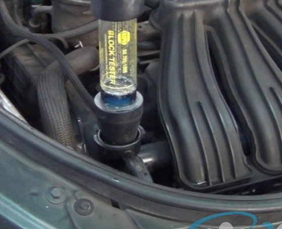

Also see images below
If the liquid of the block tester changes color this will indicate the presence of carbon monoxide in the coolant. This will then point towards leaking cylinder head gaskets or a possible cracked cylinder head. The cylinder heads will need removing and a suitable engineering shop should then check these for possible warped surfaces and do a pressure test to check if any cracks can be found.
