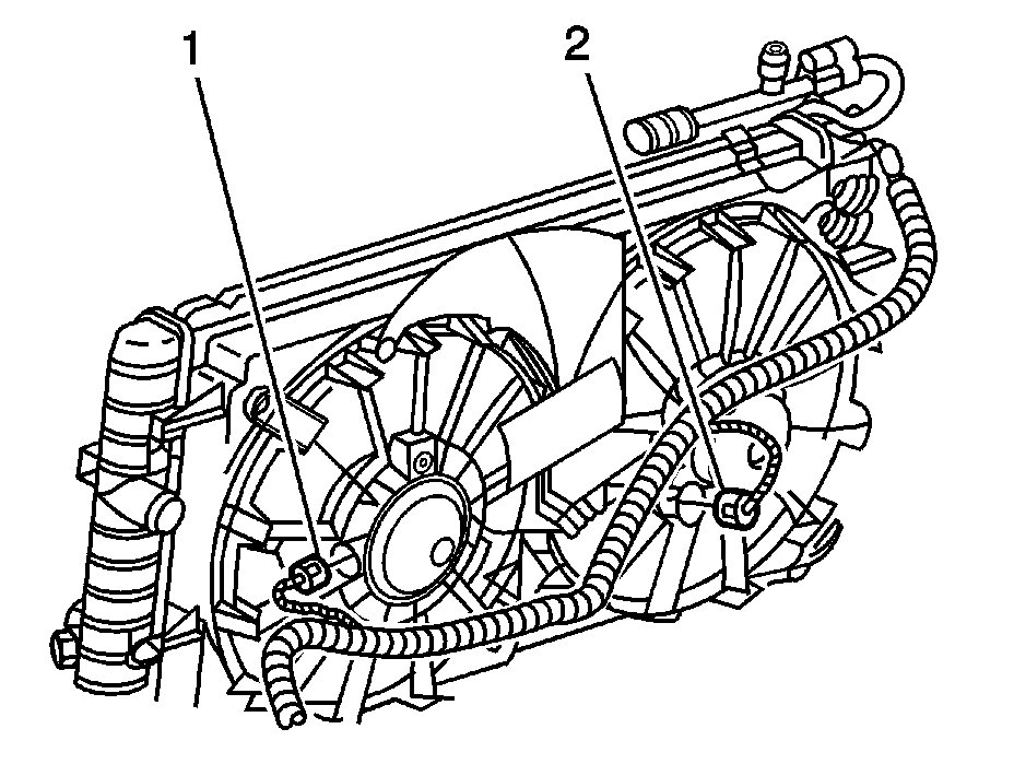

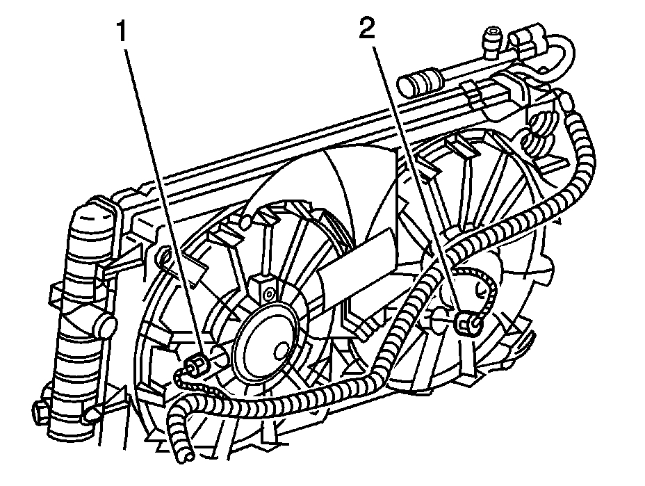

The car listed above is a GT. I recently purchased the vehicle and noticed it was running to hot especially when I was coming to a stop or left it at an idle. Neither cooling fan 1 or 2 was turning on. so I replaced the coolant temperature sensor, flushed and drained the radiator and jumped the fans as well. The fans still aren't cutting on and now the transmission seems to be shifting hard after I drained the radiator and changed the sensor. So if anyone could point me in the right direction I would greatly appreciate it.
Feb 26, 2021 at 11:53 PM
  • 110,240 POSTS

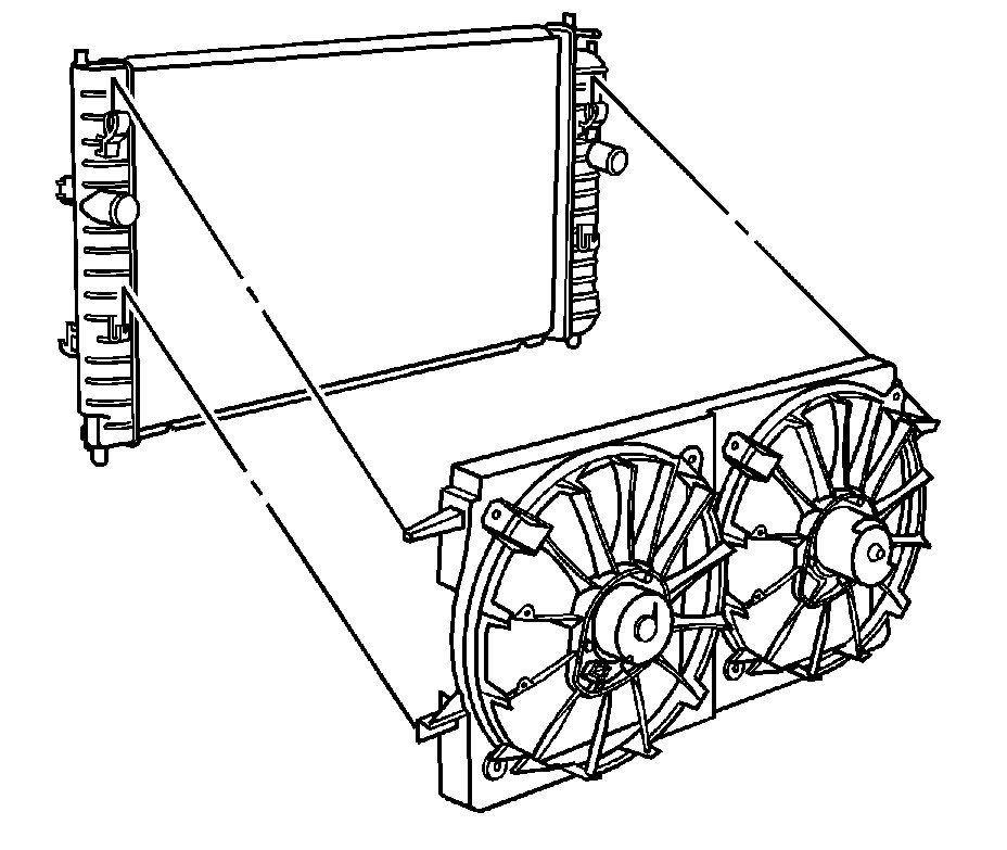

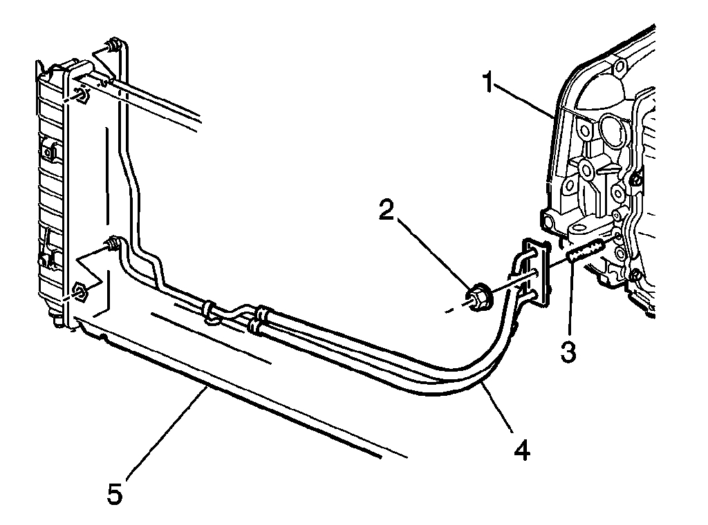

It sounds like the cooling fans are the cause of it running hot. If it only happens when at a stop or slow speeds, that is the likely cause.
Now, you mentioned that you jumped the fans and they didn't work. By that, do you mean you ran power directly to them? If that is the case, the fan motors must be bad. If you put power directly to them, they should work.
Here are the directions specific to replacing them for your vehicle. The attached pics correlate with the directions.

pic 1

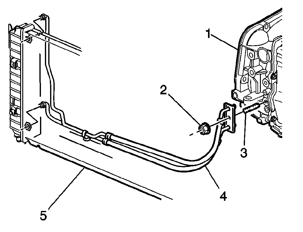

1. Remove the upper transaxle cooler line from the radiator ONLY.

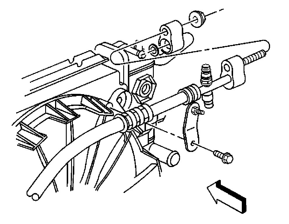

pic 2
2. Remove the discharge hose to cooling fan shroud bolt ONLY.

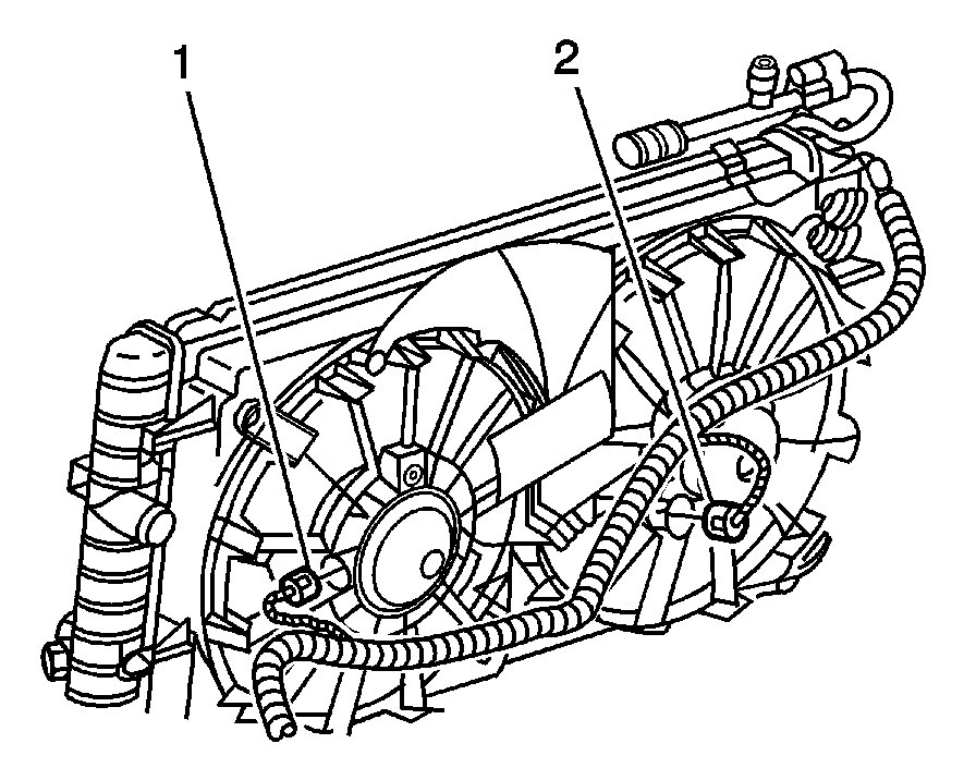

pic 3

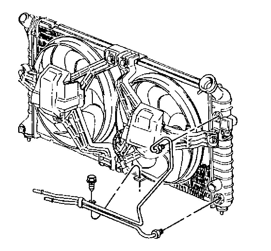

3. Disconnect the cooling fan electrical connectors.

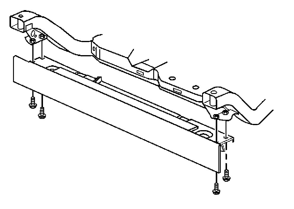

5. Remove the lower closeout panel.

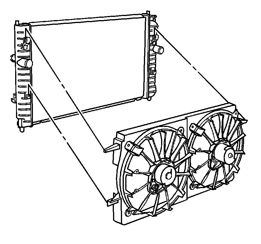

pic 4

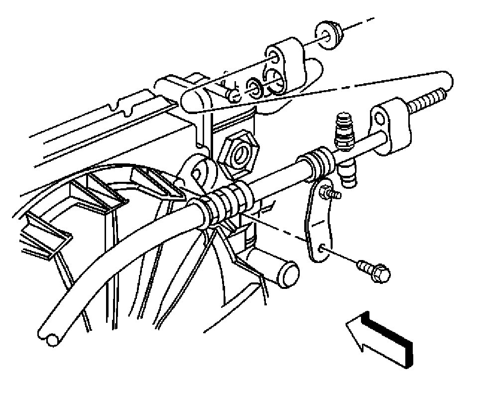

6. Remove the lower transaxle cooler line from the radiator.

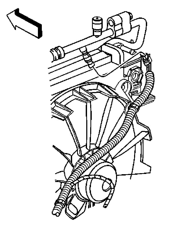

pic 5

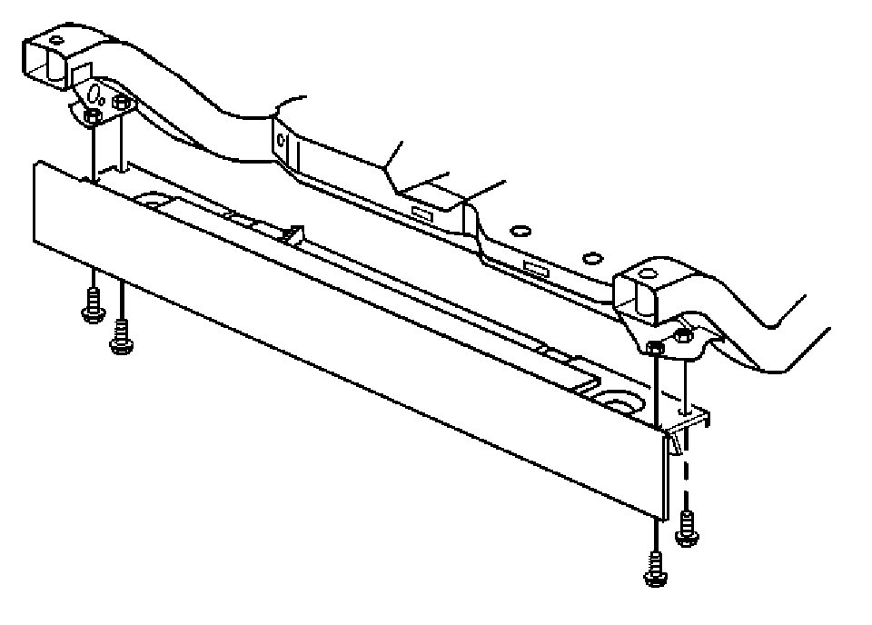

7. Remove the lower radiator support mounting panel.

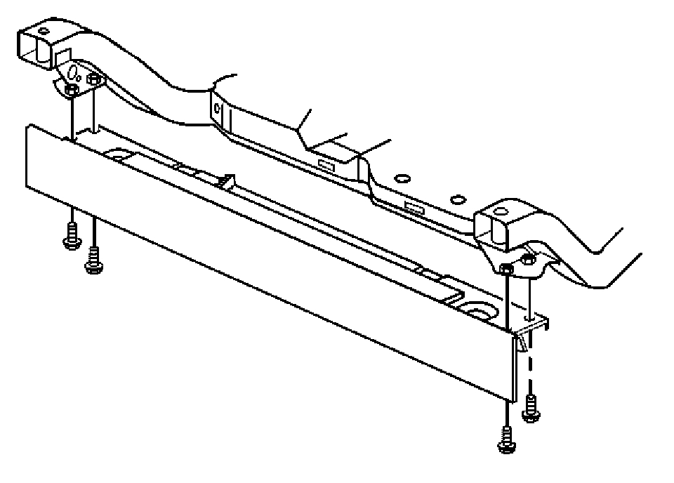

pic 6

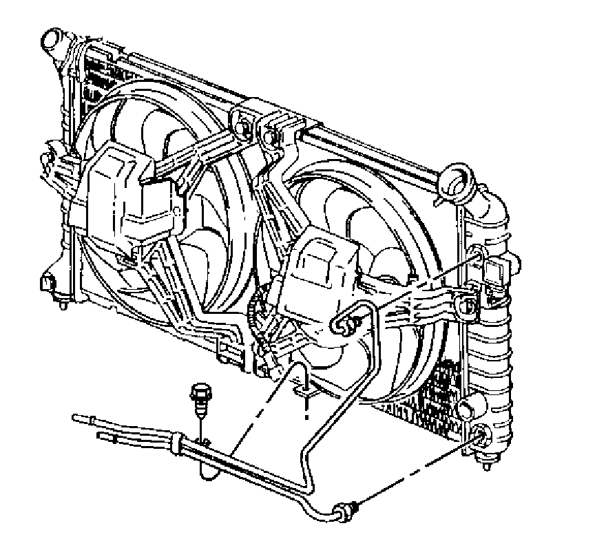

8. Reposition the transmission oil cooler lines away from the fan shroud.
9. Push up on the cooling fan to remove the cooling fan shroud from the radiator.
10. Remove the cooling fan from the bottom of the vehicle.

1. Install the cooling fan from the bottom of the vehicle.
2. Install the cooling fan shroud to the radiator.
3. Pull down on the cooling fan to snap it onto the radiator.

4. Install the lower radiator mounting panel.
Tighten the bolts to 10 N.m (89 lb in).

5. Install the lower transaxle cooler line to the radiator.
Tighten the fitting to 30 N.m (22 lb ft).

6. Connect the cooling fan electrical connectors.
7. Install the lower closeout panel.

11. Install the upper transaxle cooler line to the radiator.
