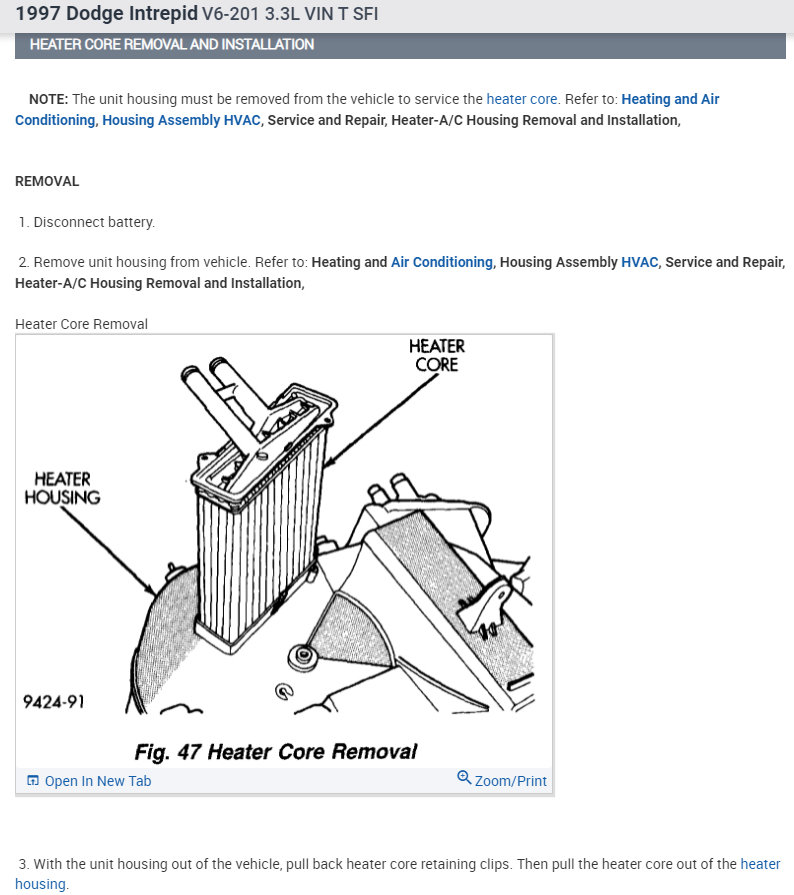

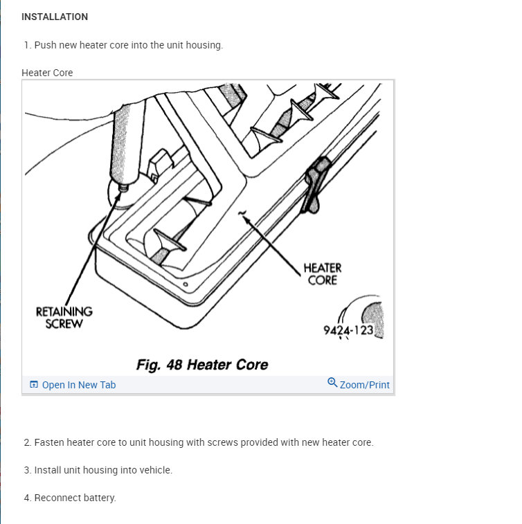

I recently put in a new heater core and an actuator and every time I put new coolant in it, it overheats and blows the coolant out. I've done it twice and it gets hot. Is this just a coincident or what?

It is possible that there is restriction in the line and preventing the coolant from circulating. Which is causing the engine to overheat and blow out coolant.

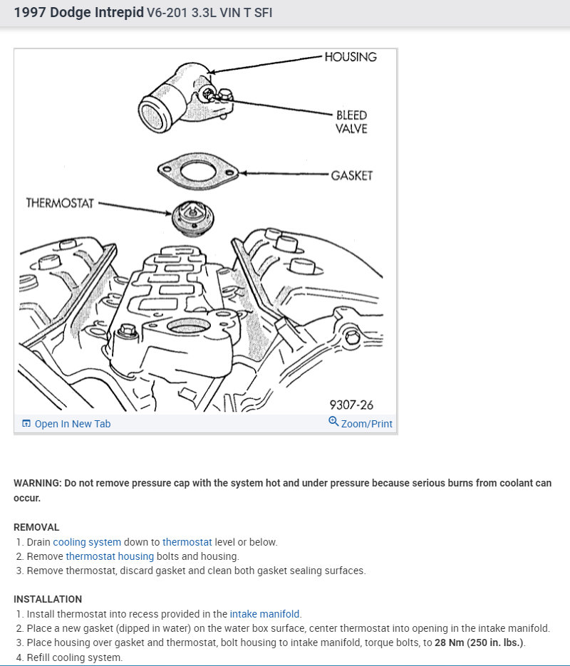

Besides that, the engine can overheat due to a stuck closed thermostat, bad water pump, faulty radiator, inoperative cooling fan.
https://www.2carpros.com/articles/engine-overheating-or-running-hot

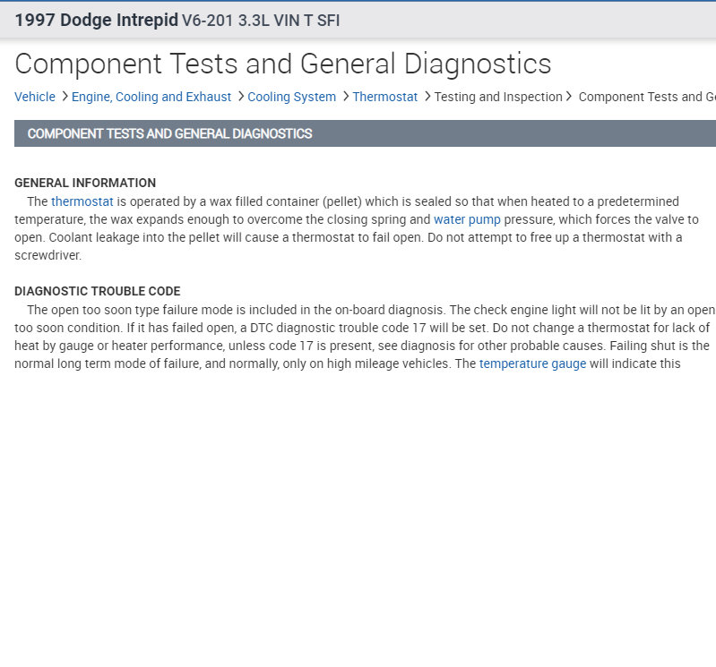

If the thermostat fails at closed position, it will also prevent coolant from circulating and will overheat the engine.
A stuck closed thermostat will have significantly different temperature for the upper and lower radiator hose. One will be noticeably cooler than the other.
https://www.2carpros.com/articles/how-an-engine-thermostat-works
