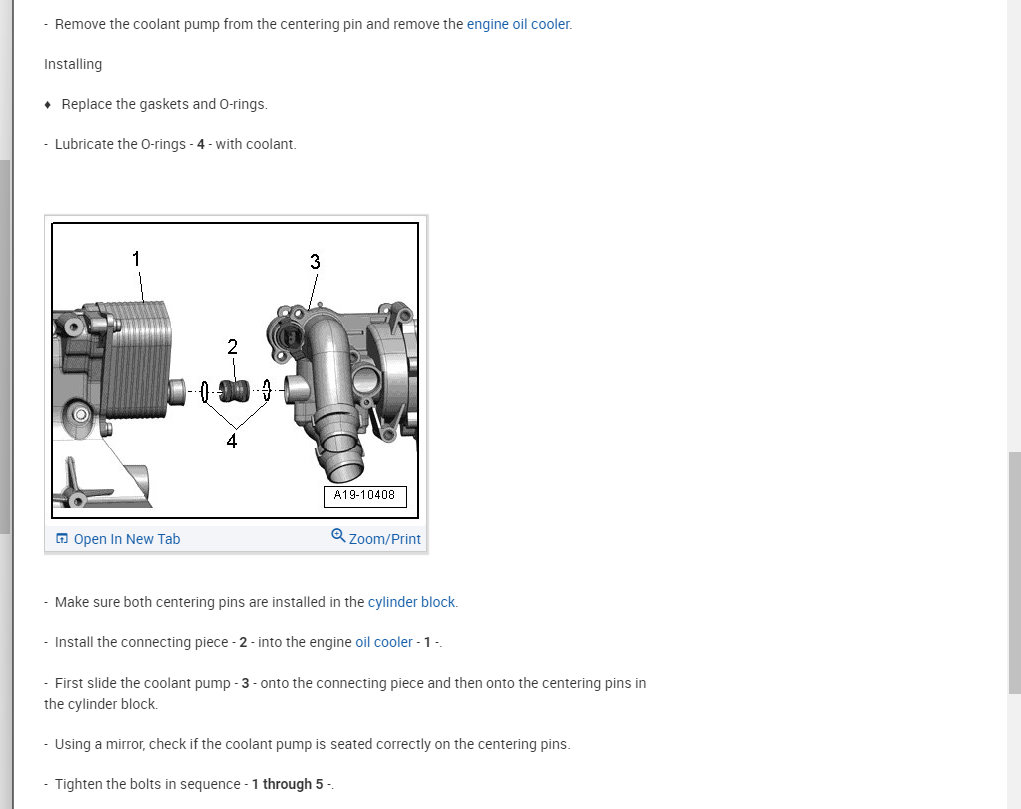

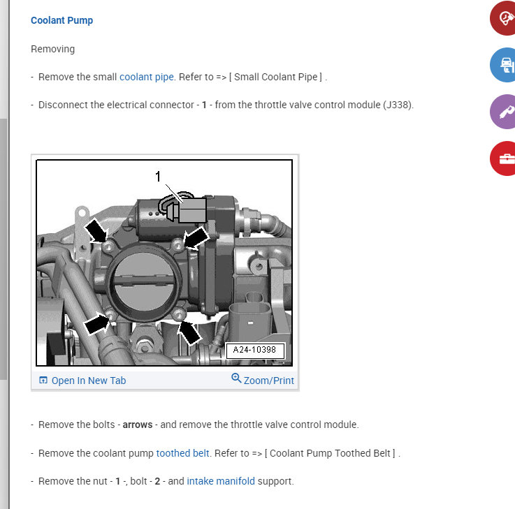

How hard is it to change the internal shaft for water pump?
Feb 22, 2022 at 12:12 AM

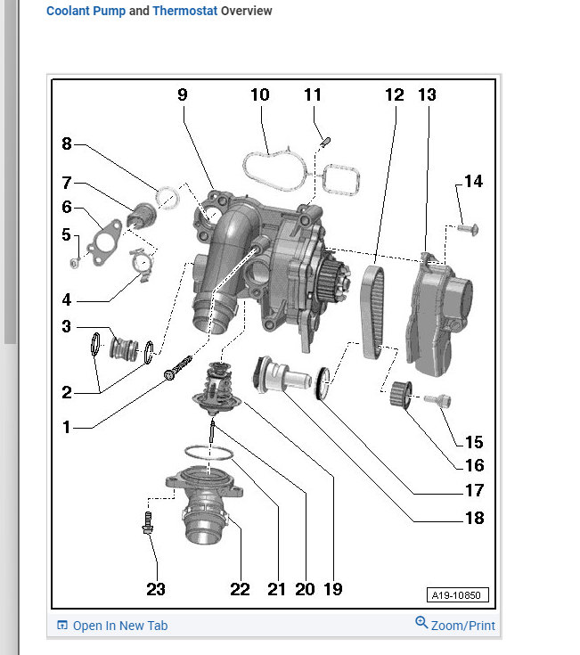

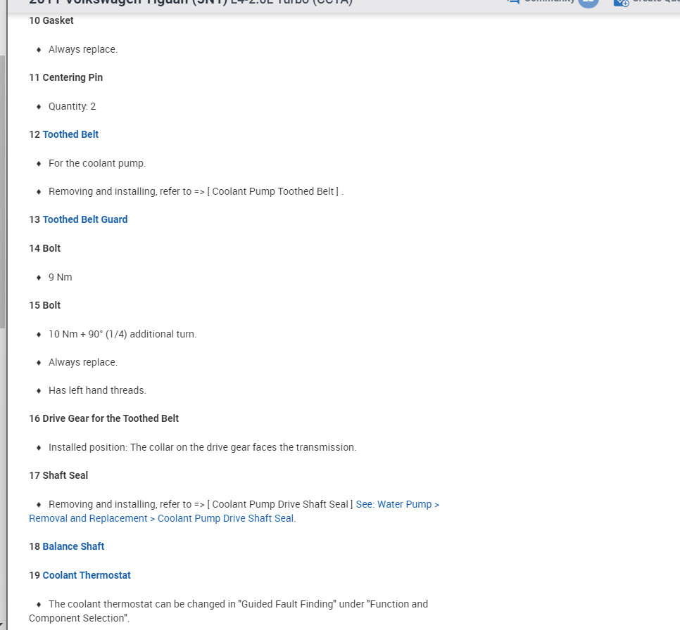

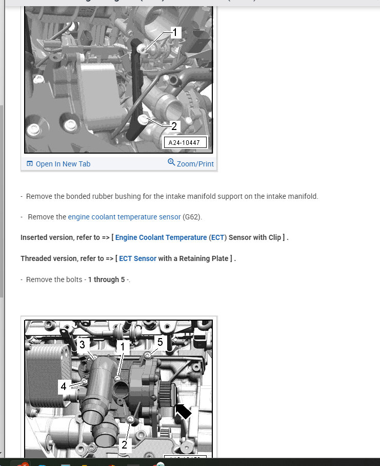

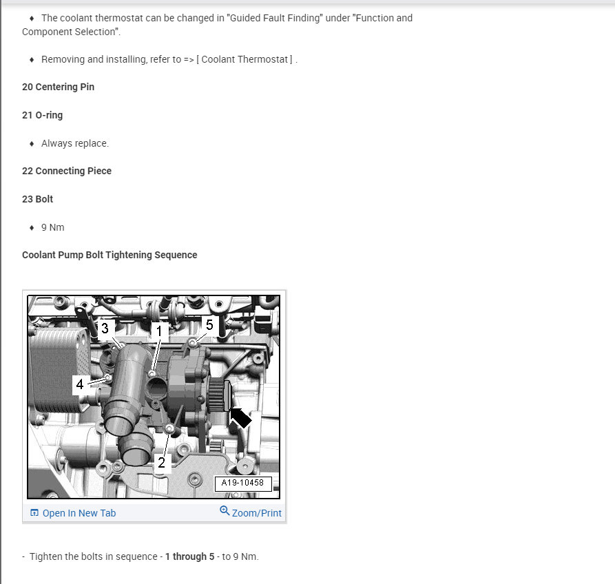

Can you take a look at this diagram? I assume you are looking at number 18.

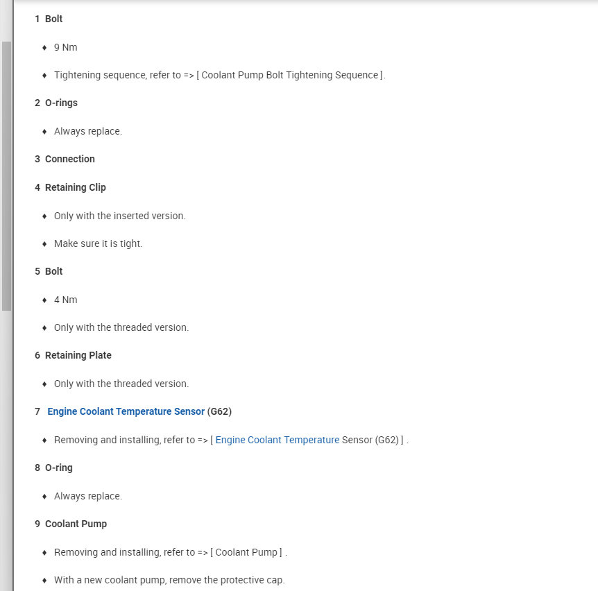

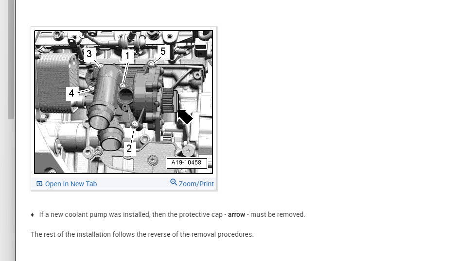

We don't have a process in the manual on how to remove this shaft specifically but instead on how to replace the pump.
I am attaching this process as well for your review.
Also, here are a couple of guides that will help with doing this repair:
