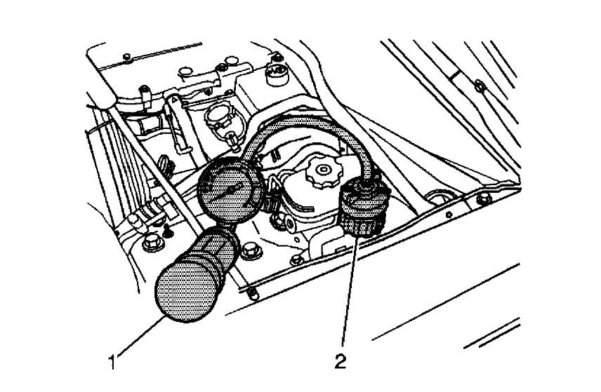

My car begin overheating and I noticed that the overflow tank hose was leaking a lot. Will this leaking hose for the overflow cause my car to overheat?
Feb 21, 2020 at 8:33 AM
Good evening,
If the coolant level in the radiator goes low, yes it can.
https://www.2carpros.com/articles/engine-overheating-or-running-hot

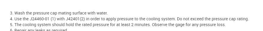

Did you verify the coolant level?
https://www.2carpros.com/articles/radiator-pressure-test

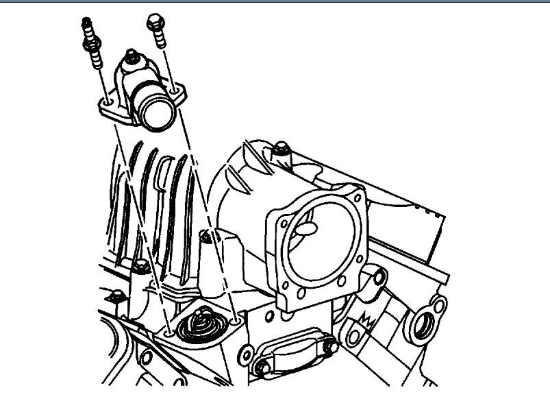

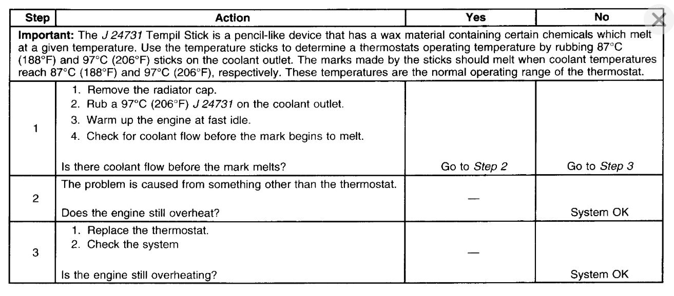

It could be the thermostat. I would replace it to be sure. It is simple to replace.
Feb 21, 2020 at 8:43 AM
