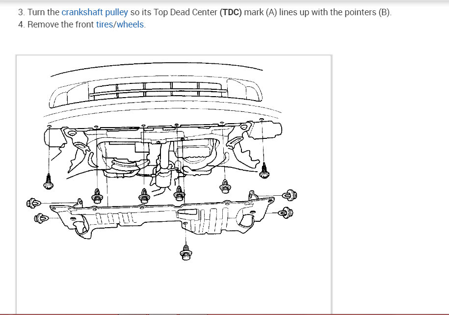

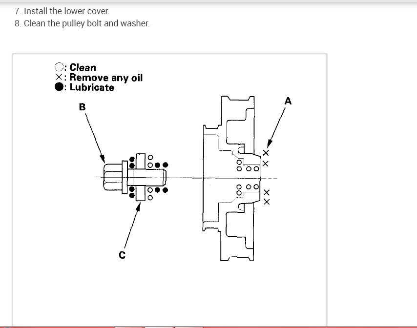

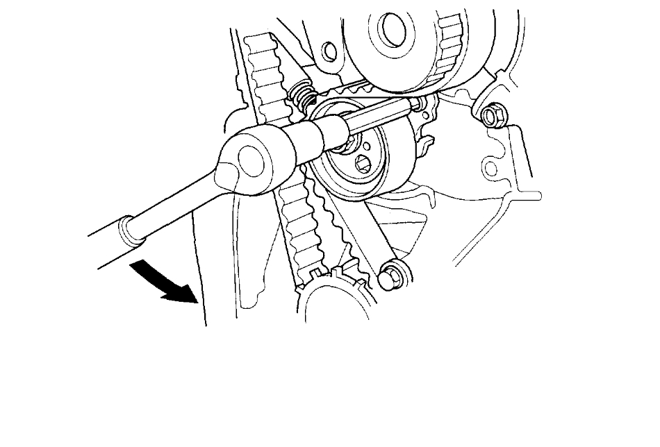

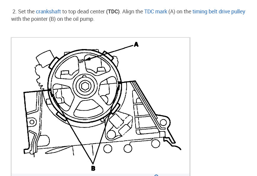

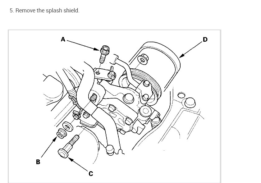

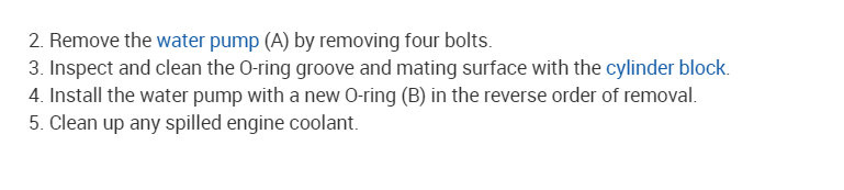

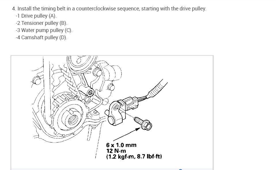

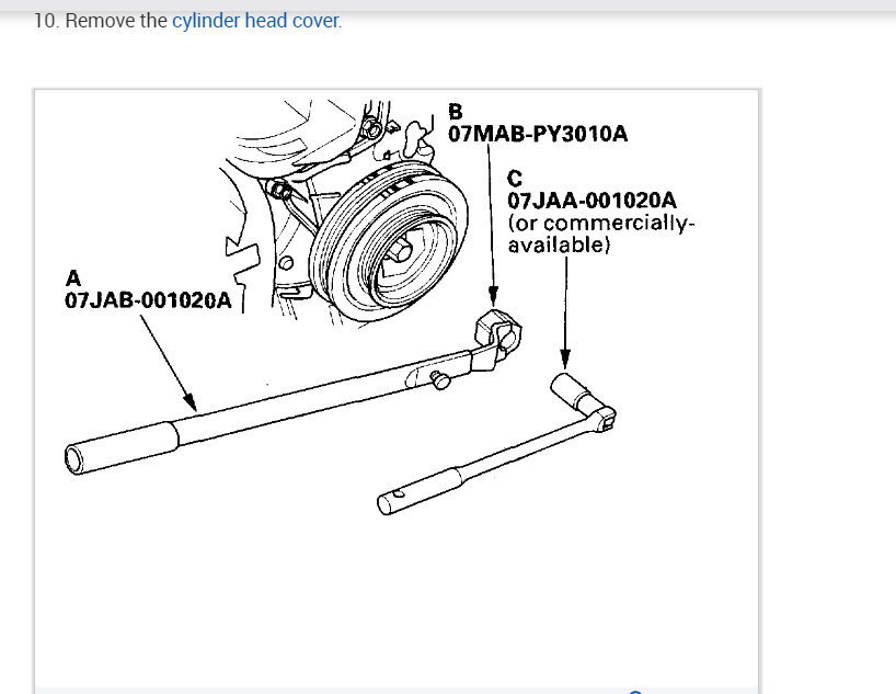

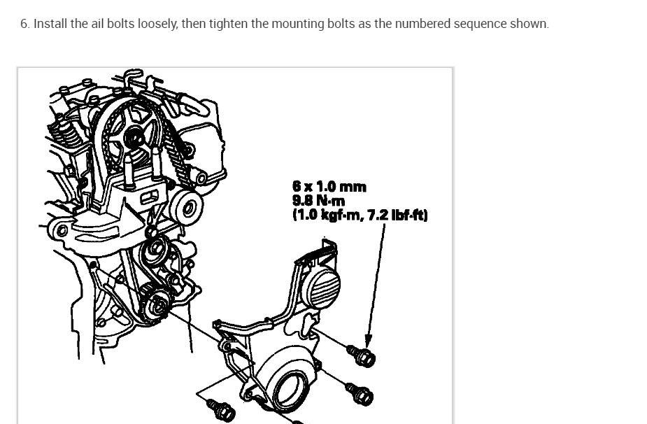

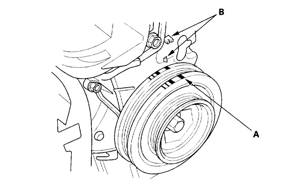

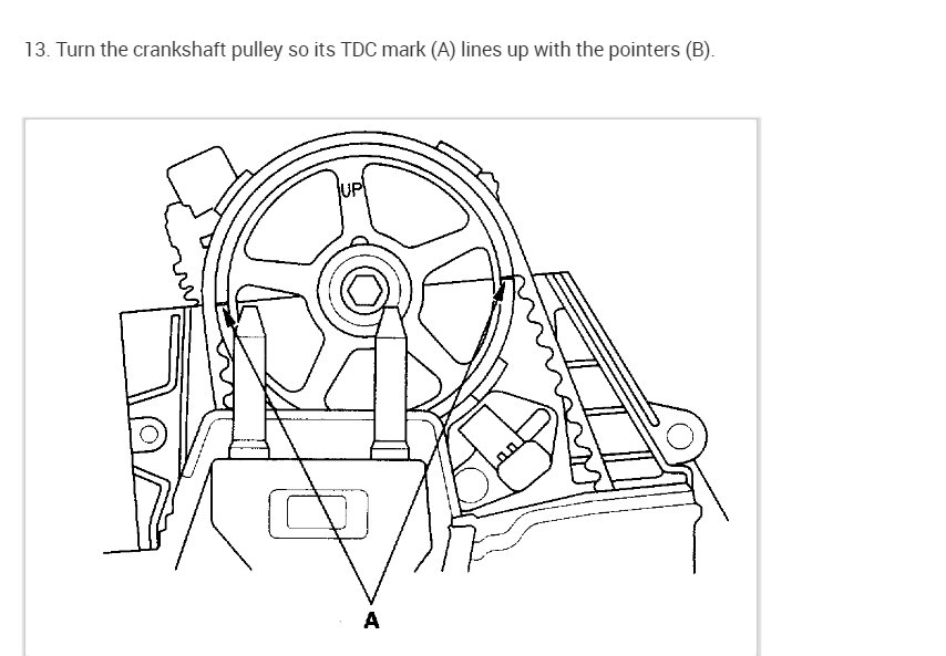

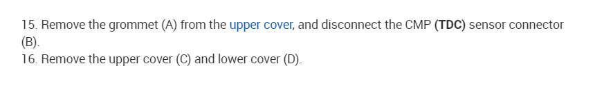

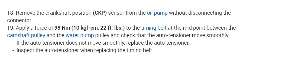

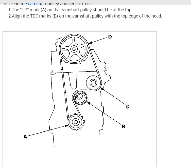

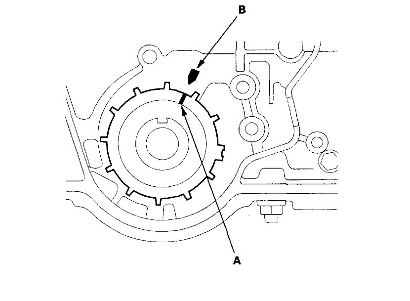

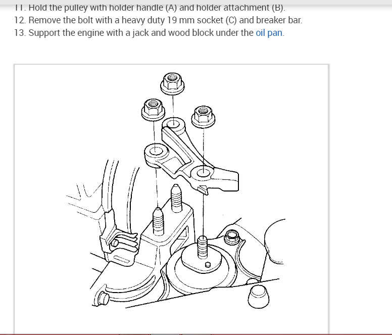

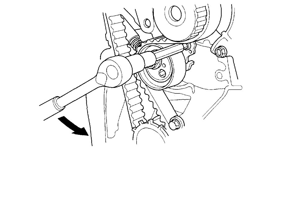

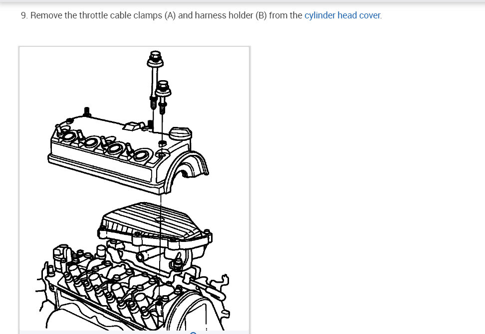

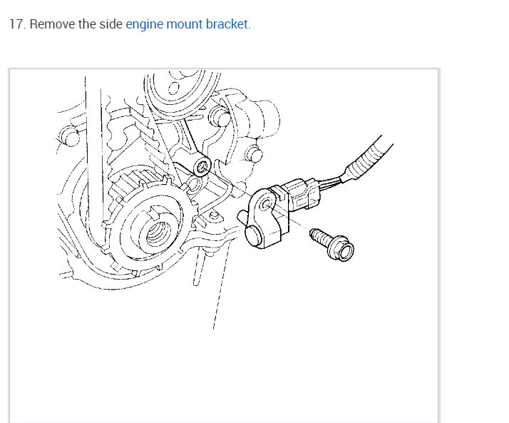

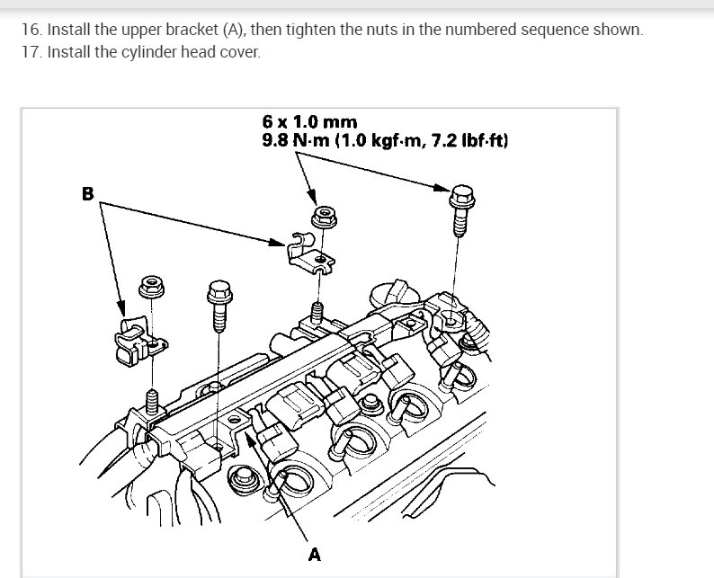

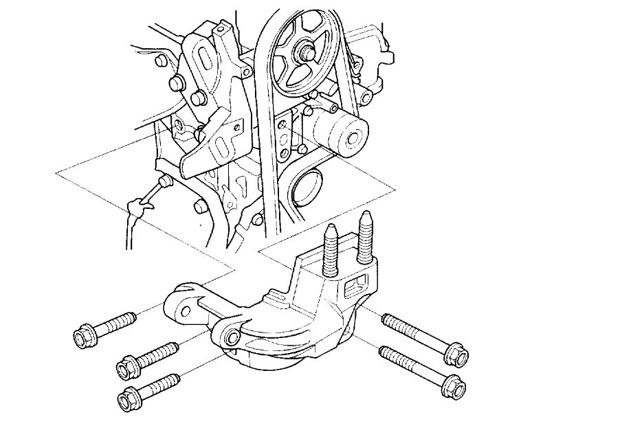

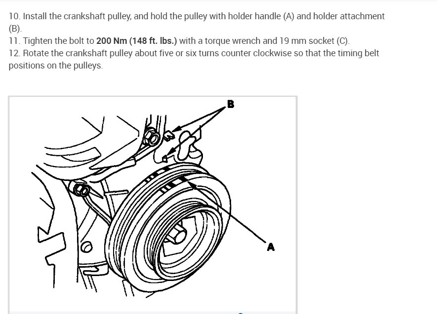

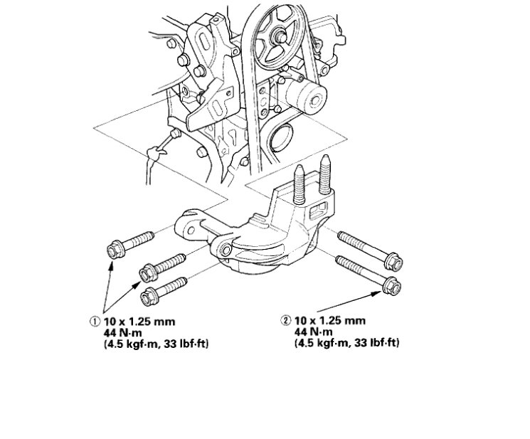

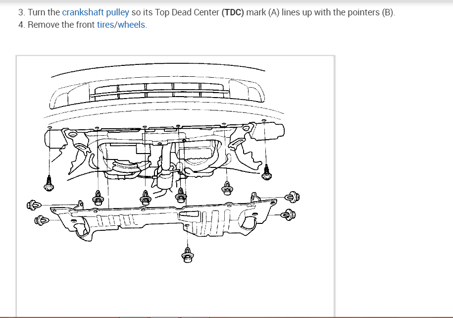

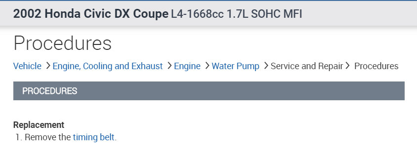

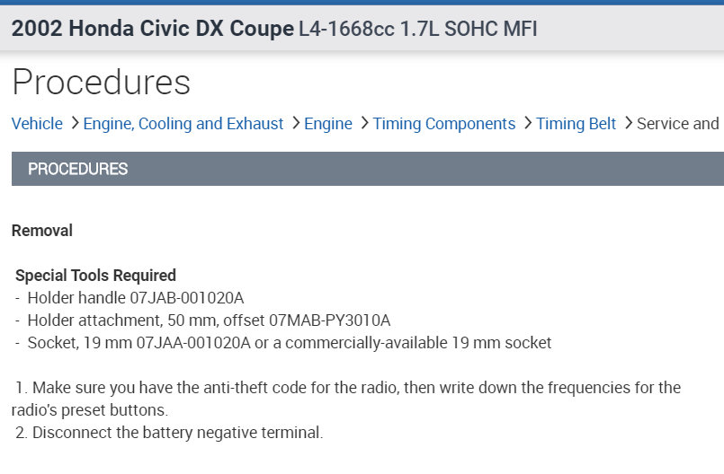

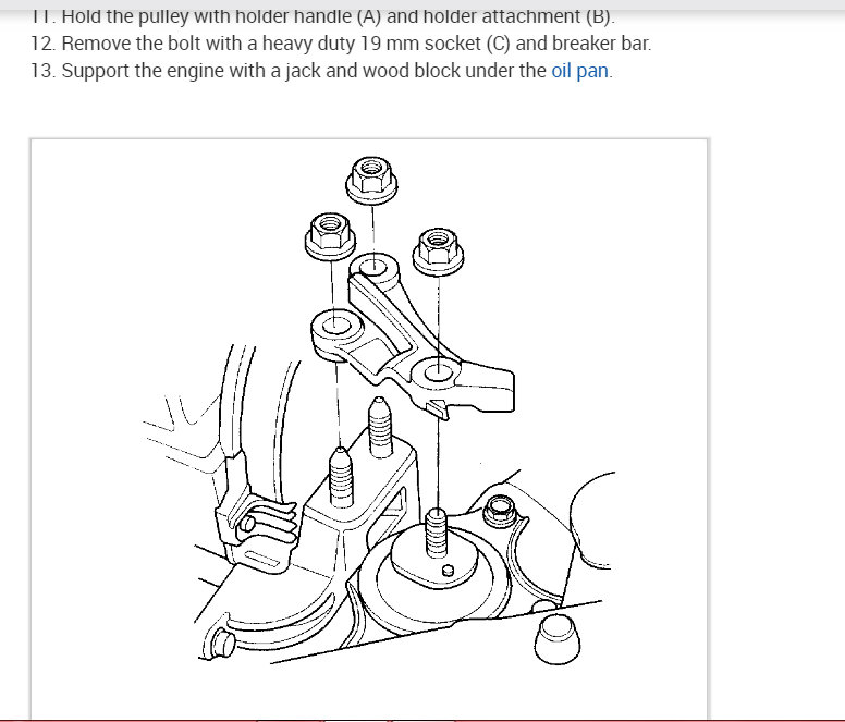

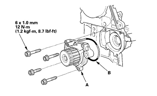

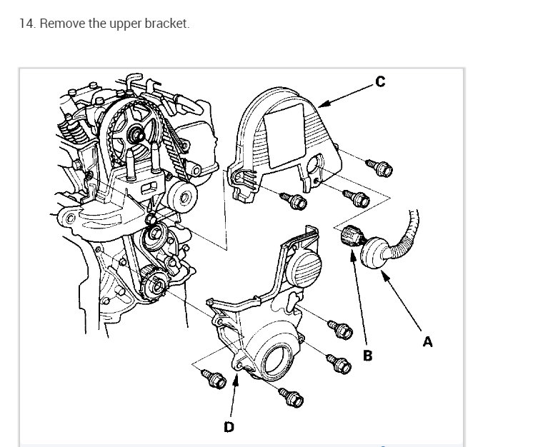

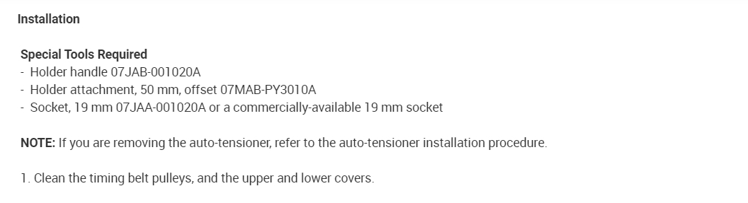

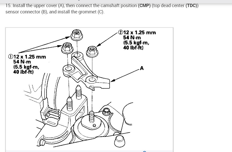

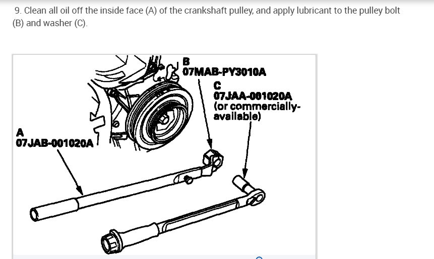

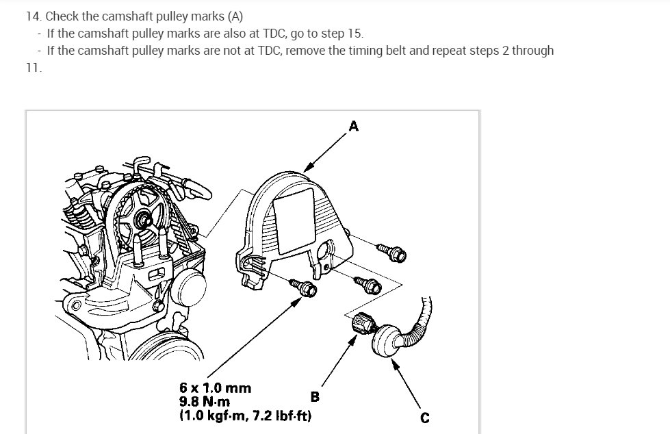

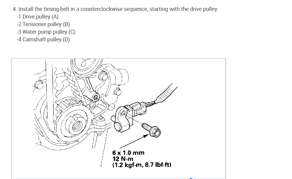

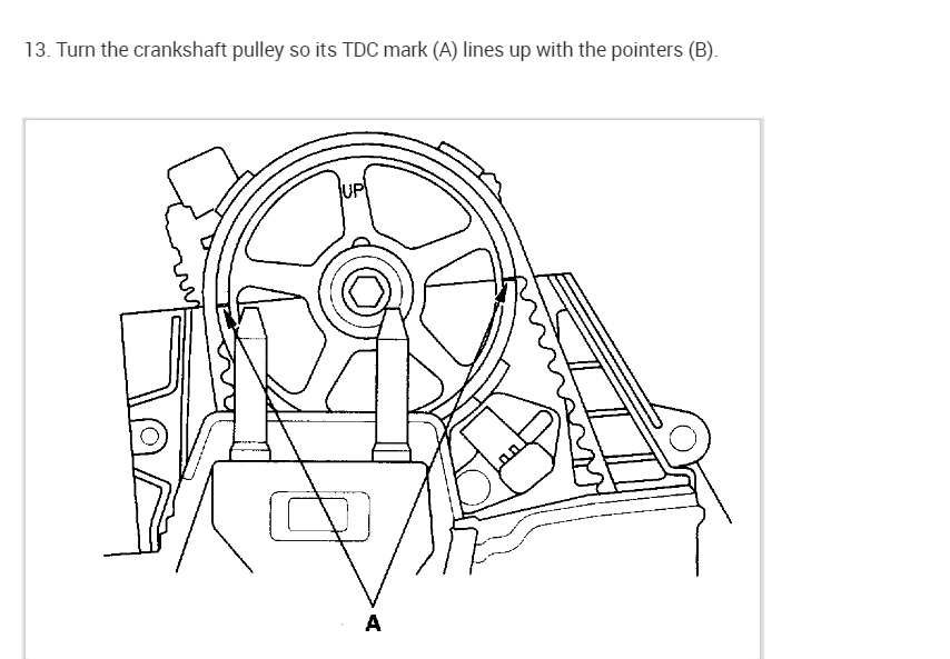

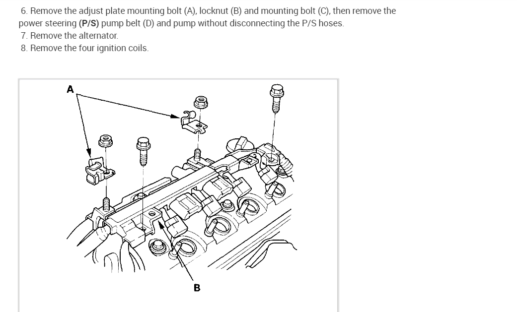

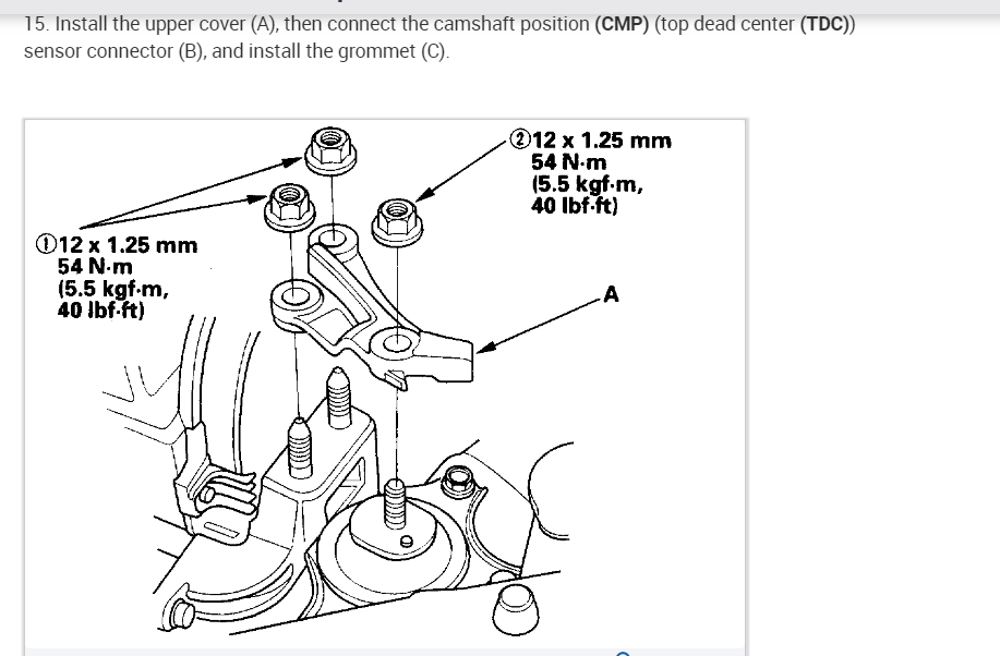

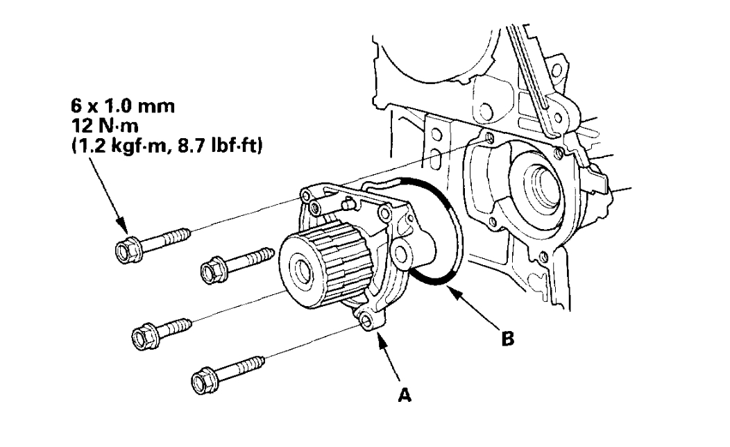

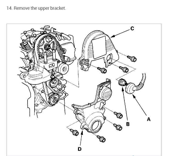

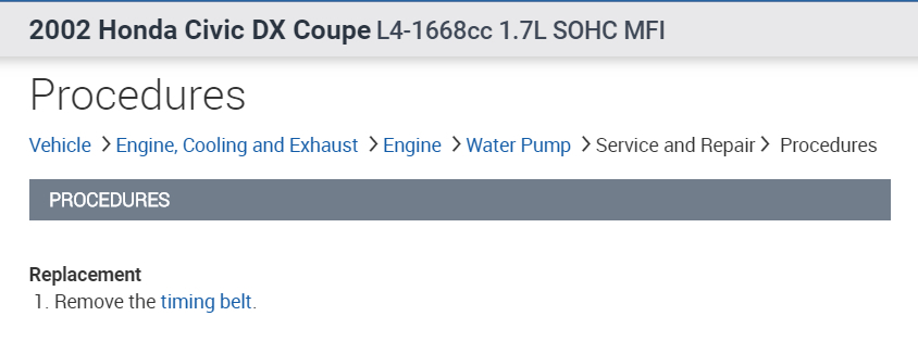

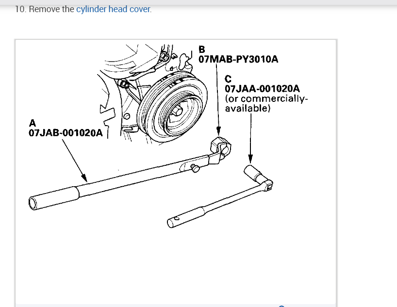

Okay, so your vehicle has a new radiator and thermostat and it is still overheating. This sounds like you could have a problem with your vehicle's water pump. In the diagrams down below I have included the step by step instructions from the vehicle manufacturer for the removal and installation of your vehicle's water pump. The timing belt has to be removed to get to the water pump and i highly recommend replacing it as well since you are there. Please go through this guide and get back to us with how everything turns out.
Thanks,
Alex
