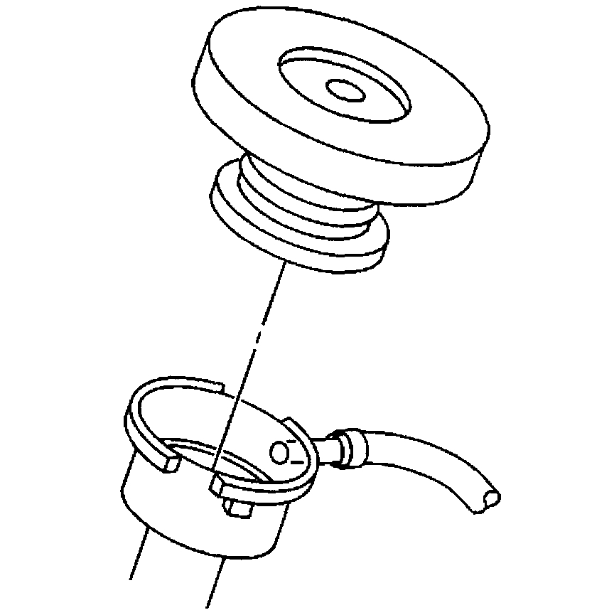

Changed the thermostat. Fluid coolant. Still overheating and no heat. No leaks.
Oct 18, 2020 at 9:56 AM
  • 110,244 POSTS
If you have no heat, it sounds like there is an air pocket preventing the coolant from circulating. On the thermostat housing, there should be a bleeder. Also, there should be one above the coolant pump. That is where you can allow air to escape from.
Note that the vehicle came with Dex-Cool coolant. That shouldn't be mixed with other types of coolant. If that has happened, let me know. The only way around it is to totally drain and flush the system / engine block as well, with water and then install something other.
Here are directions for a drain and fill. It explains how to bleed the air from the system when refilling. Take a look through it.

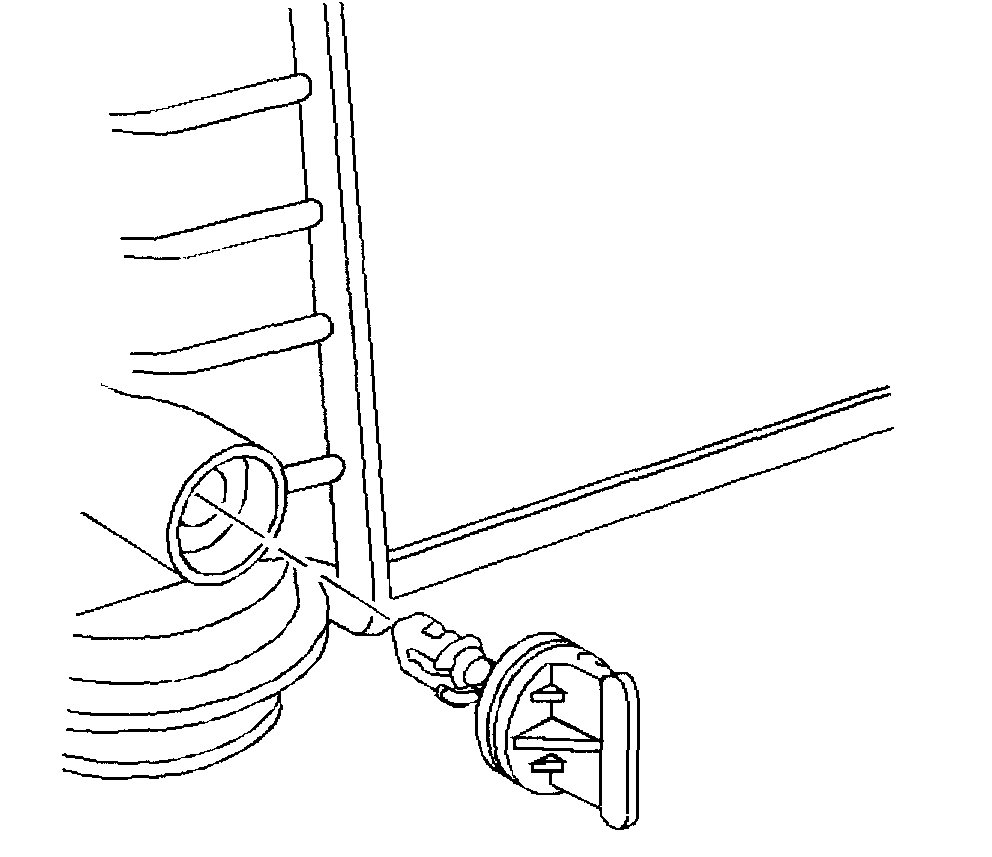

2. Remove and clean the coolant recovery reservoir.
Caution: To avoid being burned, do not remove the radiator cap or surge tank cap while the engine is hot. The cooling system will release scalding fluid and steam under pressure if radiator cap or surge tank cap is removed while the engine and radiator are still hot.
pic 1

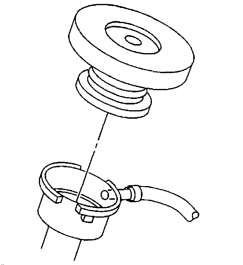

3. Remove the radiator cap when the engine is cool:
3.1. Slowly rotate the cap counterclockwise to the detention tab. Do not press down while rotating pressure cap.
3.2. Wait until any residual pressure, indicated by a hissing sound, is relieved.
3.3. After all hissing stops, press down on the radiator cap and rotate the cap counterclockwise in order to remove the cap.

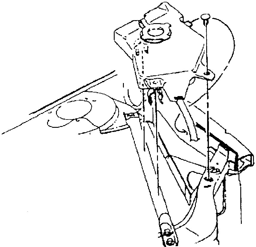

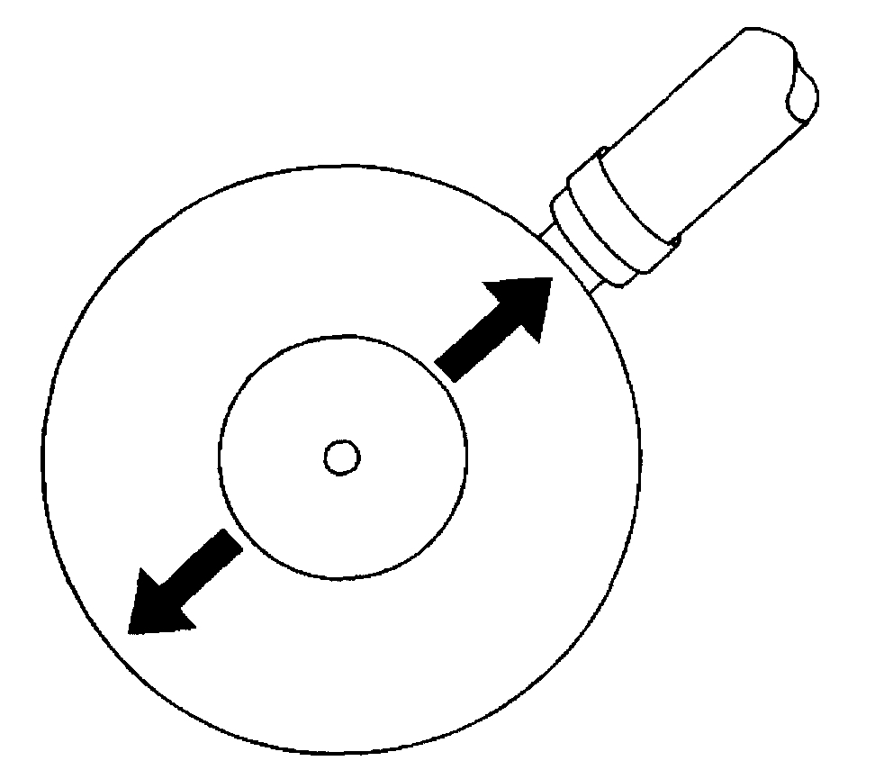

4. Place a drain pan under the radiator drain cock in order to collect all of the used coolant.
pic 2

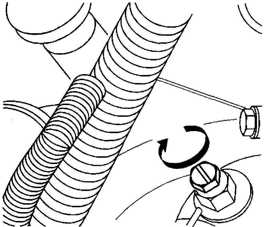

5. Open the radiator drain cock. If only partial cooling system draining is required, drain enough coolant to perform the procedure.
pic 3

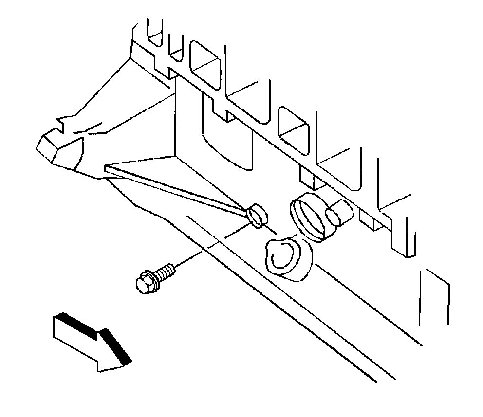

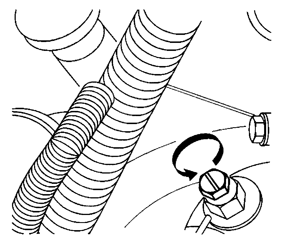

6. Open the air bleed valve on the thermostat housing 2 full turns.
pic 4
7. Open the air bleed valve above coolant pump 2 full turns.

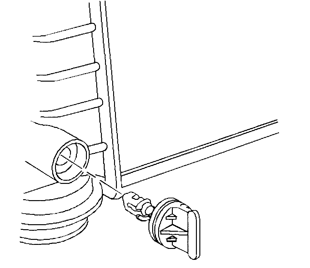

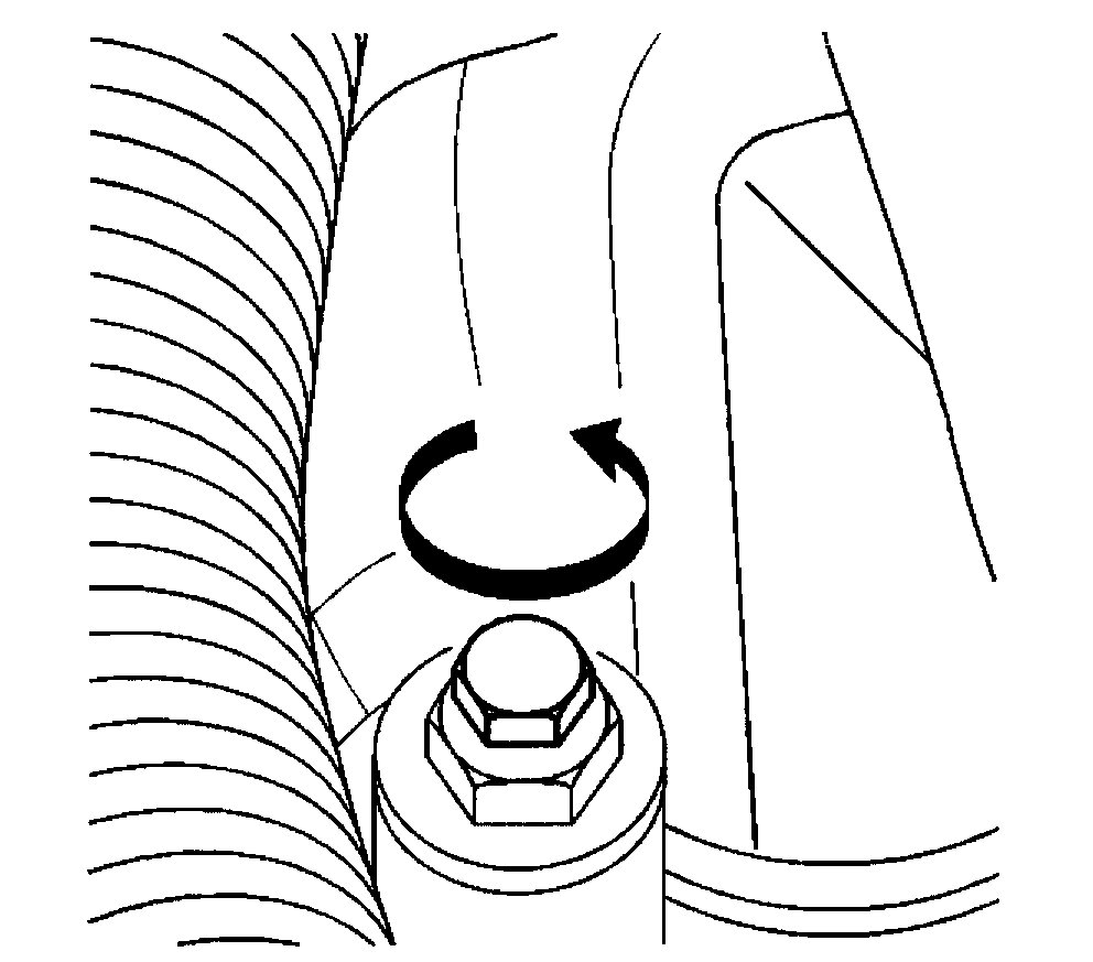

8. Place a drain pan under the engine block drains in order to collect the used coolant.
Important: Allow the coolant to drain completely.
pic 5
9. Remove both of the engine block drains.
^ The front left engine block drain is located between the starter motor and the engine oil filter.
^ The rear right engine block drain is located near the crankshaft position sensor.

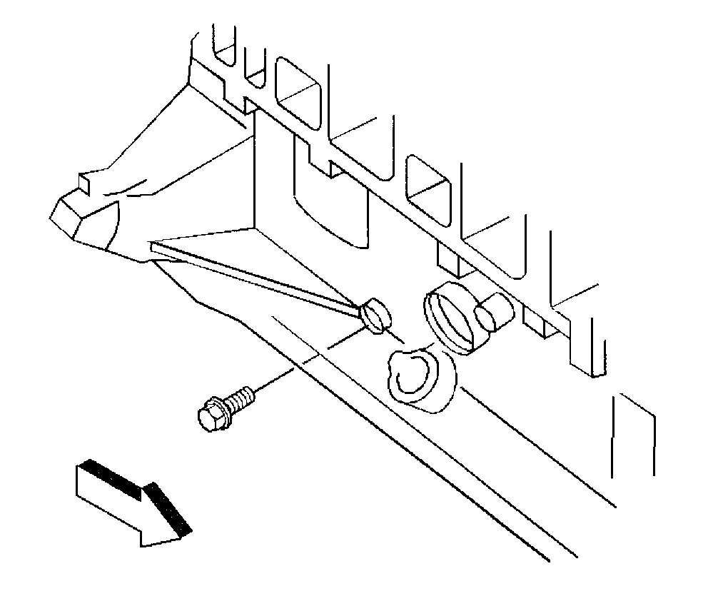

Filling Procedure
pic 6
1. Reinstall the engine block drains.
