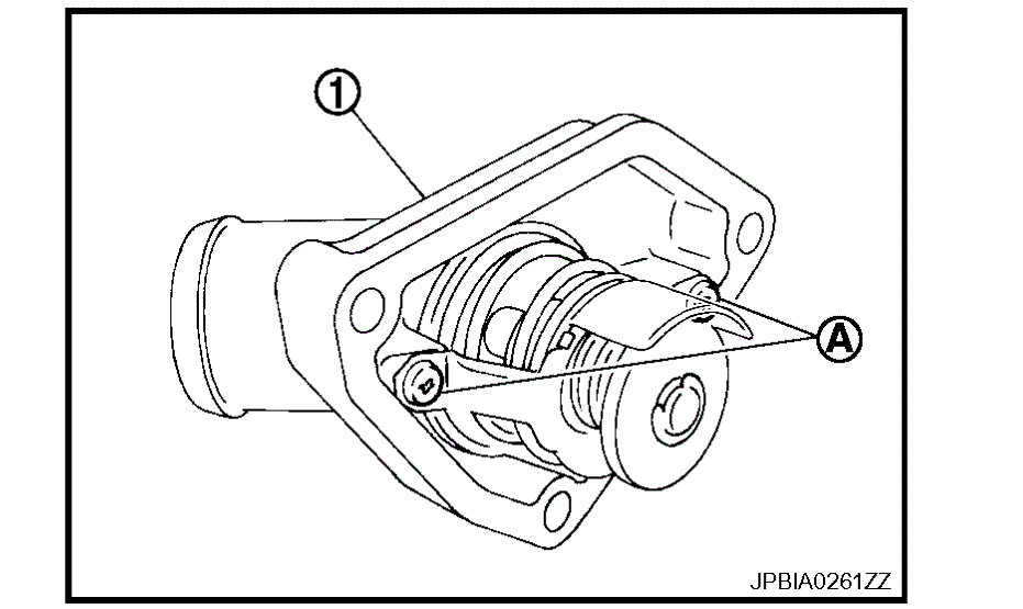

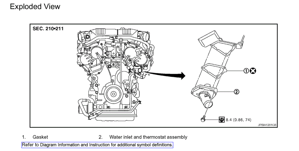

My car overheats after 5 minute of operating. if you open the radiator cap it has no water but the reservoir is full. When the car overheats you can see smoke and water marks behind the engine cap towards the passenger side. The leak does not seem to be coming from the radiator because the spill is not coming from the front. As soon as you add coolant, you'll see it on the ground automatically. The coolant seems to spill from under the throttle body, everything is so compacted together that is hard to see where the issue is.

I would also replace the cap. It sounds like it has a bad valve in the cap.
The thermostat is another thing you should change as well as it may be stuck closed causing the coolant to get too hot.
https://www.2carpros.com/articles/how-an-engine-thermostat-works
Removal and Installation
REMOVAL
1. Remove engine cover.
2. Remove air duct and air cleaner case assembly (LH).
3. Remove reservoir tank.
4. Remove oil cooler water pipe mounting bolt, and move aside water pipe.
5. Remove engine undercover with power tool.
6. Drain engine coolant from radiator drain plug at the bottom of radiator.
CAUTION:
Perform this step when the engine is cold.
Never spill engine coolant on drive belts.
7. Disconnect radiator hose (lower).

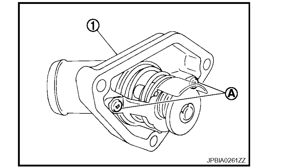

8. Disconnect intake valve timing control valve harness connector (LH), and remove intake valve timing control solenoid.
9. Remove water inlet and thermostat assembly (1).
CAUTION:
Never disassemble water inlet and thermostat assembly.
Replace them as a unit, if necessary.
A: Do not loosen these screw.
