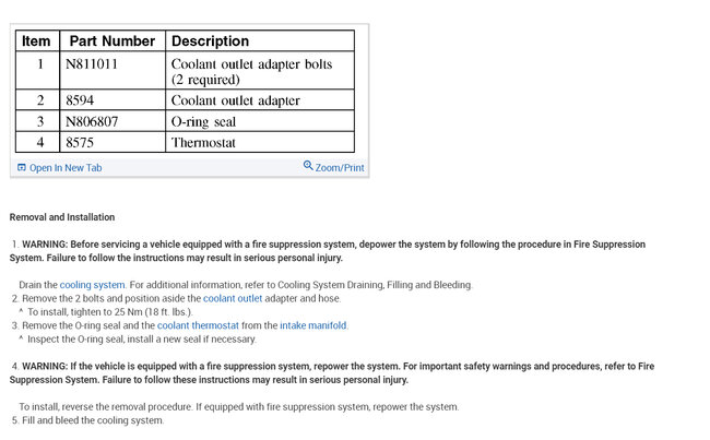

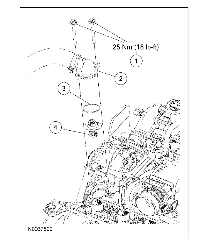

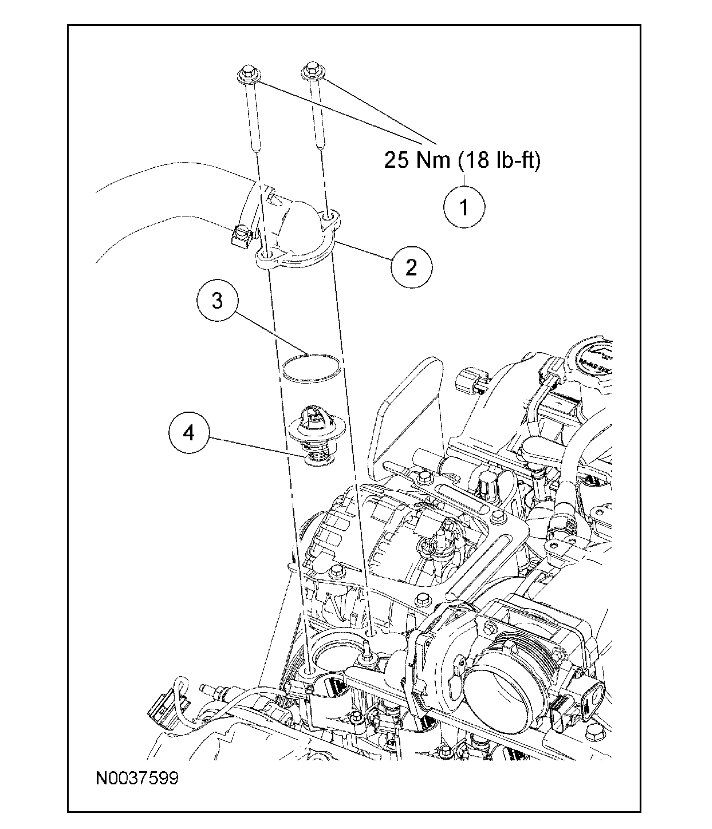

I had the thermostat replaced on it, the cooling system bled out, and oil changed on it. It still overheats going on the interstate. I don't know what is causing the at this point. I noticed it was bubbling and smoking on top of the engine when I opened the hood.
Jun 9, 2023 at 5:00 AM
  • 55,433 POSTS
It sounds like you have a defective thermostat, or it is installed backwards which will make the engine overheat. Here are two guides to help and I have included instructions on how to change the thermostat out:
and
https://www.2carpros.com/articles/engine-overheating-or-running-hot
Check out the images (below). Please let us know what you find.
