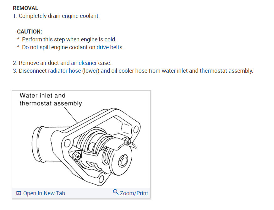

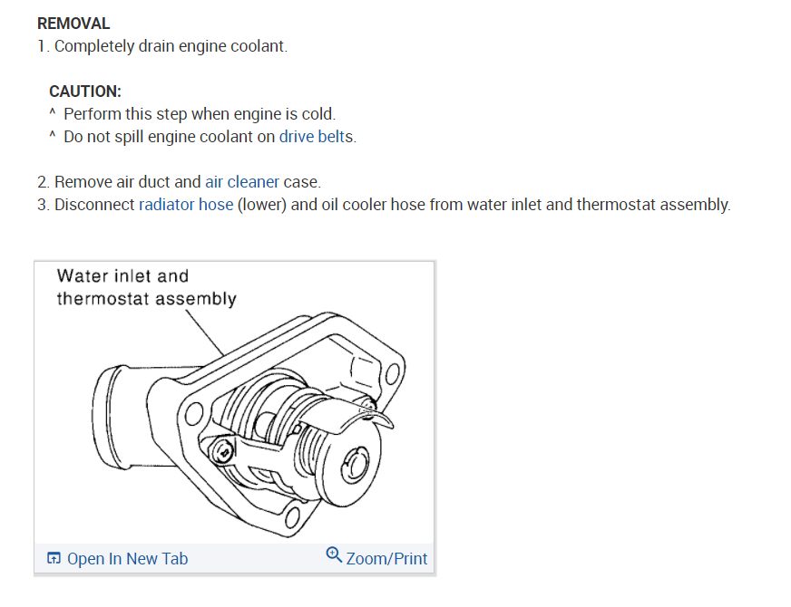

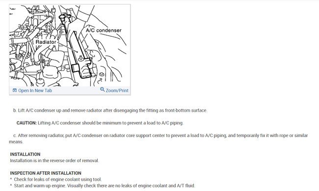

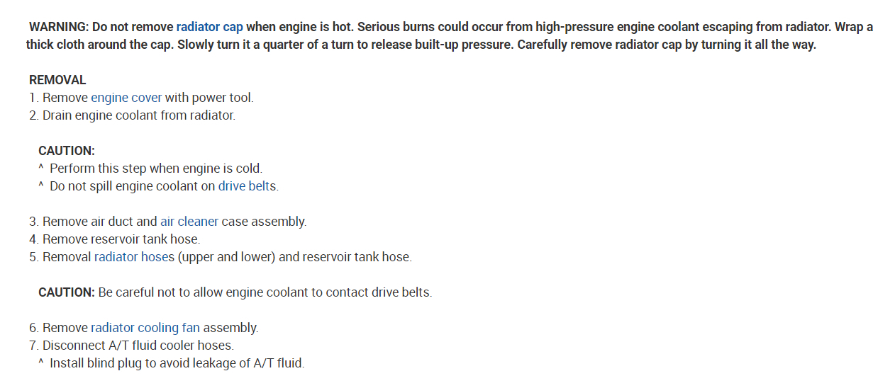

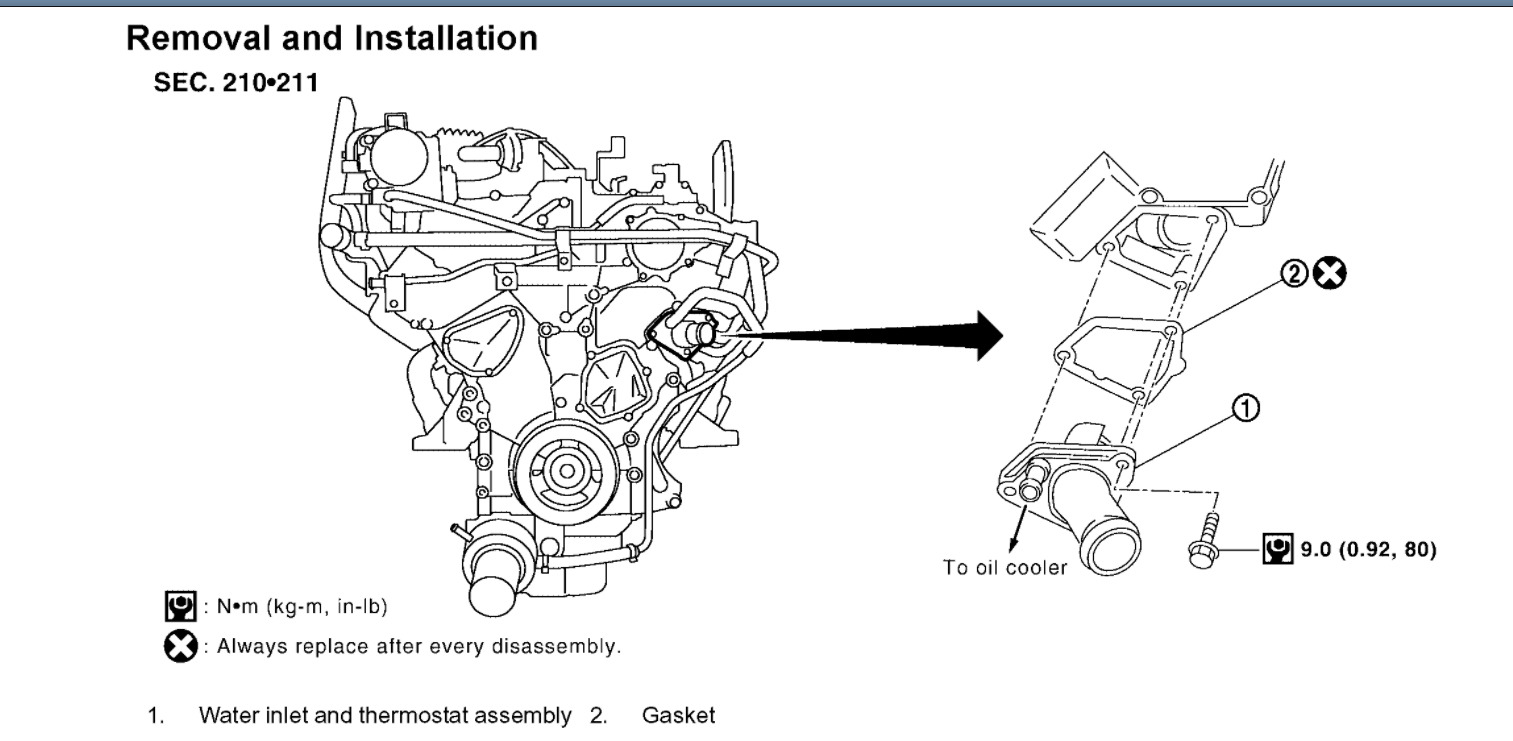

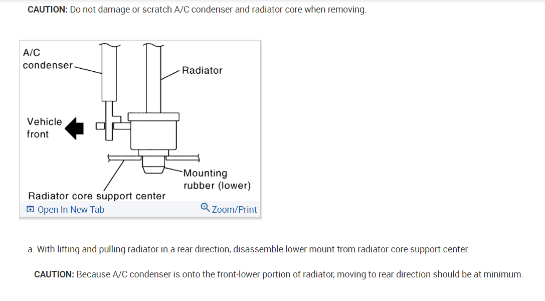

Did you change the thermostat? I would also do that as it may be stuck closed.

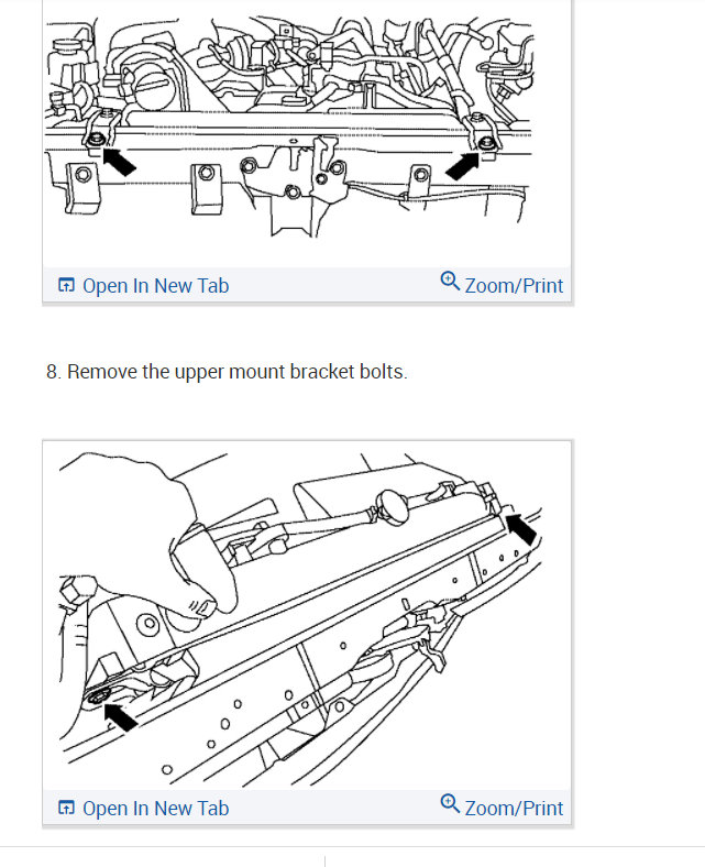

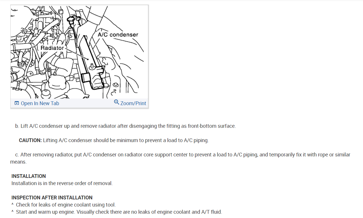

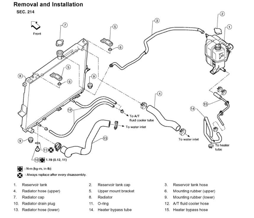

You adding all those additives has most likely clogged the radiator cores. That is about the only thing those additives do. You may have a clogged radiator as well.
https://www.2carpros.com/articles/how-to-replace-a-car-radiator

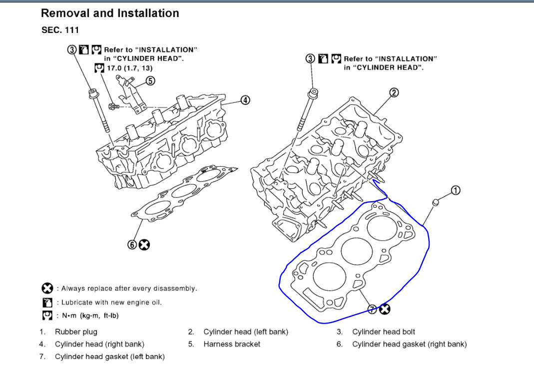

Lastly is a head gasket from constant overheating they may have failed. There is no additive made that will seal up the head gasket. The only correct repair is to replace the head gaskets.
