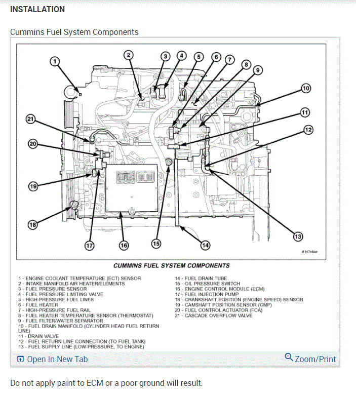

  • 110,240 POSTS
I noticed you haven't been contacted in a couple of days. I hope you guys don't mind if I jump in.

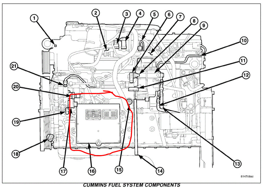

First, I noticed you indicated using the DMM at that alternator. That is why you are seeing 18V. This vehicle's voltage is regulated by the ECM, which is after where you checked. You need to check it at the battery.

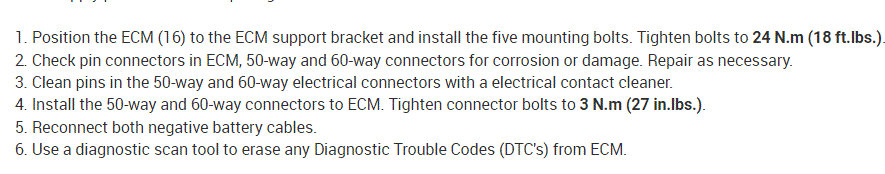

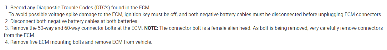

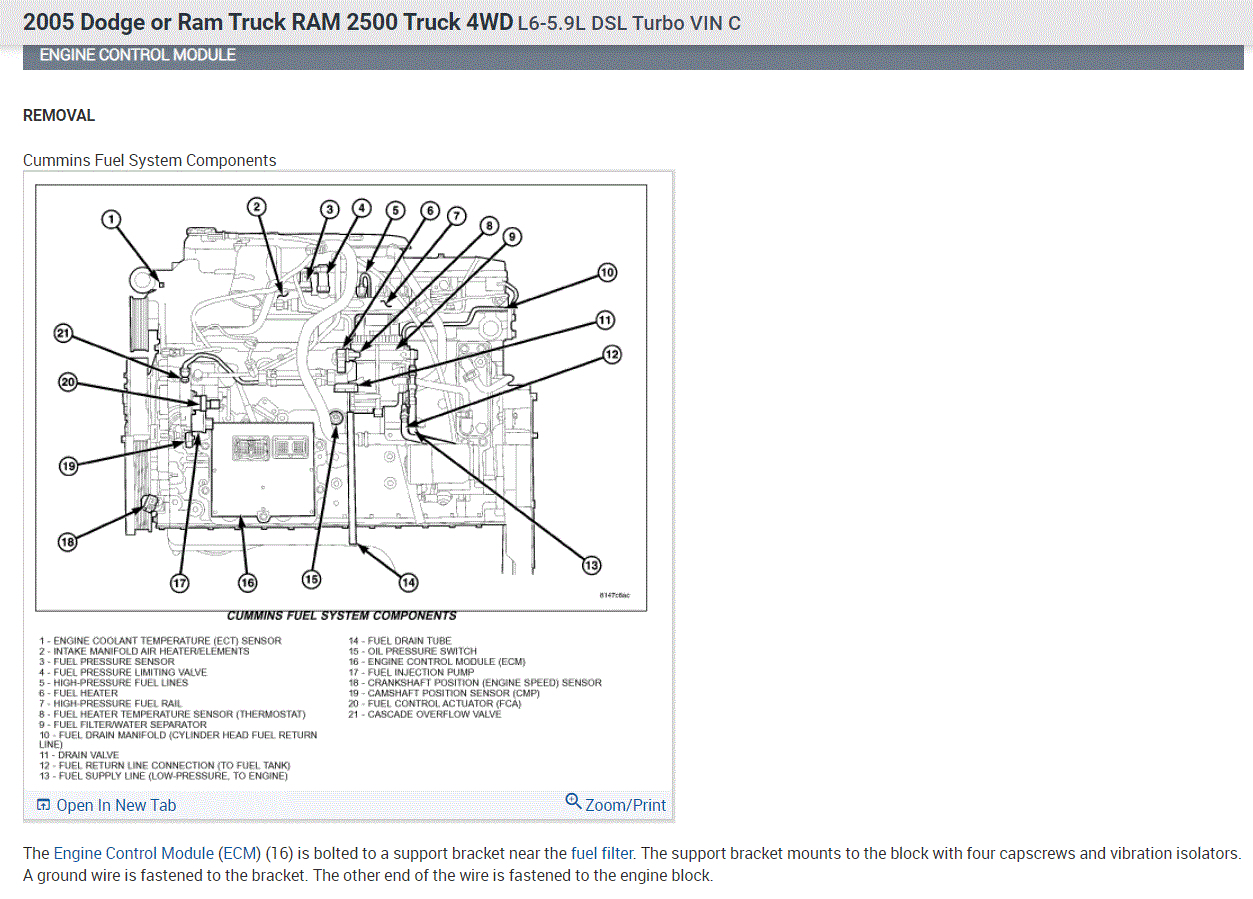

The Electronic Voltage Regulator (EVR) is not a separate component. It is actually a voltage regulating circuit located within the ECM for diesel engines. The EVR is not serviced separately. If replacement is necessary, the ECM must be replaced. See pic 1 below for location. It's near the fuel filter.
The remaining pics include the directions and pics for replacement. I'm adding them in the event the ECM is bad. However, you really need to check at the battery for voltage. Checking at the alternator is bypassing the ECM.
I hope this helps. Let us know if you have additional questions. Also, we would appreciate it if you could let us know what you find. We're interested in knowing.
