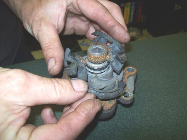

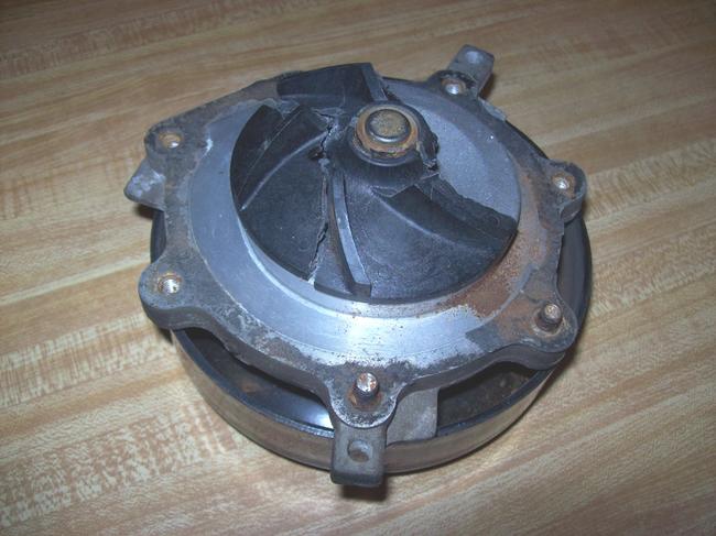

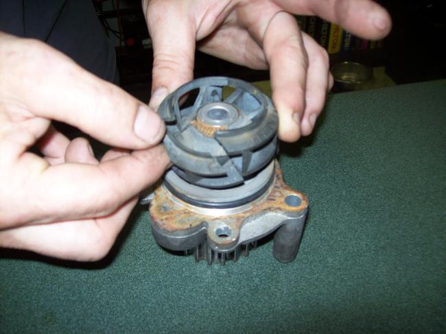

Replaced radiator, heater core, main fan, sensors on left side of motor cant find the one on the right that sends the signal 4 main fan. Car is still over heating also changed thermostats 3 times seems like if thermo is not opening car is over heating and blowing cold air inside

Have you tried checking if there is an air block in the system? Also, which fan isn't working? Does the car overheat if you are driving at highway speeds? Are you sure the water pump is good? Do any of the heater or radiator hoses get hot?

GOTCHA A FEW PICS OF SOME WATER PUMPS W/ PLASTIC IMPELLERS
THE MEDIC
