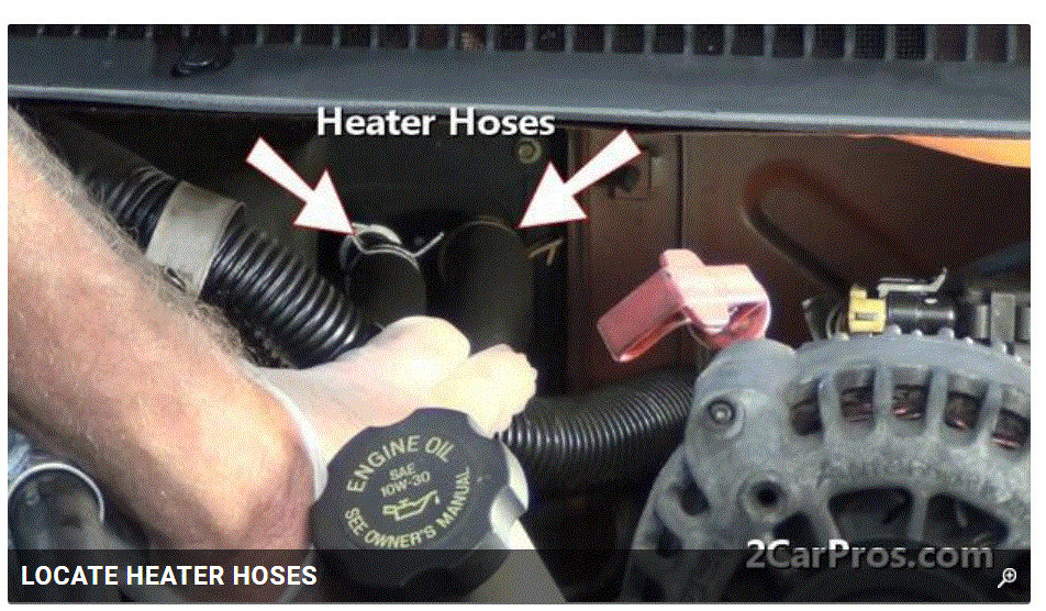

Also, I want you to try something. When the engine is cold, remove or loosen one of the heater hoses at the firewall. See if there is coolant coming from the hose. If there is none, have a helper start the engine while you watch to see if there is circulation. If there is none, tighten that hose and remove the other, and do the same thing. One is a supply and one is a return, so you may not see a lot from the return if the supply is plugged.
If you do have flow, with the return hose lose, see if you can bleed air from it. If there is no flow through the heater core, try flushing it to see if that helps. Basically, remove the return hose from the core and the supply line. Then using a garden hose, see if you can get water to flow through the heater core.
Let me know. I attached a general pic below showing what to look for as far as the heater hoses.

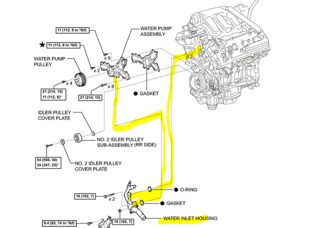

Absolutely there should have been coolant. We found the problem. Now we have to find the cause. If you disconnect the return line and start the engine, does coolant come out of it?
Also, when the pump was replaced, was the water inlet housing correctly installed? That distributes coolant as well. It sounds like something is blocking it. See pic 1 for what I'm referring to.

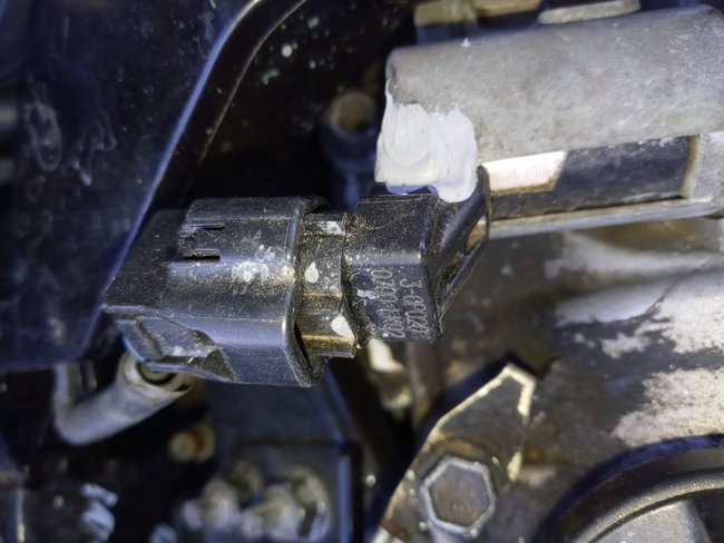

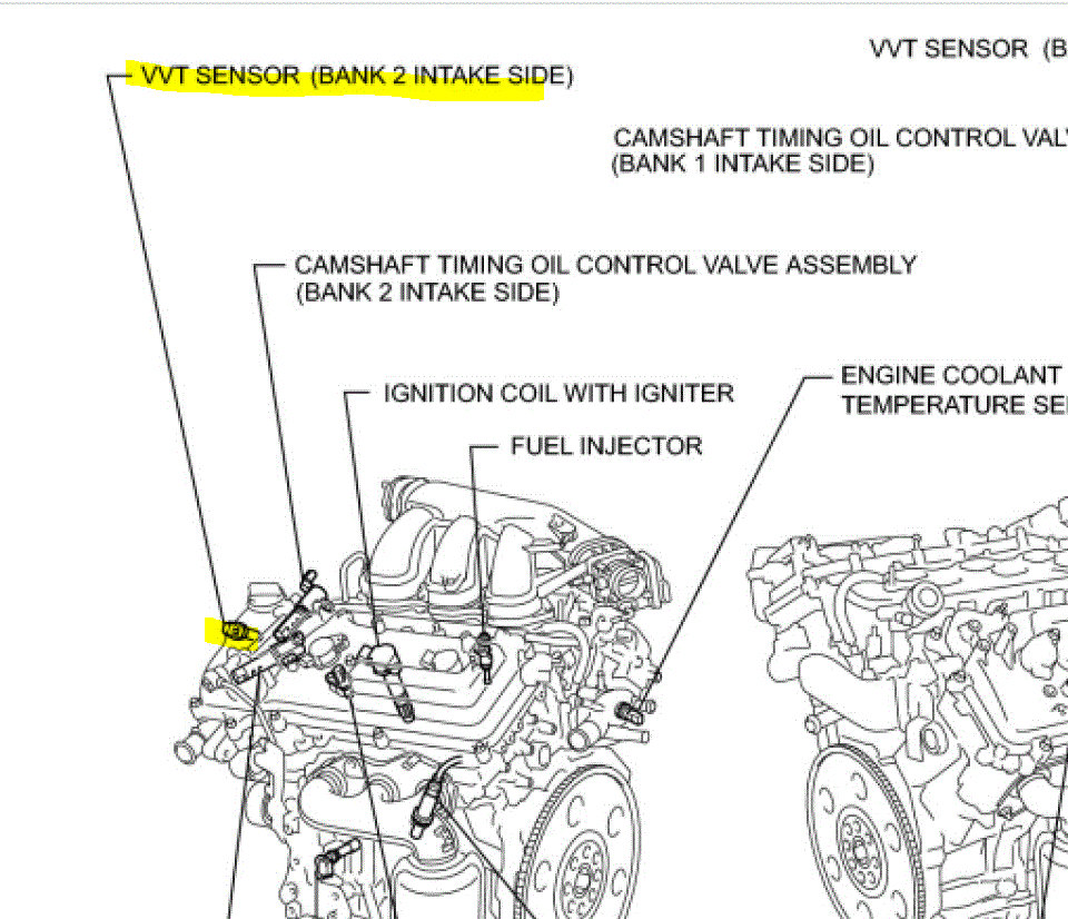

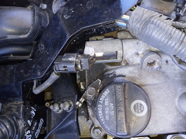

Joe, i am going to send two pics of a part that got broken when the water pump was getting replaced. 1, is the part blown up the other is so you can see where it's located. I don't know what this is but as you can tell i did a little repair do you know what it is? Thanks, pk
Dec 20, 2020 at 2:52 PM
  • 110,194 POSTS
That is a VVT sensor (variable valve timing). IF it isn't working, it would set a check engine light. (see pic 1)
