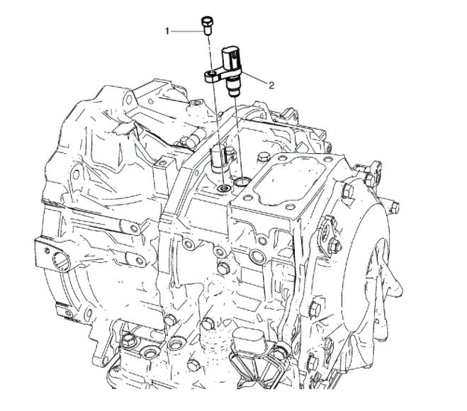

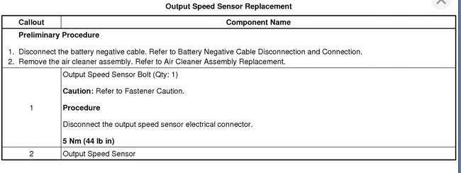

Hey, my car will go into limp mode occasionally, and the code that causes it is P0722 which points to the output speed sensor. However, I cannot seem to find anywhere online information on how to access this sensor. I've seen some vehicles replace this part by accessing the the sensor under the hood, but some vehicles have it under the car inside of the transmission. Where is the location of the sensor on this vehicle, and how do I access it? Any info helps thanks!

Good evening,
The sensor is right on top of the transmission. I attached a picture and the procedure for you.
Please let me know how it works out.

Circuit/System Description
The output speed sensor (OSS) is installed in the transmission case. The OSS detects the revolution speed of the counter drive gear (4) as the output shaft speed. These signals are transmitted to the TCM. Based on those signals, the TCM controls engine torque, shift timing, and lock-up.

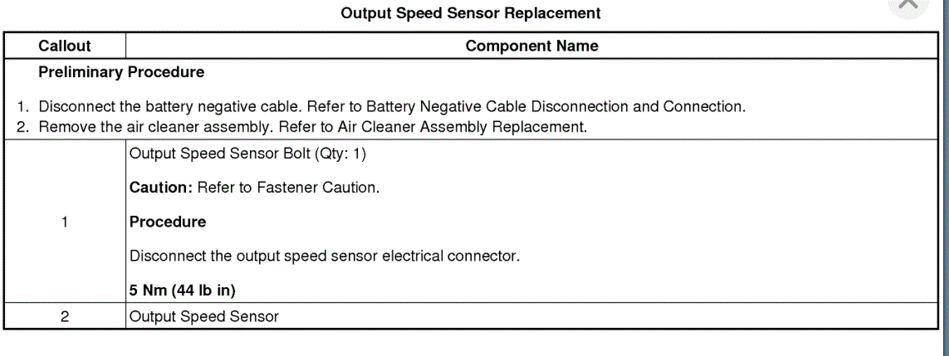

Repair Instructions
Perform the Diagnostic Repair Verification See: A L L Diagnostic Trouble Codes ( DTC ) > Verification Tests > Diagnostic Repair Verification after completing the diagnostic procedure.
Output Speed Sensor Replacement See: Transmission Speed Sensor, A/T > Removal and Replacement > Output Speed Sensor Replacement
