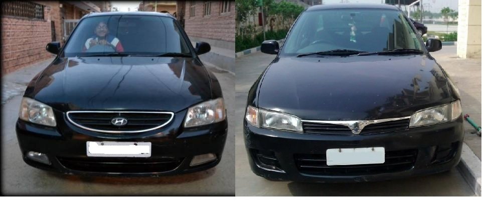

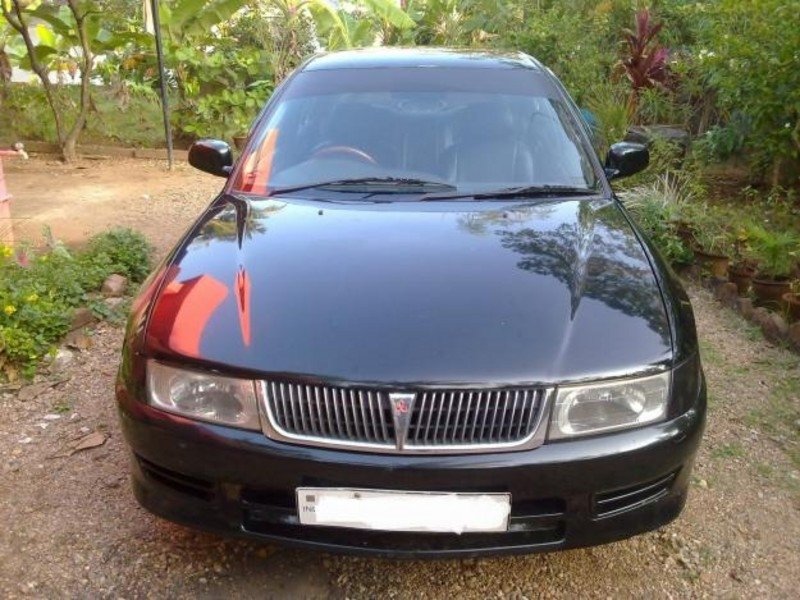

RAHULTANEJA7
  • 6 POSTS
Thanks. How and from where i can get the legal knowledge about this for Delhi (India)? Could please refer me any online link or i need to visit Authority or any Govt office?
Just want you to see the pictures (in attachment) of both the cars having similarities in shapes.
Sep 19, 2017 at 5:47 AM
STEVE W.
  • 15,202 POSTS
Shape does not really matter when nothing interchanges.
Not being in India, I do not know who writes and enforces your vehicle laws. Plus the law could be written very vague like; "No motor vehicle over fifteen years old may be operated on the highway".
With nothing to tell you specifics.
Sep 19, 2017 at 11:38 AM
