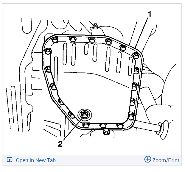

Ihave opel corsa 2002 model 1.4 litter engine.When i drive the gear not shifting proprly.some time ok,some time engine RPM moveing high but car is not moving 1st to 2nd gear so i scaned my car the code is P1890.and P1895.this code I dont have any defination,Please any budy tell me what is the meaning of P1890and P1895.

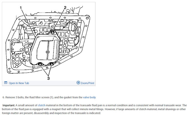

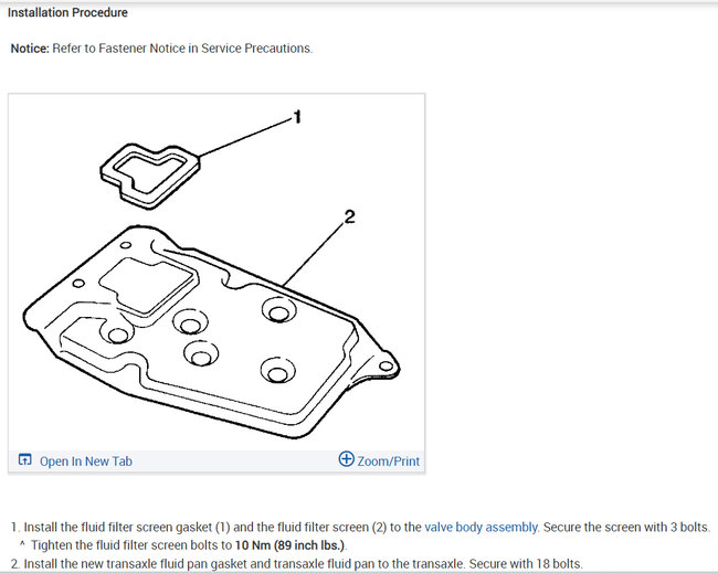

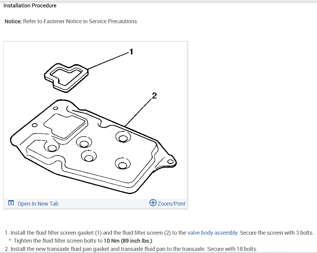

Good help there! Lets try this instead,
P1890 - Transmission Component Slipping
P1895 - Transmission Torque Reduction Signal Malfunction

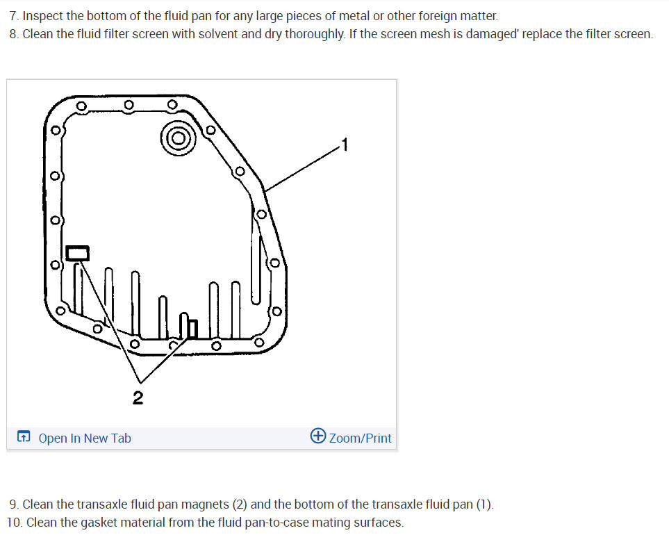

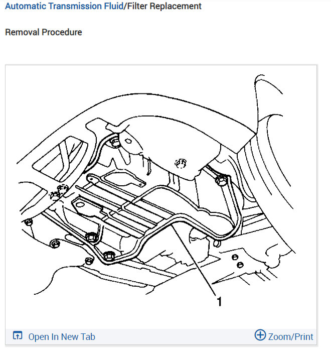

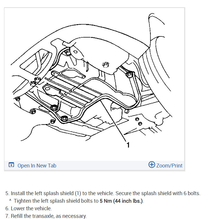

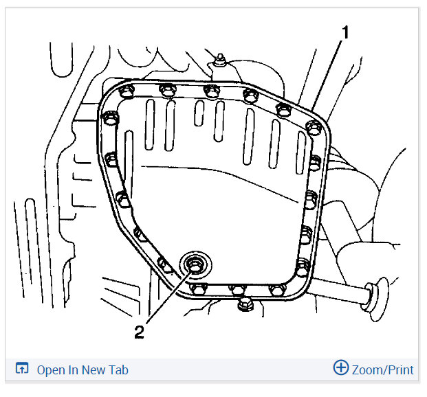

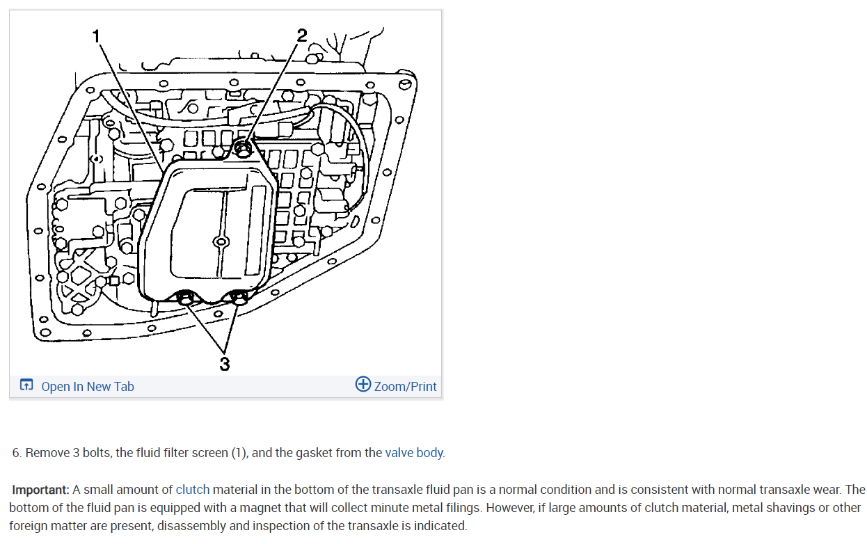

So, I would start by servicing the transmission and then clear the codes. Please go over this guide to help you:
Fluid Types
Transmission Fluid Type
Type .................... DEXRON III or Equivalent
Capacities
Transmission Fluid
3 speed .................... 2.4L (2.6 Qt)
4 speed .................... 3.1L (3.3 Qt)
