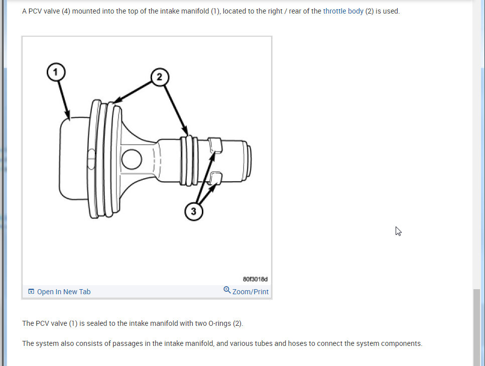

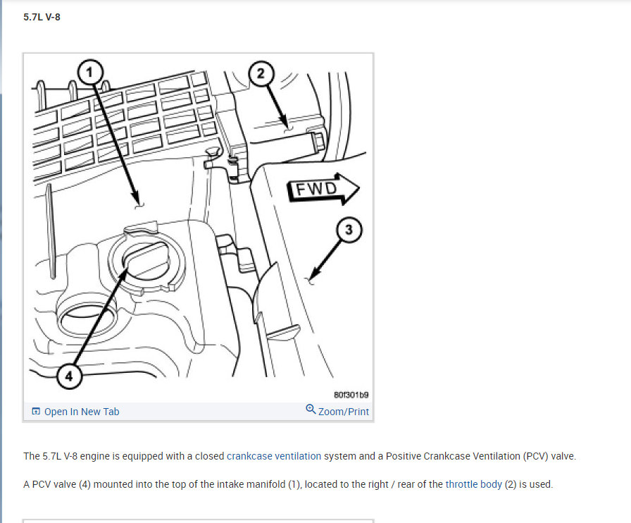

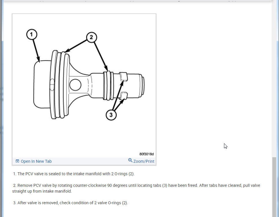

More then likely the PCV valve is clogged so we need to start with replacing this.
Here is a guide that helps with this issue if this is not it but the fact that the oil cap being removed makes a difference makes me pretty confident that this is the issue:
Below are the instructions that will show where this is and how to replace it.
Let me know what you find after this and we can go from there. Thanks
