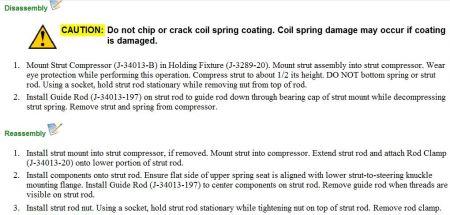

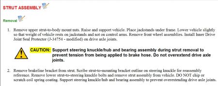

Hello and thanks for donating Below are the proper replacement steps, let me know if you need further assistance with this repair. .
https://images.2carpros.com/forum/automotive_pictures/261618_Noname_2635.jpg
https://images.2carpros.com/forum/automotive_pictures/261618_Noname2_860.jpg
https://images.2carpros.com/forum/automotive_pictures/261618_Noname3_312.jpg

Your answer was for the wrong strut. I am replacing my head gasket and I am having trouble removing the bracket on the engine, passenager side, that supports the engine to the frame. I have un-bolted the AC compressor and removed the two other bolts, but it will not come off. Do I have to just force it off, or are there other bolts that i missed?
