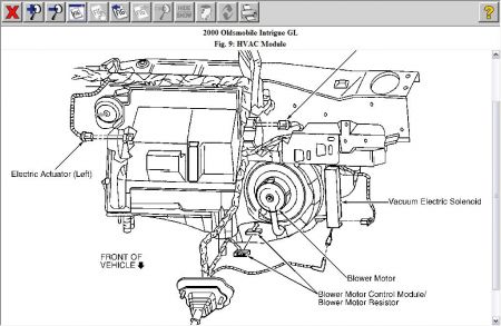

I have a 2000 Oldsmoble Intrique with 195,000 Kms
My fan blower motor has 5 speeds but only works on the highest setting. I checked the low and high blower fuses - Ok> I, m wondering if it could be my blower motor resister and if so where is it located and what does it look like. Thanks for any help.
Thursday, November 22nd, 2007 AT 6:15 PM
  • 75,992 POSTS
See below
http://www.2carpros.com/forum/automotive_pictures/12900_blower_resistor_3.jpg
