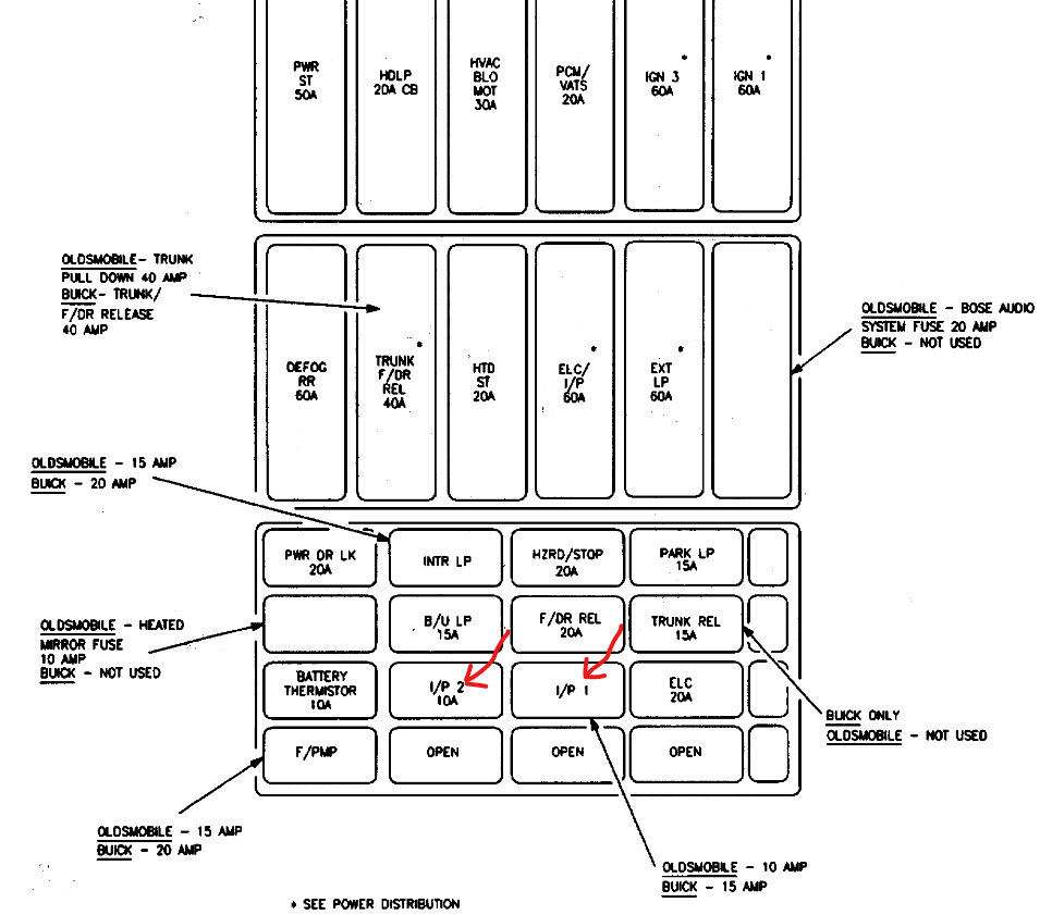

I would start by checking the fuse here is a guide and the IP fuse in the fuse panel inside the car. This guide can help:
Here is a video to help as well:
https://youtu.be/6Tlg3JmgNSQ?si=76AsHgwS95HqS0is
Here is the fuse location to check as well. Check out the images (below). Please let us know what happens.
