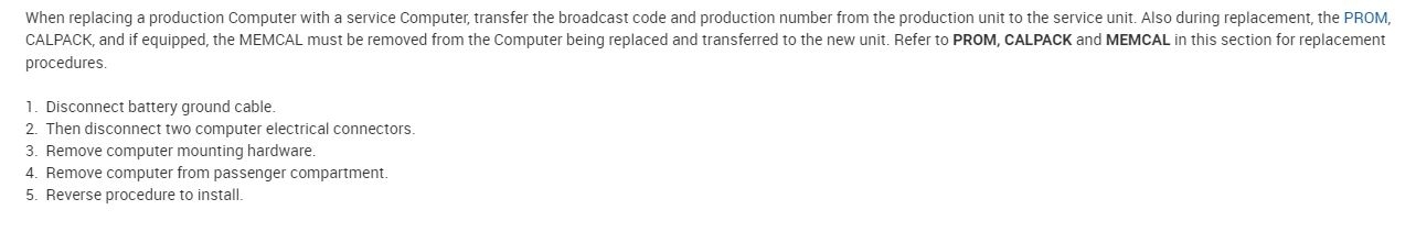

Good morning,
The quad drivers are internal in the ECM. When you have this code, the ECM is a failure and must be replaced.
Can I have the vehicle information and I will get the procedure for replacing the ECM?
Jan 16, 2022 at 12:19 AM
OLDSMOBILEGUY123
1990 Oldsmobile Delta 88 royal Brougham. V6 3800 with the 440-T4 transmission I'm pretty sure.
Jan 16, 2022 at 2:12 AM
The code is for the ECM quad driver failures.
I attached the procedure below for you for the replacement of the ECM. You can get one at rock auto. Just match up the numbers on the unit. They must match exactly.
